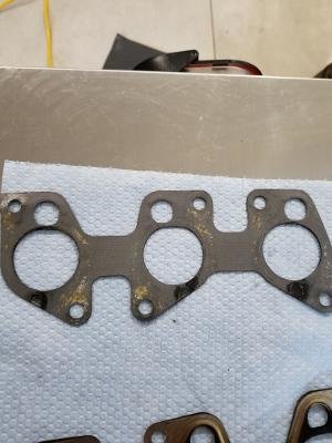

    I took the "new" gasket off and noticed soot on the bottom of the exhaust ports! Reused (yes I know!) the original metal gasket with some Permatex, I'll start her up tomorrow and hope for no leaks :fingerscrossed:

    Passenger?

    if you still have emissions stuff on it could be that. i had it. from header install an emission cross pipe gasket fell out of place when finishing. learned it after a bit of head scratching.

    After a 24hr cure check on the Permatex, the truck is operating normal! No more loud, obnoxious, "motorcycle" sound.
