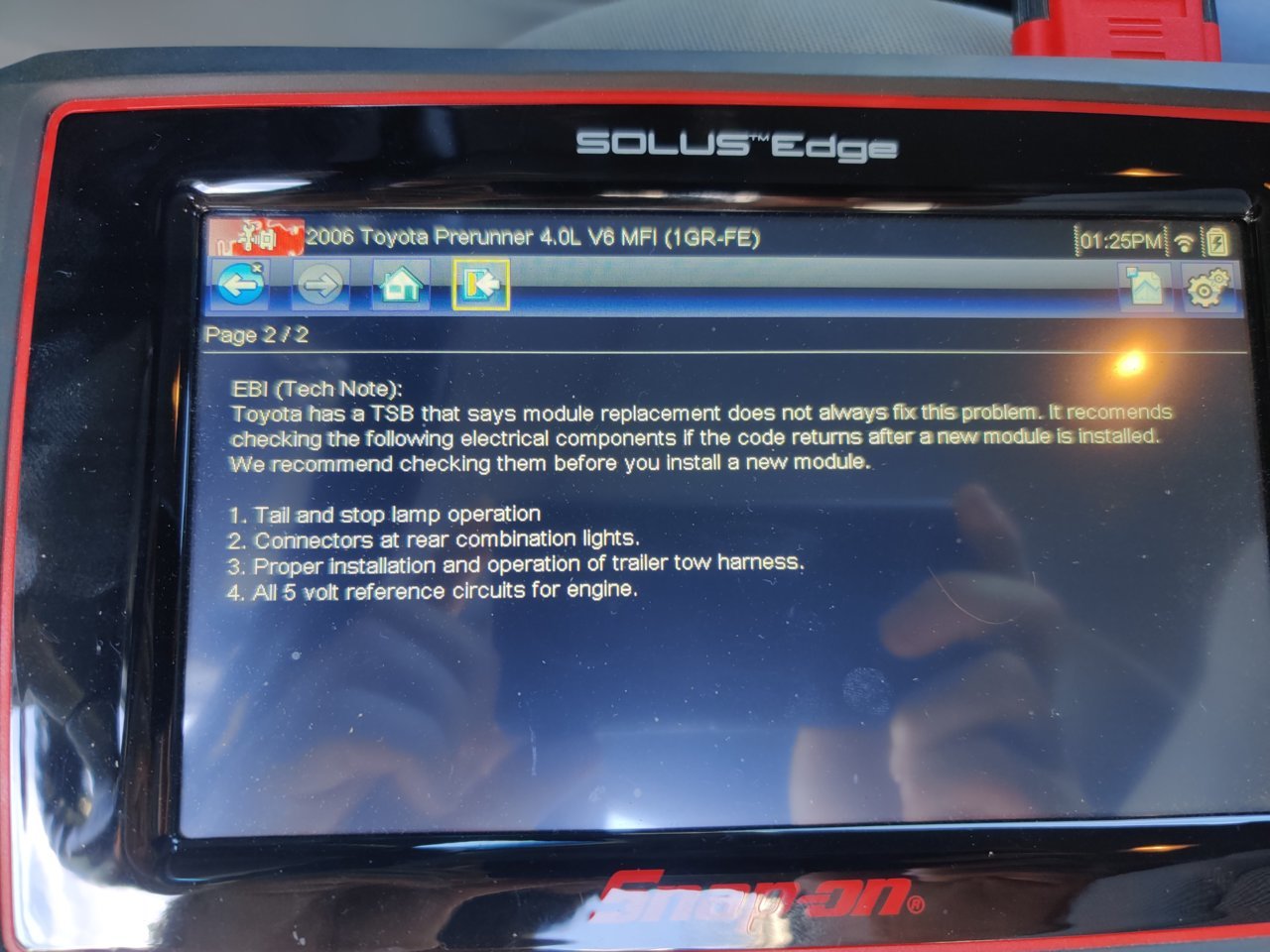

    Bad news boys. I dropped my truck off for an alignment at the dealer. They call me and ask if I know the check engine light was on. The fault is a p0606 PCM processor fault. Anyone came across this? I have not dug into it any deeper yet.

    Was check engine light on before you brought it in? Is yours tuned?

    Was not on when I took it in. Hptune by justdsm

    I might have a spare ecm for you if it comes to that

    Manual trans?
    Used a scanner I found this info related to the fault code.

    Auto trans, but looking that over- you might better check tail light and brake function

    Yeah, thought that was strange for it to be a cause.

    what did those clowns do to your truck? surprise pcm update?

    hope its a simple fix. i would be amazed if a lighting hiccup could geek the computer.

    never know. they could have techs that assume the vehicle is pcm stock like millions on the road.
