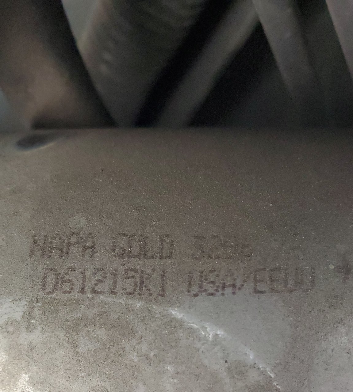

    Looks like a Gen2.5 TRD Sport, but really an '08 TRD OffRoad
    TRD Supercharged / OTT Tuned
    @White lightning boosted
    Napa Gold 3296. Came with the URD Walbro setup.
