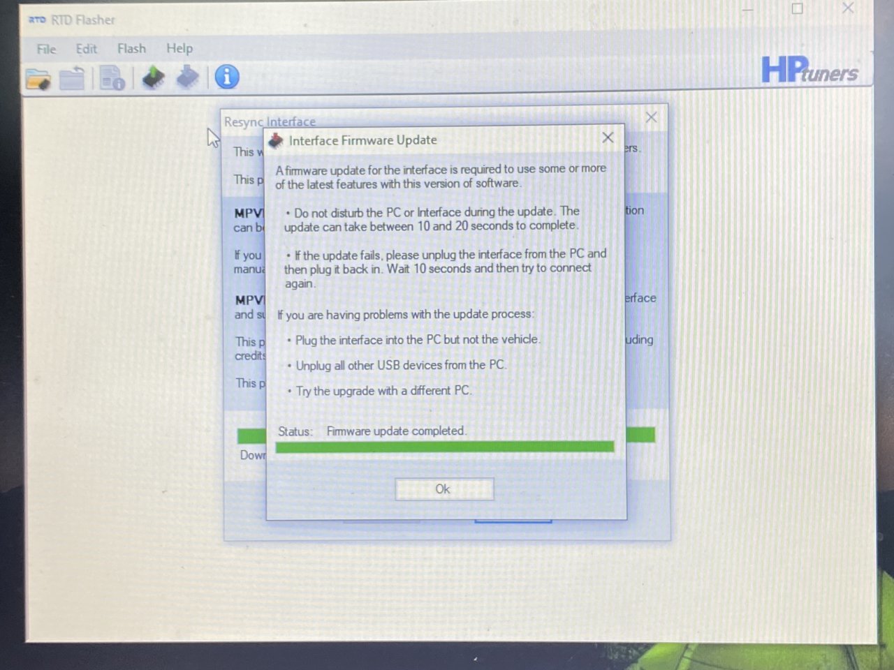

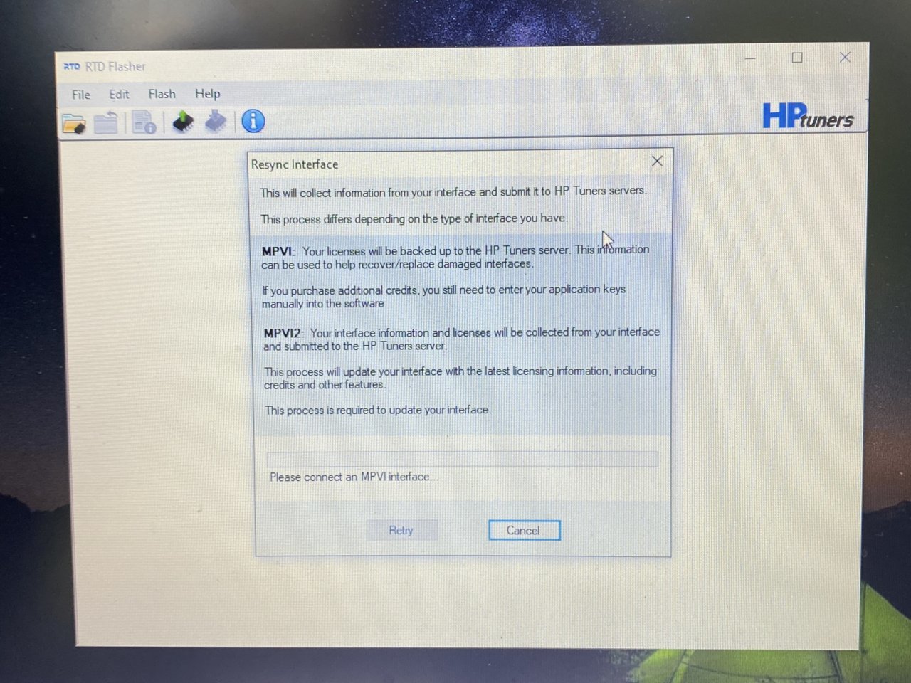

    Who is familiar with HP Tuner software? The instructions say to Resync the RTD tool to update the drivers prior to use, but when doing so I don’t get the dialog shown and it says to connect the MPVI interface. Everything is connected. I’ve rebooted. Tried proceeding anyway and won’t work without this step. What am I missing?

    F-ing Windows. Fixed it. Had to manually find and install the drivers myself.
