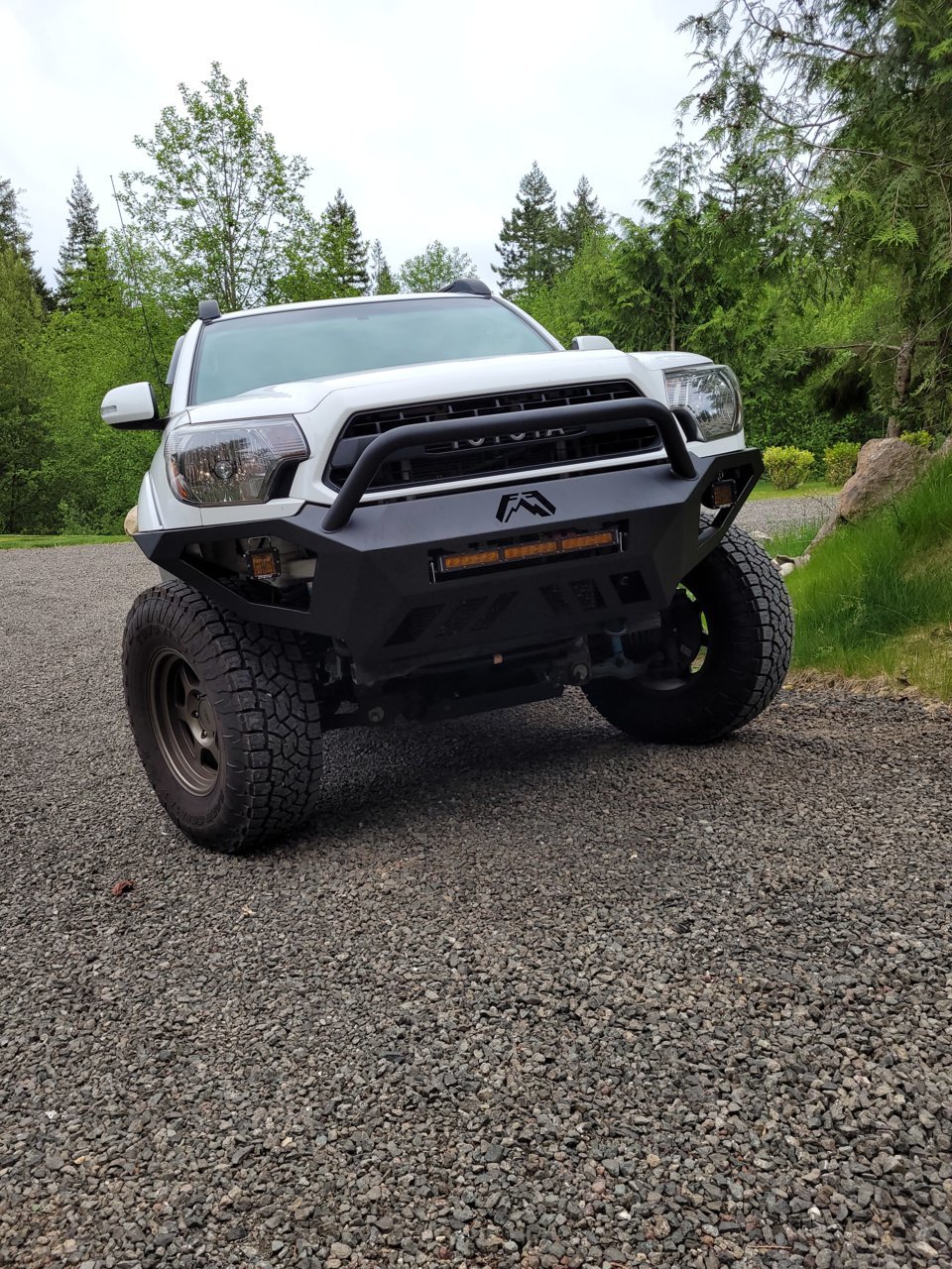

    been spending my effort in other ways. my neighbor got me cost plus 5% on a new deer sweeper.20210517_164300.jpg
