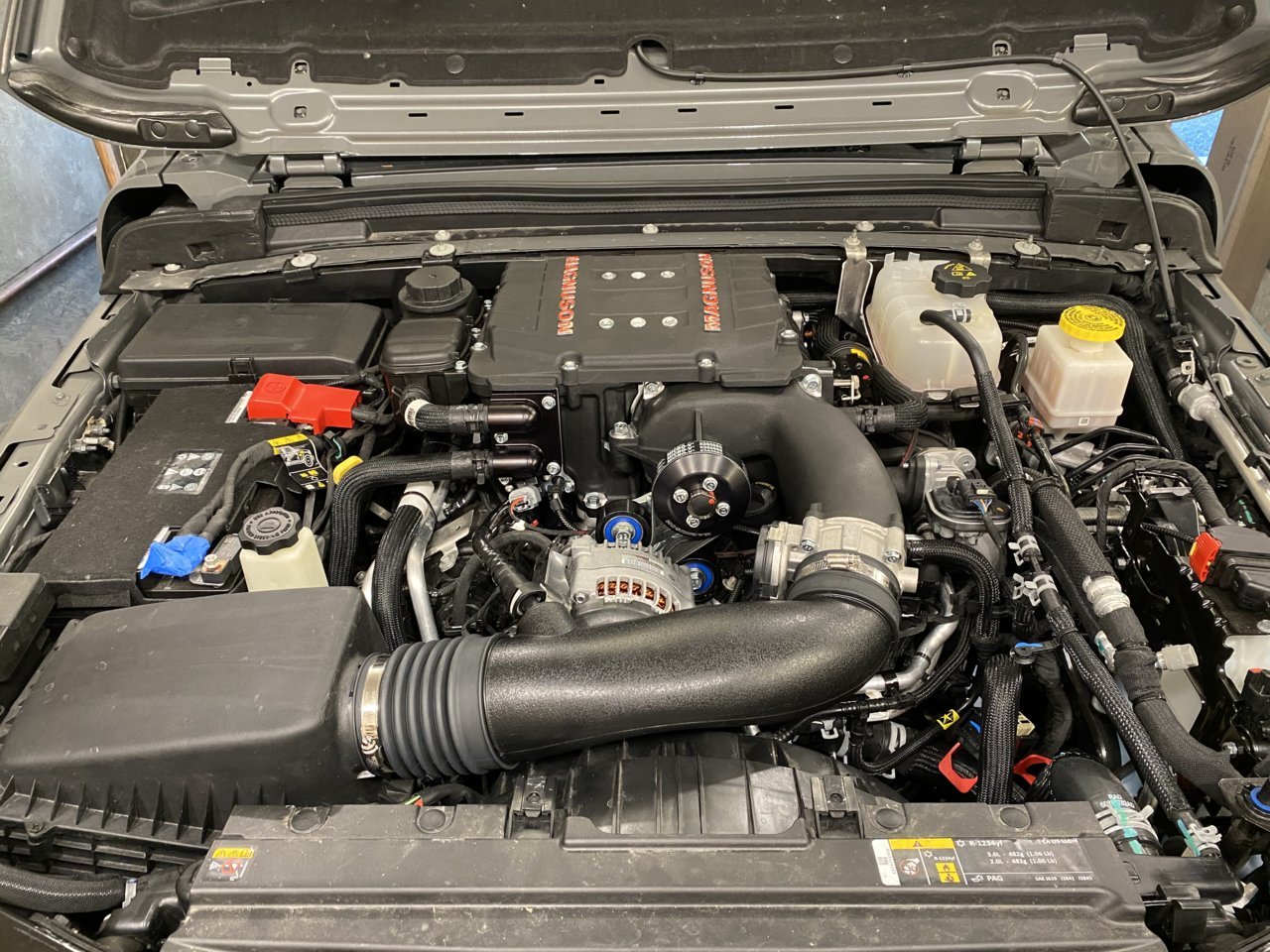

    Not a Taco, but I finished my JT Magnuson install. Just waiting to get my ECU back to fire it up.

    I’m no Jeep hater or anything but that has got to be one of the least attractive engine bays I’ve ever seen

    Dude, not hating either, but I was gonna say how cramped that bay looks!
    Positive note, congrats on the SC!!

    The JL/JT does have a very cramped bay, mainly due to the Wranglers external body design, but there is lots of very well thought out stuff in there. Belt changes are actually much easier than the 4.0 Tacos, you do have to remove the intake tube and alternator but that is very easy to access with 4 bolts right in the front of the alternator. With an electric fan and the alternator out of the way you have crazy room and plenty of front engine access. The blower runs on the main serpentine so there isn't a secondary belt, where you need to shred your hand/arm into the shroud to access. Belt changes are a super easy job to do solo, which isn't the case with the 4.0 Taco. The OEM 270A alternator (vs Tacos 135A) is high mounted for water/mud crossings, the intake has an internal snorkel to draw air from the max height possible for water fording, the factory aux fuse block also has dedicated in cab aux switches, OEM AGM battery with a dual battery setup, extended breathers for everything for water fording. Ect. It is busy, and the blower certainly made it moreso, but there is a bunch of features packed in there too.

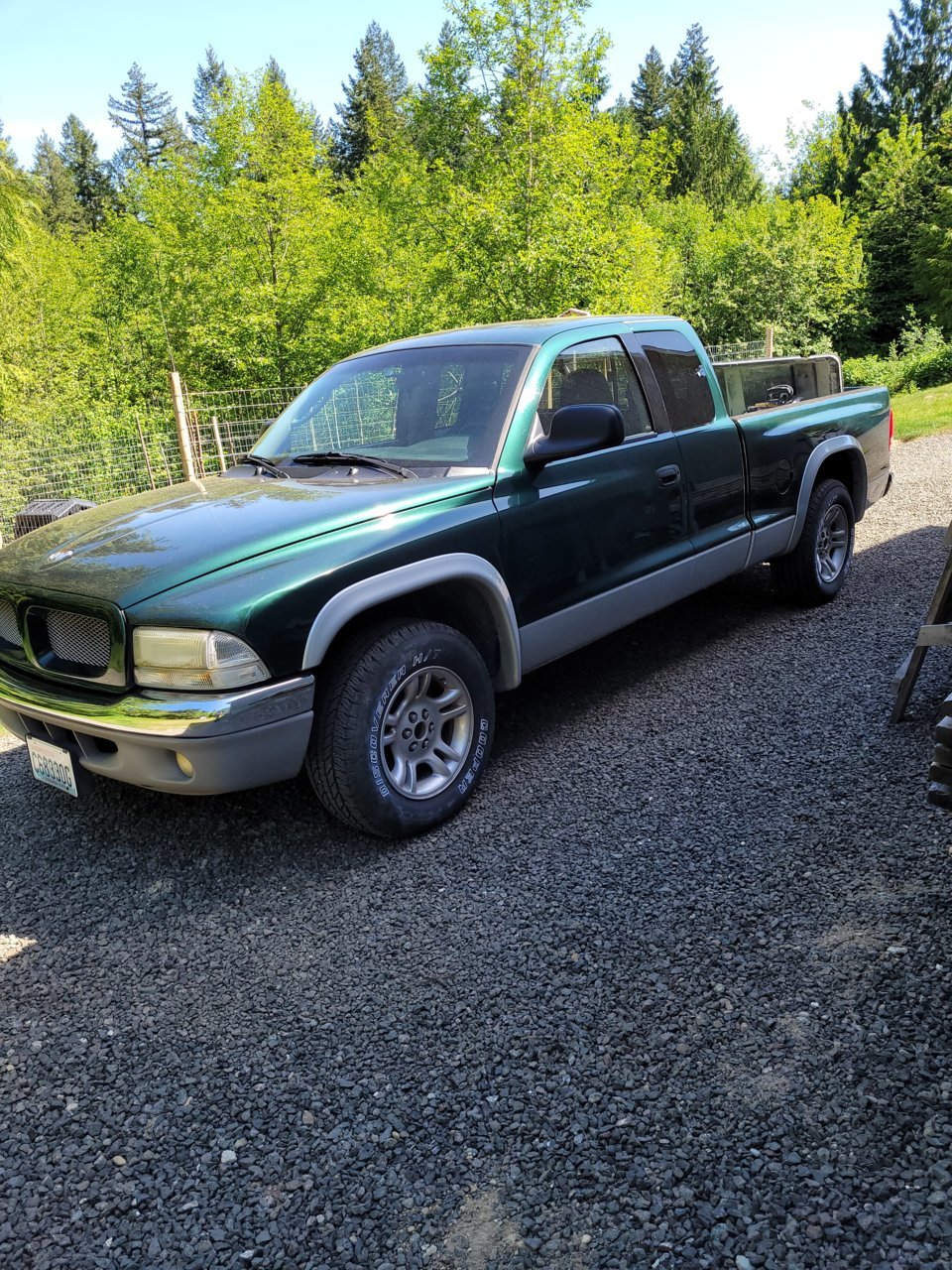

    20210515_144839.jpg perspective- my truck isn't fast. but for a tacoma it can hang. got my old truck back i bought new 20 years ago. V8 dakota. great for a dd. used to think it was badass. just drove the tacoma in 2 weeks.
    new appreciation for it. it could outrun that V8 with 2 flat tires.

    That ain't perspective brother, that's more power. :laugh:
