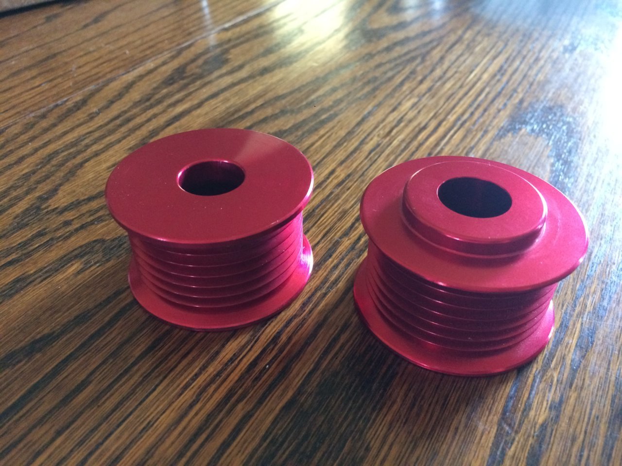

    hold on to your old hose clamps. 3 of the 4 they sent me a few weeks ago were too small.

    just got the hoses installed

    How much HP does all that red give you, do you think? Like 25 extra?

    i kinda think you're underestimating there bud. :bikewheelie:

    Those red hoses do look great. Im gonna have to add those to the list now:D
    12TRDTacoma[OP] and ARoman83 like this.
