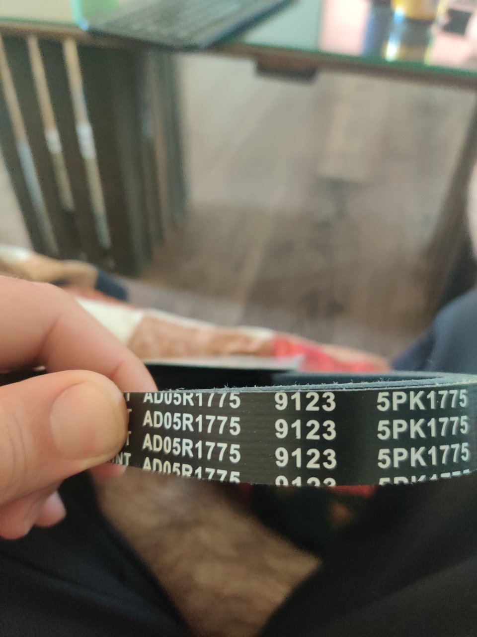

    Will be installing a 2.8 pulley, what’s everyone personal recommendation for a belt? Thanks in advance.

    converted AWD, RC62f swap, Supercharged
    Got the belt on this weekend. The tensioner sits in the normal range per the little indicator on it.
    So far so good. Time to see if I find more boost with this belt. Lol!

    Gates RPM OE size. 70.5" Part number is in the OP.

    brand? lengths are posted on page 1.

    URD, thanks I checked page 1. Just wanted to make sure there wasn't a latest and greatest out there. Apparently I haven't learned the buy once cry once theory.
