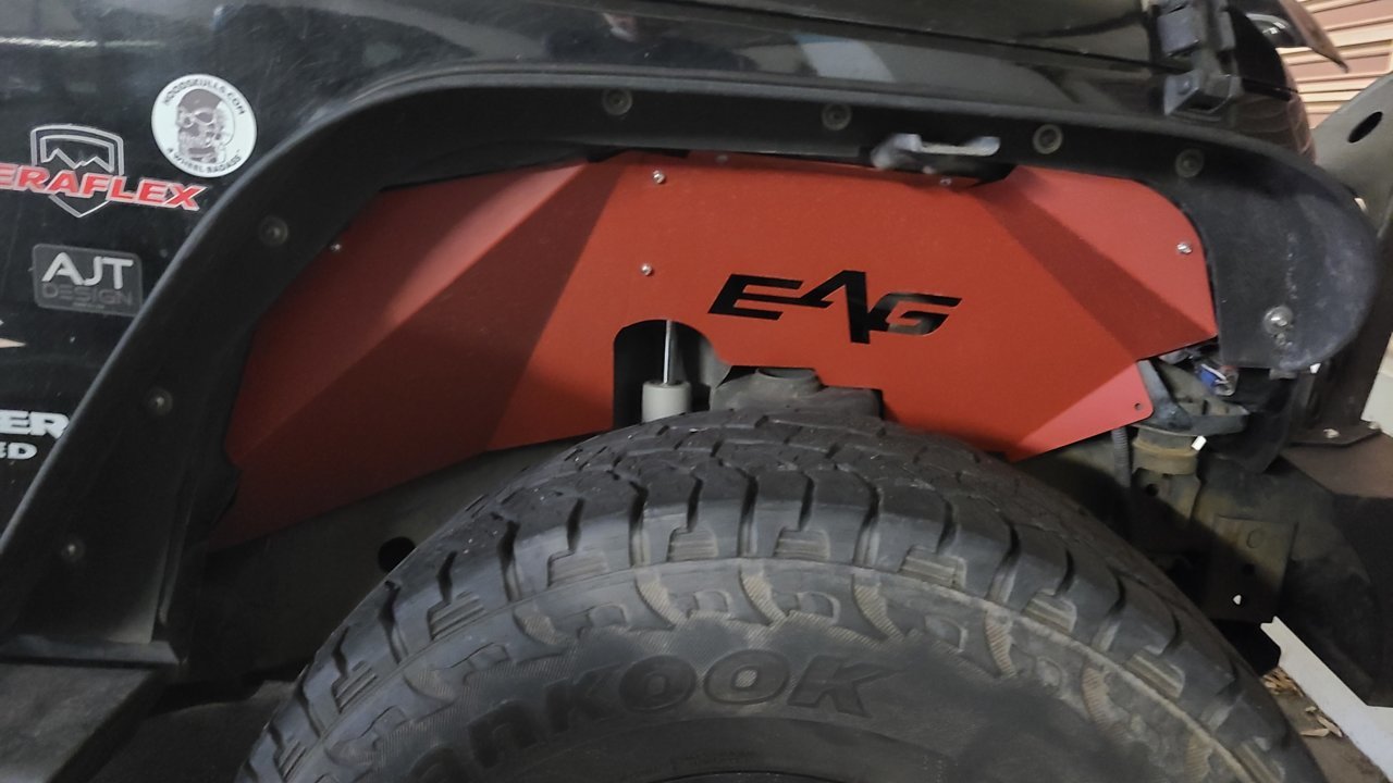

    Finally got the JT reflashed and running again after several frustrating computer tech flash issues. The SC coolant pump is tapped into the Fuel Pump Control Module fuse for activation. The pump starts after engine startup but shuts off very shortly afterward. Unsure if this is normal, but doesn't seem optimal. Will need to do live runs tomorrow and not just startup idle tests.

    Overall looks clean, and idling well. Is that pump right next to the fenderwell? Looks like a lot of real-estate around it.

    The fender liner is removed (obviously) but yes, it does have some good space around it. It is pretty busy above it though, so not very accessible from the top and it is pressed right up to the fender liner when its installed. Would have been way easier to install with the fender liner removed (which I recently did for another project) but that involves cutting off single use plastic fender rivets and needing new rivets and rivet gun to reinstall.

    Riv-nuts perhaps? Or this?

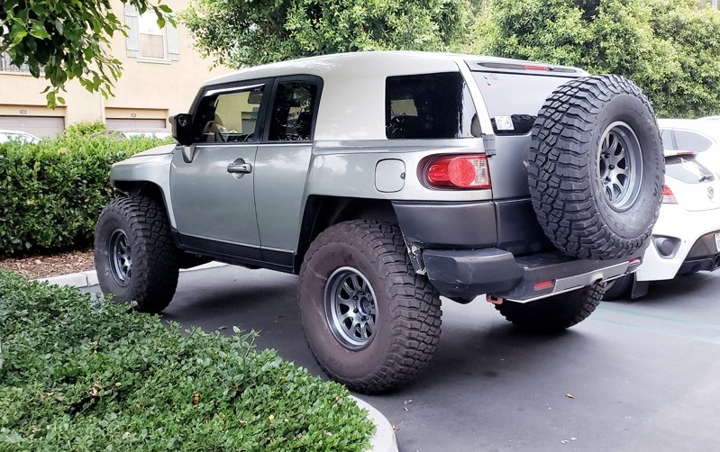

    Does my butt look big? I mentioned losing 4 lbs on the corners but gained 108 lbs on my backside. I can't imagine hucking two spares on

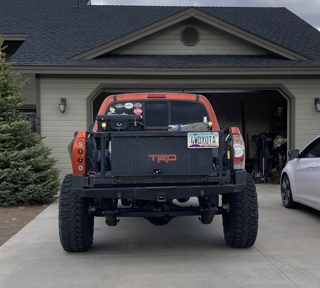

    wow, the shocks are impressive but that lean yo... you on a fuel cell or still rocking the stock plastic Rubbermaid tote fuel tank?

    Those Driver Tail Lights. Id go that route, but State LEO are sticklers for reflectors.

    Rubbermaid all the way. And it had just about a full tank for this pic so the lean is a little more pronounced.
    Yeah I don’t do much road driving. Not at night since I keep breaking license plate lights and have up on them. Need to get around to making the passenger side at some point

    I looked briefly at alternatives, the plastic rivets can be installed from one side. If not going OEM they are cheap enough. Not worth deviating from stock at this point.
