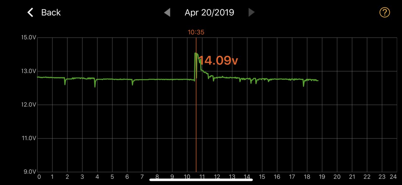

    I ran the trigger wire for the pump relay into the cab to a wire on the fuse box. Pump comes on any time the ignition is on.
    I did this because the week after I installed the supercharger, we took a week long trip to Disney and I came back home to a dead battery. The EFI fuse gets powered up periodically so the leak detection pump can run. So that means while you are sleeping your intercooler pump runs periodically. Not the smartest idea.

    Yep, I installed a battery voltage logger. You can see when the battery is being fed by the alternator and when the truck is off. Where off those low points in the plot are the supercharger pump cycling on causing draw on the battery. The unnecessary draw always bothered me.

    I discovered it the old fashion way as well. But with the data logger (installed for a different purpose) I thought it was interesting to see the frequency on which those runs occur. It was far more often than I expected.
