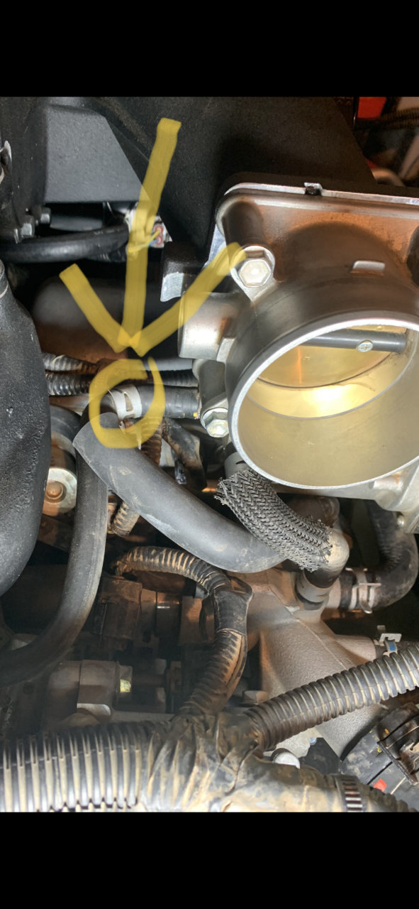

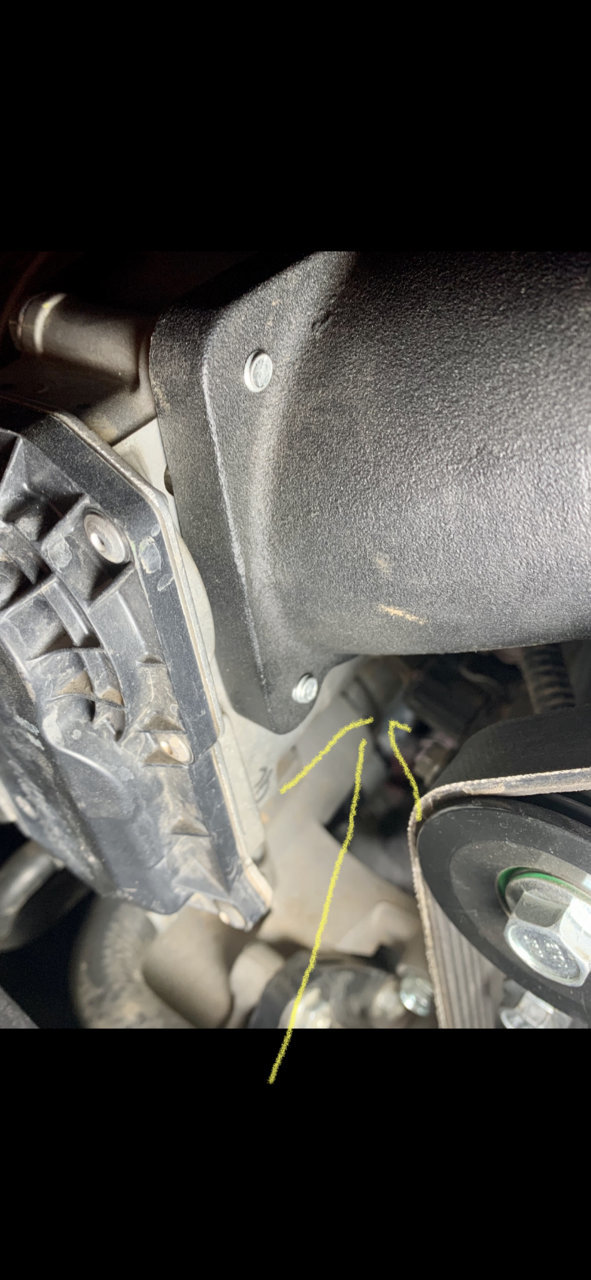

    Has anyone encountered a coolant leak from their thermostat housing? I did a recent install and noticed a small amount of coolant coming out

    Can we get a better picture? But it does not look like the thermostat housing to me.that looks like the water pipe extension. Did you lubricate the o-ring before install? With coolant at least.

    Hard to get a good pic , but it is that pipe extension , yeah I used lubriplate on it - maybe not enough

    My guess would be too much. Or nicked an o-ring. With the manufacturer I work for, they use o-rings in 90% of coolant hoses. They do not like a lot of lube. Just enough for them to slide and then seat. Have you put a heat cycle or two on it? May help, but not a guarantee.

    They have you reuse the oem o- ring that might be the culprit , I’ve put about 200 miles on it so it has been through some heat. If I’m lucky I can get it apart without taking the supercharger off....

    8F737B2C-41CE-40FD-A70C-107C2123521A.jpg *update* well look who forgot to slide a hose clamp over , looks like I found the source of that leak.

    You dodo. :laugh:
    I'm glad it wasn't a difficult fix for you. Now go enjoy your blower!

    Good find! Glad it was a small simple fix.
