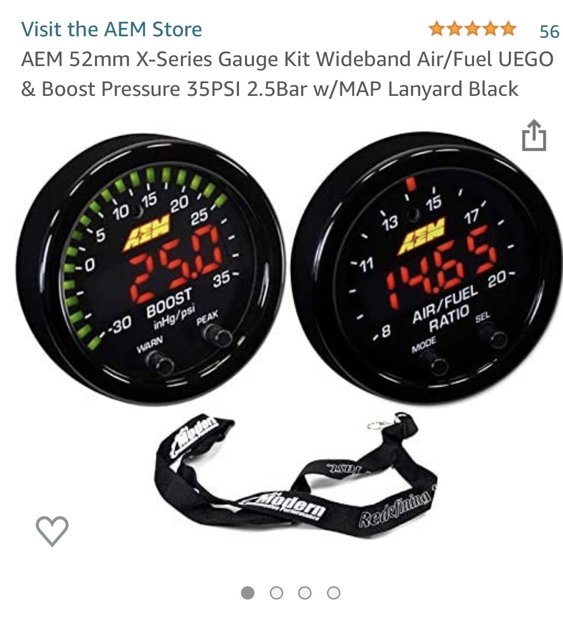

    as pictured i have one, trimmed for the same gauges you have, WITH a grab handle trimmed to fit the best it possibly can be. note the trimmed top in the pic i posted. its only down side. i cut it for my methanol controller wiring. pm me if you care to buy it.
