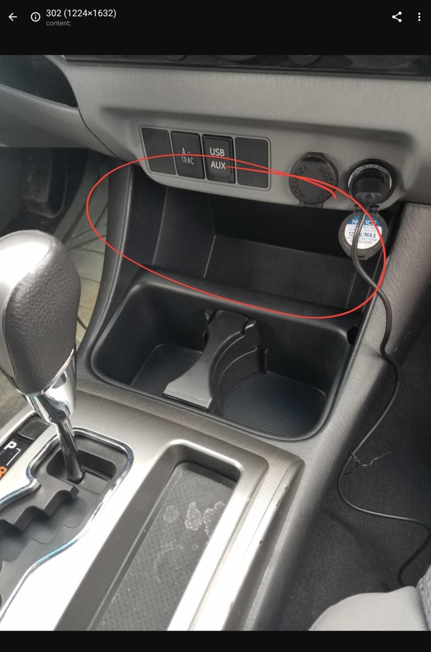

    I'm not completely following the discussion so, apologies if I'm confused. If you're talking about the console space in front of the shift stick, 6MT and A/T spaces are definitely different.

    Yes you’re following along/understanding correctly. This was my mistake if they’re different.. i thought they looked like the same size but now looking back at the pic it looks like the cupholders in the auto may change that. Maybe someone with an auto can post the length, width and depth so we can compare..

    @Norton this was the cubby/area we were talking about

    That's what I thought, but wasn't sure. There are pics of differences between A/T and 6MT consoles in the 3D printed wireless charger for 2nd gen thread... Notice how squared-off that area is in front of the A/T's cup holders, vs the 6MT's curved area in front of the stick itself. Here's a side-by-side shot of the A/T and 6MT chargers. This is why I (as a 6MT owner) was so eager to get a "3D printed wireless charger for 2nd gen," which works well, BTW.

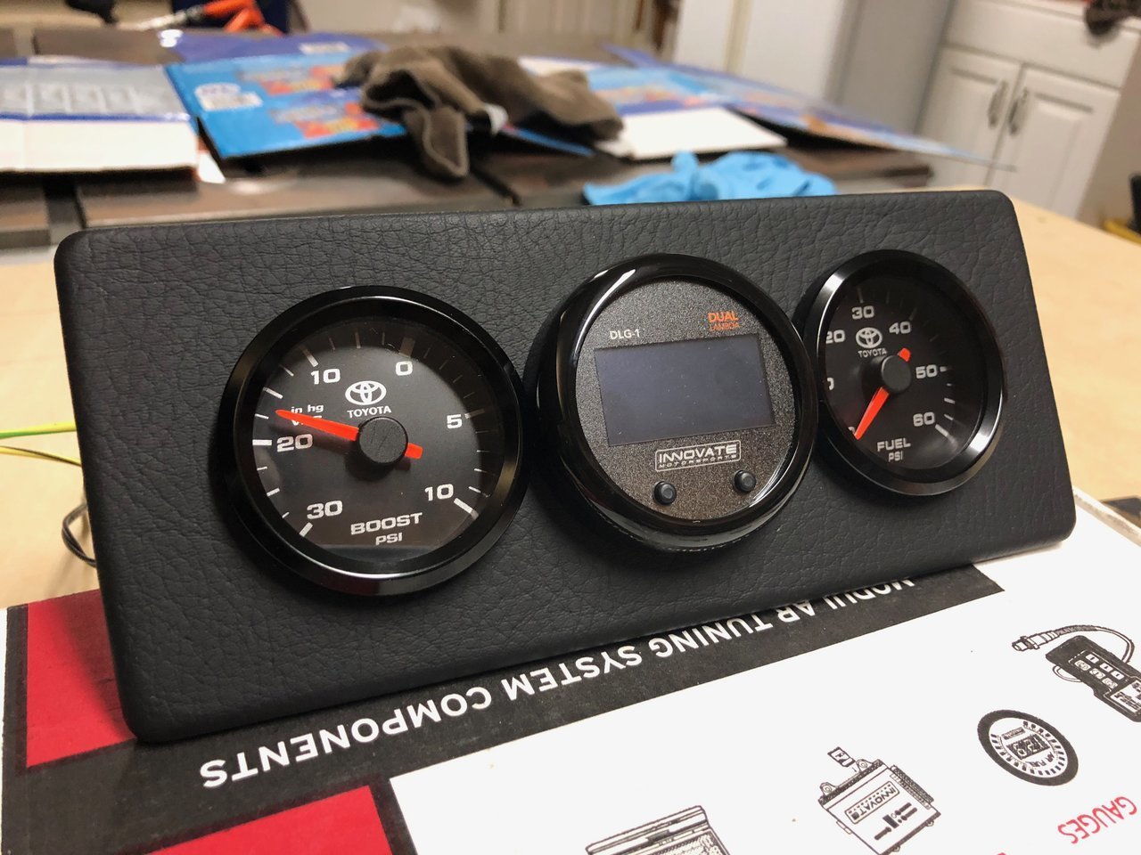

    Y’all could make your own pretty easy. It’s just a piece of ABS cut to fit and wrapped in vinyl. Use spray glue to adhere the front and then use CA glue on the back side edges to keep it from peeling up in the future. If you get it sized right, it just press fits in there and doesn’t move.
    3D print would be cool, but that vinyl wrap is looks sexy AF.

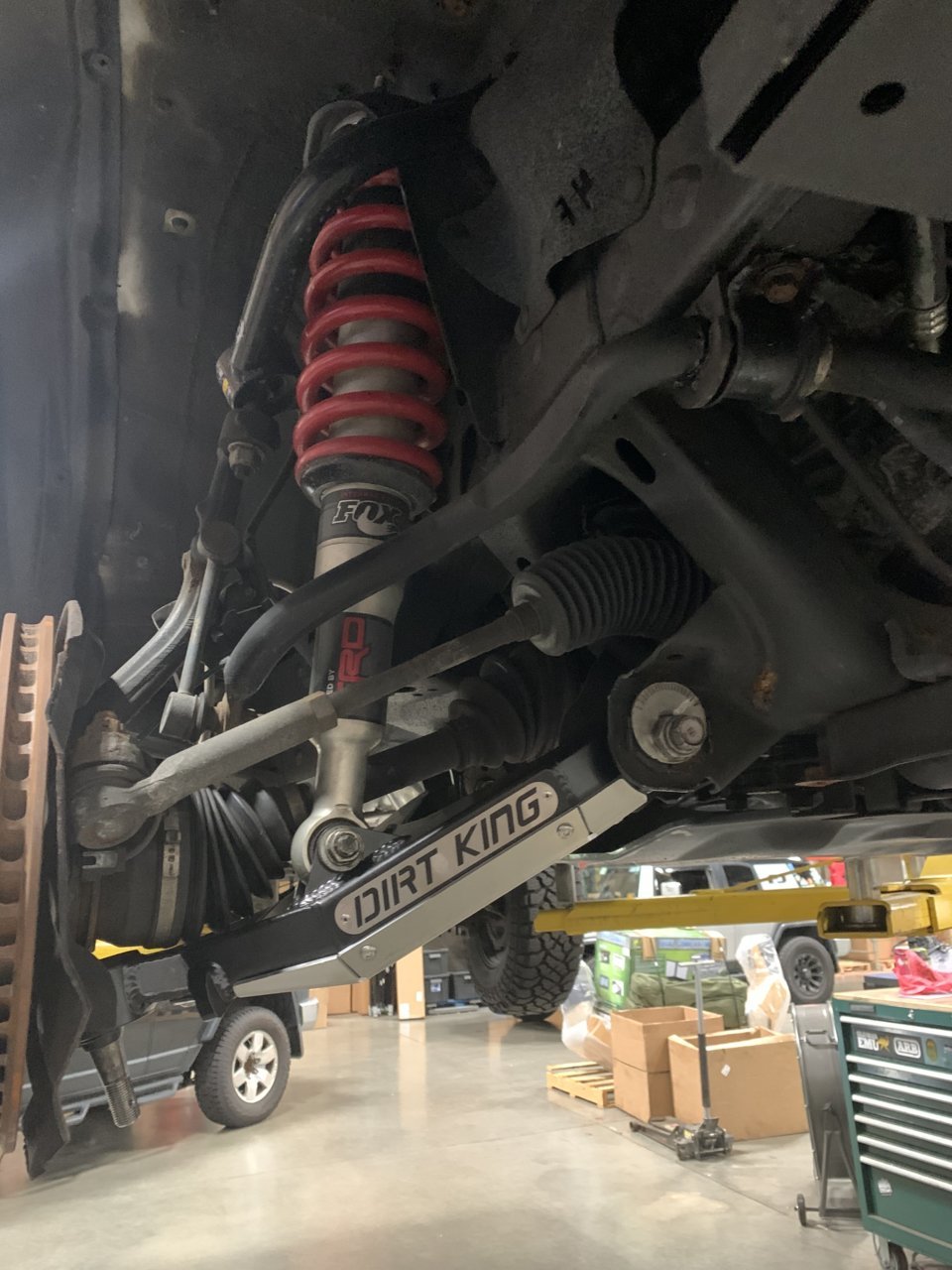

    Gonna look great my friend. It all should be easy and good to go. You probably will have to slightly bend the dust shield back a tad for clearance on the rotors. You can see here on the lower half of the shield. F07808F5-0D41-4C78-A605-82790F6E11CA.jpg

    Thanks man! I ditched my dust shields long ago. So should be smooth sailing.
    Man.. I forgot we have the same Lowers too. Gonna be Twinsies. Lol
