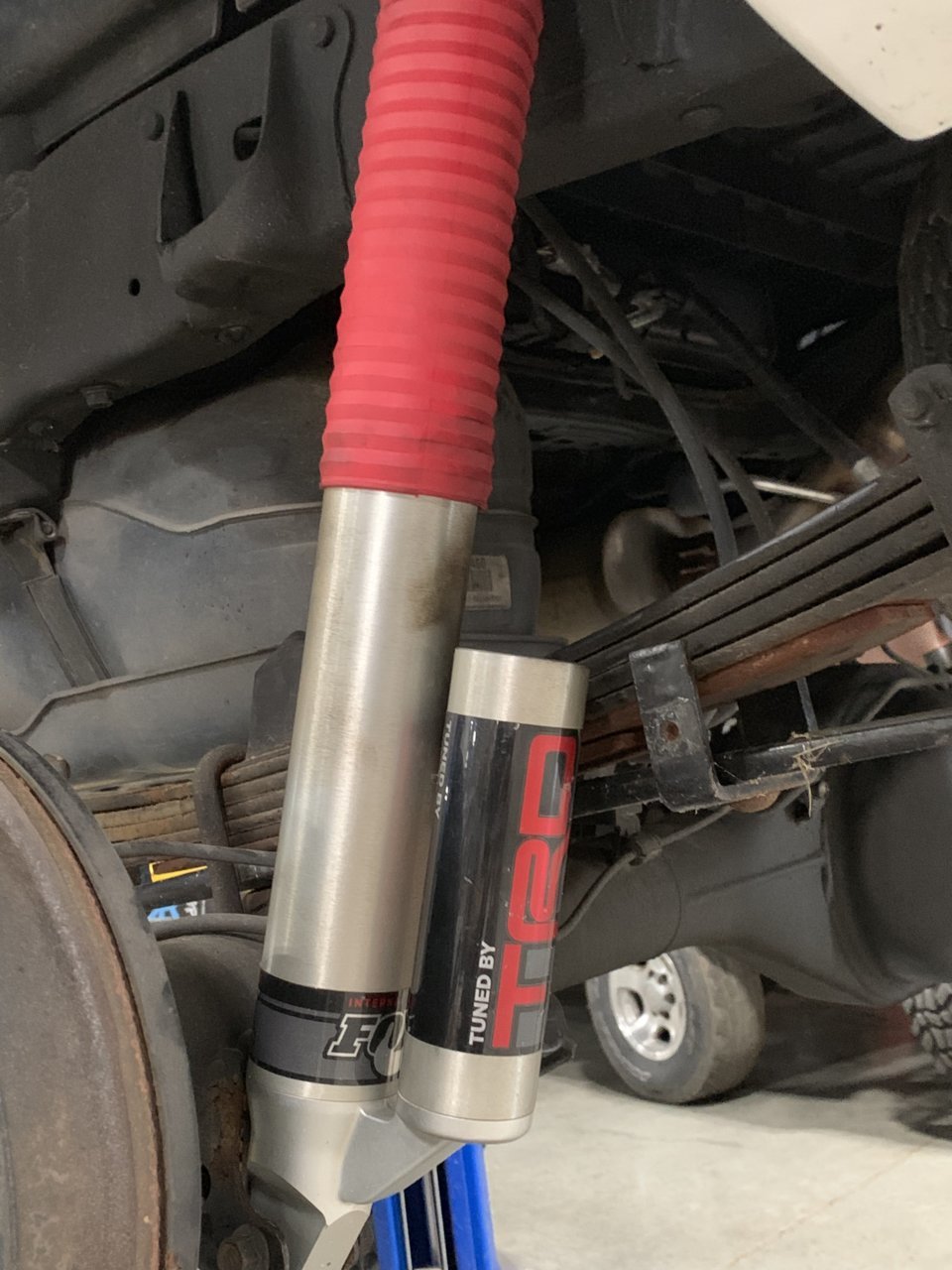

    Awesome. I like this setup a lot. I added the wescott design kit to it for a little extra height
  3. Jun 25, 2021 at 6:19 PM
    JuanitoBonito
    JuanitoBonito Que Pasa
    Dec 29, 2013
    #119422
    9,203
    Juan
    CHI-TOWN
    2024 Raptor

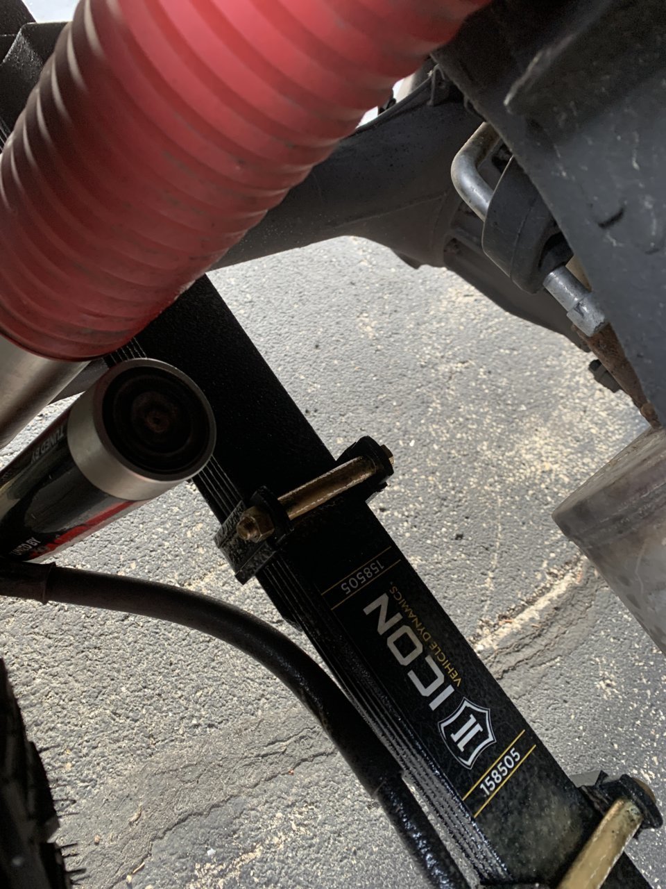

    The rear
    A2FB6ED3-C924-457B-889F-14DEFDBD8257.jpg 11D773B0-AAEC-47FA-A26F-E4F4D860D97A.jpg
