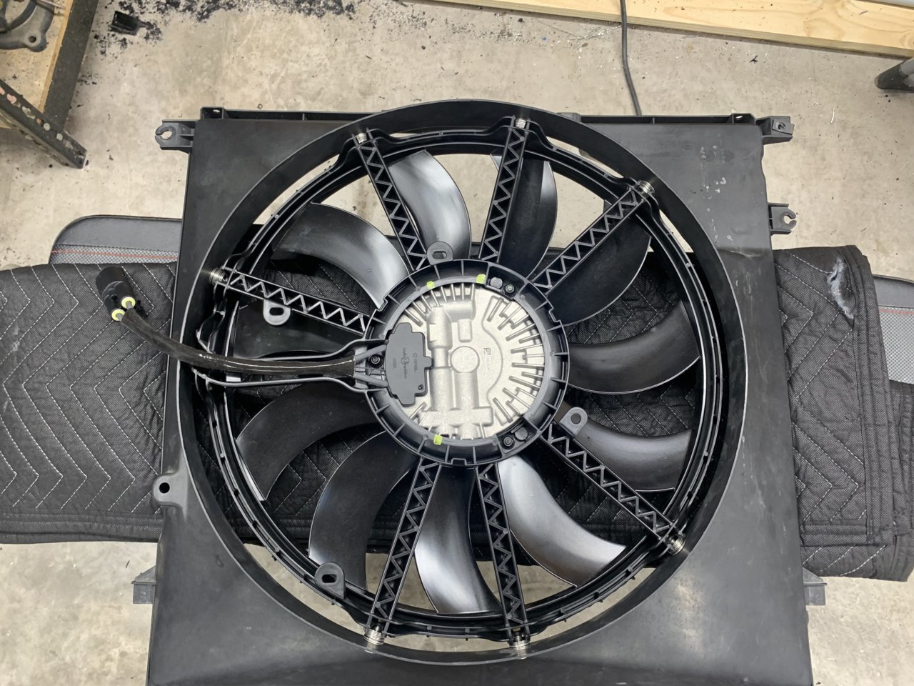

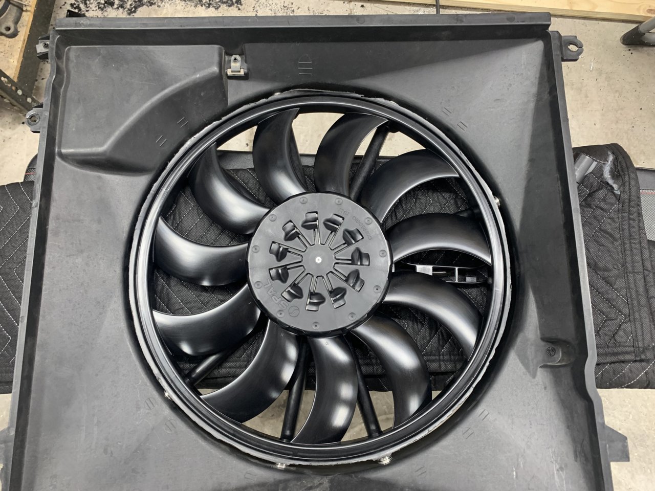

    Sawzall, bolts, washers and nuts. Doesn’t show in the pics, but the gap is fully filled with 3M Window Weld.

    Nice it def came up. I like the idea of the A/C line.

    Need a play by play on this please. Haha holding out on us.
    Just had sent an email about looking into a custom shroud but man this looks to be spot on. I want to give this a go.
