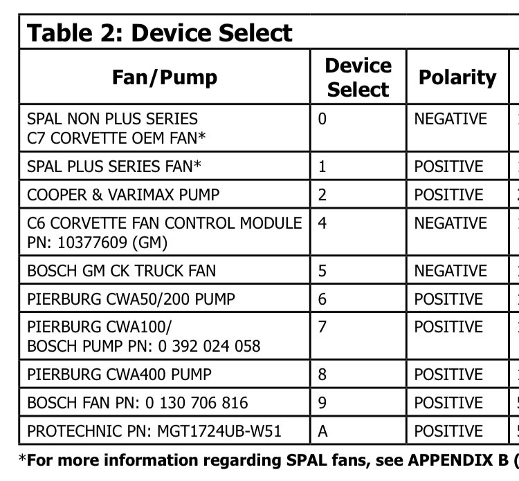

    It says “When the Override Input is activated, the fan/pump will operate at maximum speed.”
    So technically it has that feature. But the thing I don’t like is that it’s 100%. That would be fine for a smaller fan. But this hoss is sucking 850w. Imagine sitting at idle with the A/C on and your fan is drawing 70 amps. It would be nice to be able to choose the duty cycle when the override is used.
    Autocoolguy says the HF-125 works with brushless fans. But I think Spal has some special sauce in this fan that requires a little different input to get it moving.

    That was me who stated the AC trigger wire will not work with our setups with the Lingenfelter controller. This came straight from Lingenfelter tech support direct. If you want to use it you can but you will have to set it to a fixed speed. Basically it won't use the ect sensor.

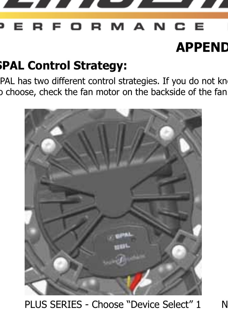

    The Lingenfelter manual shows a table of devices and the PWM polarity. The Spal sealed brushless is Type 1 according to Lingenfelter. Their table says the PWM polarity is +.
    The Autocoolguy sends -. There is an input at the bottom that connects to ground. I wonder if it could be connected to + and then it would send out a + on the PWM. Need to talk to Darryl and see if that’s possible.

    I have two Spal fans that I'm running the HF-125 on and I absolutely love it. Here's the difference in what you and I have going on and why you may want to change out the fan you bought for a standard Spal fan. I'm using standard Spals which have simply a power and a ground lead. The Autocool guy controller simply modulates power to the flowing through the device to ground. If you want to run the fan you already have, wire it in the direct configuration which would be 100% all the time. Then the controller will work.The OEM style Spal is double the cost of a standard fan and if you're not going to use the functionality of it, might as well save some money.
    I've got it.
    This is absolutely designed to run a brushless fan like the spals. The spal fan that is being discussed here is design to internally modulate the fan speed based on an OEM signal. The Autocoolguy controller is made to modulate the power signal to the fan, that why its not working as expected.
    That's how I would wire it and let the Auto cool guy modulate. Or return that much more expensive fan and get a standard Spal. You basically have two devices intended to perform the same operation working in series but you don't have the right signal for the OEM spal fan coming from the controller. The Lingenfelter controller just modulates a low power signal to the fan and the oem fan unit controls the power signal to the fan motor. The ACG controller is designed to work with two lead fans.
    I think that's the beauty of PWM, it can control the motor acceleration profile so the fans don't have as much end rush current as if they were switched full on by a relay. It should reduce the peak amperage requirements and normal operation would be less than 100% as well. Maybe I'm wrong on this?

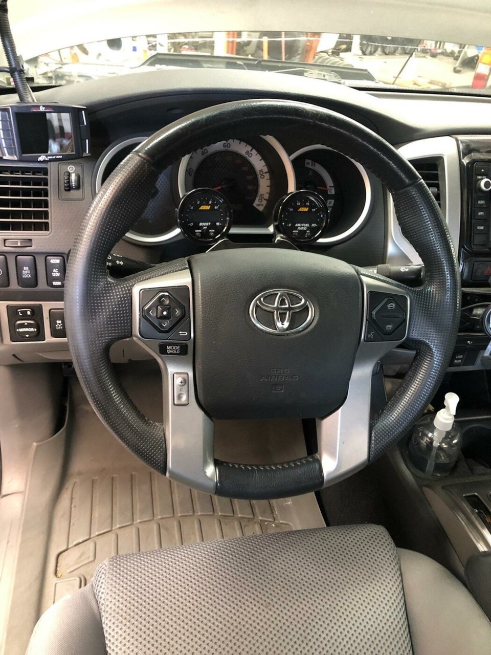

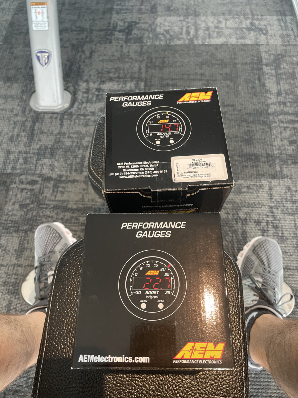

    Anybody have a good thread/video I can read/watch to help me put these gauges in? Thanks in advance

    depends on many factors. if you use a fuse tap for powering them and a good ground location the rest is just fishing wires through the firewall to your location of choice.
    personally i run aem x-series in mine. but id opt for a smaller spectrum gauge than you have. if youre at stock trim you'll only see 6lbs max. having a gauge that goes to 35lbs is more for tubo motors.

    not a guide, but as @White lightning boosted pointed out, you'd be better with a lower number dial. This is how @81Trekker did mine but he used a custom bracket and it came out great.
