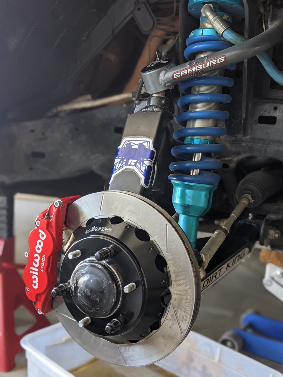

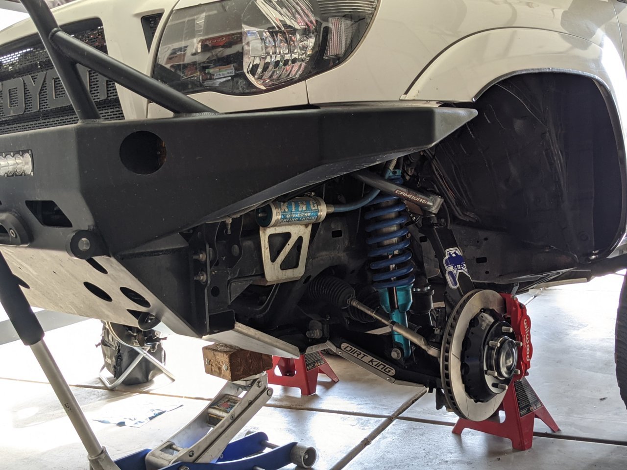

    Got it all finished up. Got the driver side all dialed in with the shims and spacing of the caliper and pads. So it's nice and even on the rotor. The passenger side has a little drag. Wondering how much is acceptable.. I could mess with more shims.. but it's getting fine now and running out of adjustability. I'll finish it all up once I get some good brake fluid, bleed it, and ready to rock!

    I went lock to lock but didn't cycle checking for Clearance with the Wilwood brake line. I think I got it pretty good. Once it's back on the ground.. I'll do some more checks.

    4x4. CV is hidden.

    you got a sweet looking front end sir.:boink:

    Ooooh.. :oops: thanks man. Been a long "rebuild" the last year or so. Slowing throwing all these parts at it after the last couple incident's. Figured phase 2 time and beef it all over again.
