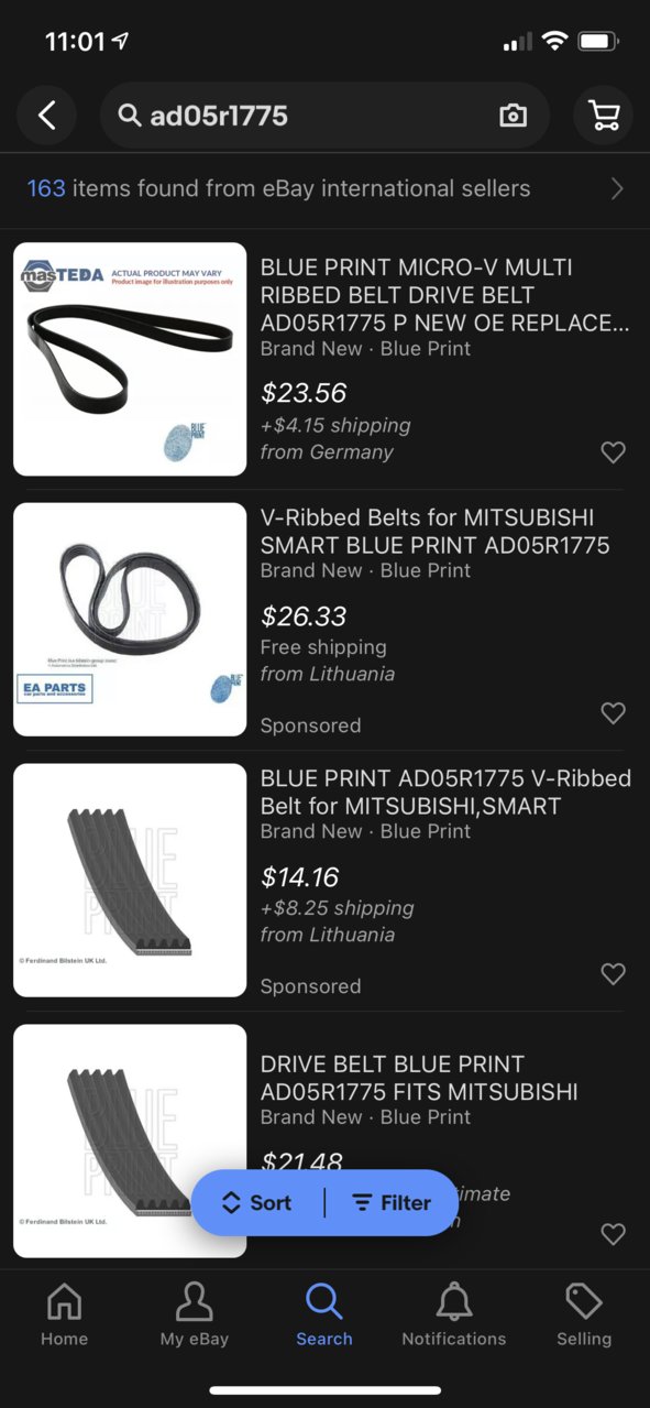

    I can add it. Do you have the info on the belt?

    @12TRDTacoma
    here it is.

    I'm not sure if that is worth adding to the list because it appears to be less than commercially obtainable both through eBay and Amazon. It seems the only applications for it is the Smart Forfour car and the Mitsubishi Colt VI. This is all after a soft search of course.
    You might have gotten lucky with getting one at the time but it may have been a one off thing.

    @12TRDTacoma They are still on ebay from multiple sellers. They just come from over seas. I had stated that in the first post about it. But it is what you feel is best. I'm just putting the info out there for all.

    Just ordered mine from Germany. We’ll see how long it takes.

    What did you do on ebay, punch in the part number alone?

    @12TRDTacoma I used the 5PK1775 and looked for the belt. It brought up a bunch of 5PK1770 as well, so be carful.

    is there something special about this belt or just another option? figure the RPM 70 OE size is still the best one to get.

    I think this belt addresses the in betweeners running a smaller pulley but no reinforced tensioner. It's not a 69.5 but it's not 70.5 so it's a middle ground for all pulleys 2.6-2.9.

    The 70" is for the 2.8-2.7" pulleys to put the tensioner in the proper spot in its travel. The oe length is 70.5".

    Gotcha sounds like with the stock tensioner. running the rousch and double the OE length has no issues on 2.8/2.7.
