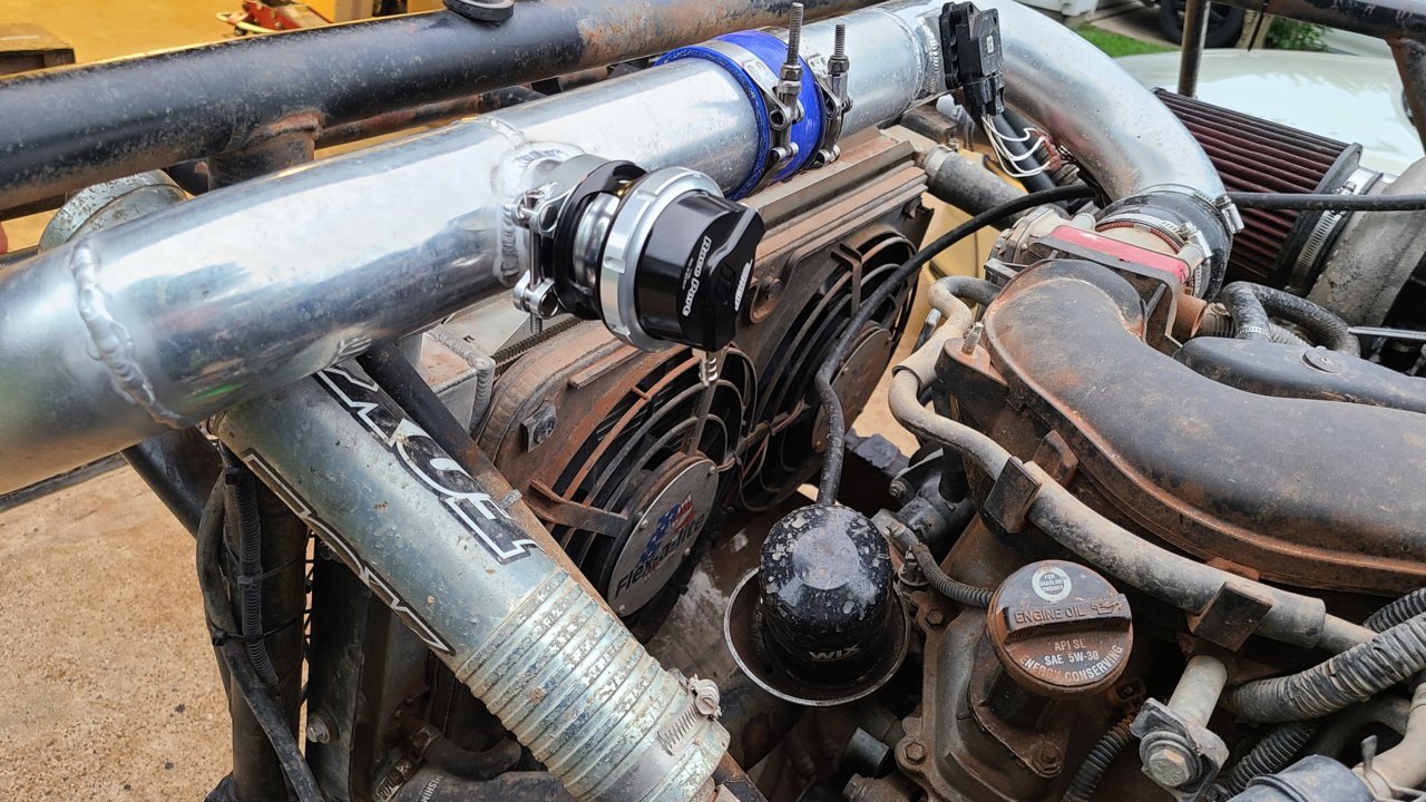

    Does this help?

    So are you using the Lingenfelter controller alongside with the autocoolguy rig?

    Here is what they look like installed.

    I have the flex a lite with a Derale PWM controller. It works pretty well but does not cover the whole radiator as noted. I havent had an issue on normal driving in traffic but the temps gradually climb when in the mountains and I get stuck driving behind slow cars. Maybe one day when I'm not so lazy I will get a sheet of metal to make the actual shroud but seems like there's more options now than 2 years ago when I bought it. There's also stronger fans. I think this one flows about 3300 cfm.

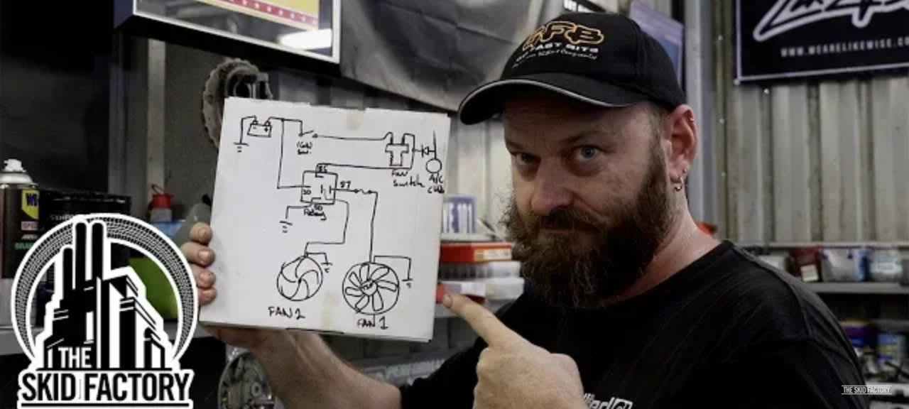

    I also found this “Poor man’s Lingenfelter” last night and ordered one to play with.
    https://www.ebay.com/itm/143561646769?
    If you look at the last two pics in the auction, it has the instruction pages posted. It actually looks like a very nice little module for $50.
