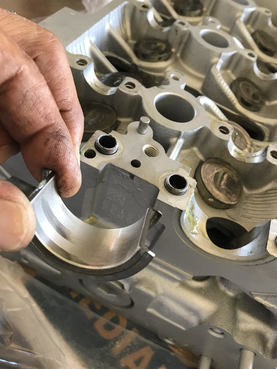

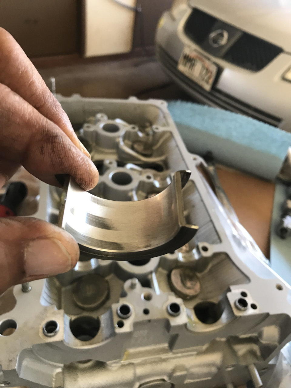

    Another question guys - are babbitt bearing cups reusable if they are still unscratched and smooth. There is one under the passenger side intake cam and I have a remanufactured head that came without one. Can I use the one from the older head?
    Thank you!

    If it's in good condition I don't see why not.
