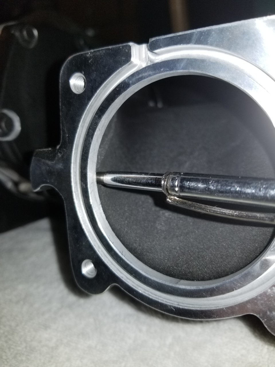

    Did you port the opening on the s/c to match the 76mm tb

    No. But I will soon. I live in an apartment and wrenching is frowned upon. @Roostfactor did. If you need tips he's the guy.

    Possibly a little at wot. Do it and let us know.

    I did. I noticed better throttle response and more top end.

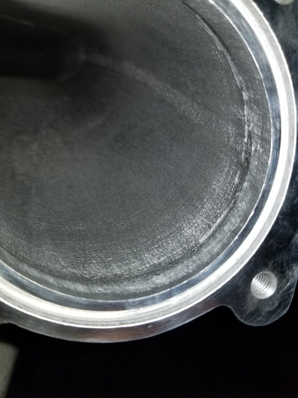

    I ported the sc inlet to match the stock tb before I ever installed the sc.
    Then port matched it again (only slightly) to match the URD 76mm tb adapter.20170509_123809.jpgbefore20170525_215806.jpgafter

    There is enough material to shave down and actually match 76mm? Did you use a dremel?

    No but there is enough to match the URD tb adapter.
    Yessir. Mr.Dremel in effect.
