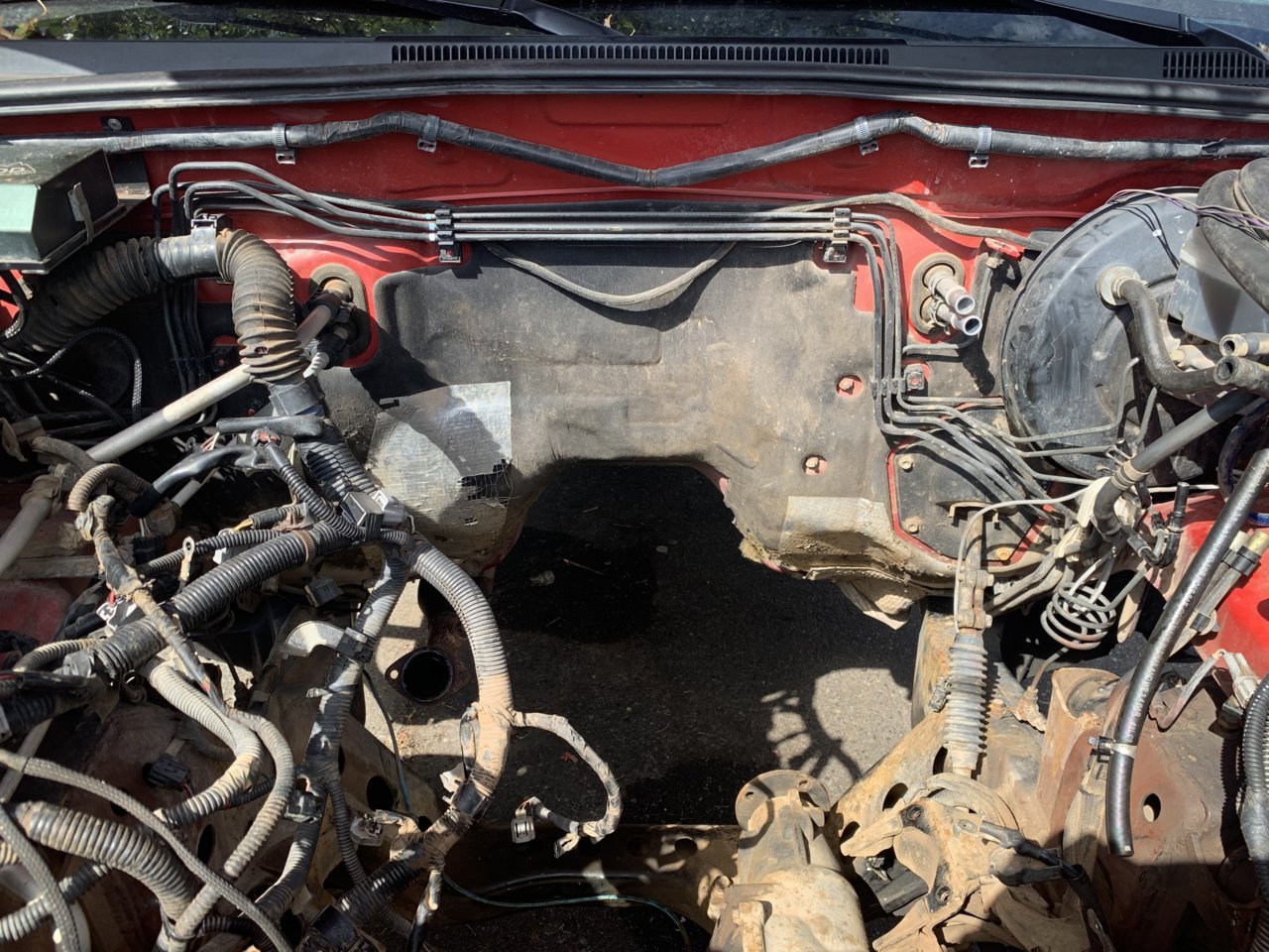

    Good time to clean and paint in there.

    Ah that's perfect then. I'll make a mental note of that next time something needs to be done in there then. Maybe keep some bungies handy or something.

    Motor mounts huh? Couldn't y'all get away with removing the front drive shaft and jack the engine up a bit? Ive done them two to three times and didn't remove any lines or wires.

    yeah thats the plan starting tomorrow

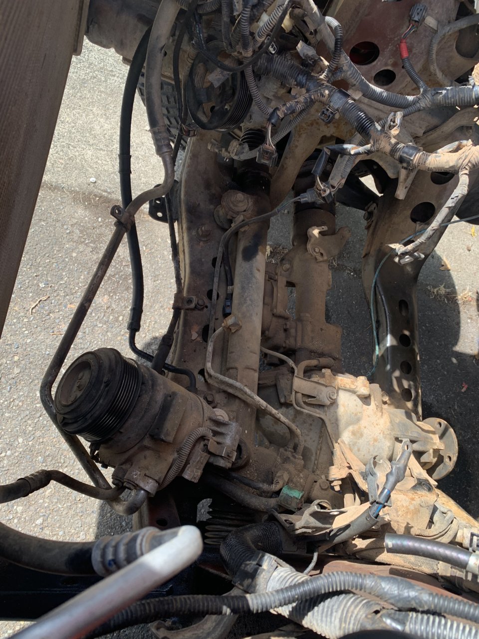

    here is another pic of the shit i need to clean up in there [​IMG]

    Definitely what Lucario mentioned. Fend off that rust.

    Same. PS pump and compressor have all the slack that they need to relocate out of the way.

    You have to jack the engine up a little regardless.

    the feedback I got was you could do it without removing the driveshaft as well you just need enough to pull them out. so yah just a little bit as @12TRDTacoma noted. Its more about getting to them so you can get them out. A lot of crap around them. The passenger side seems doable. the driver side is a bit more challenging. Saw one guy do it on a pre-runner and looked much easier since none of the 4wd stuff was there. Realy did not want to remove all of that but if I do then time to start installing the new suspension w hile I'm at it.

    I'll tell you right now I did not remove anything to do mine. Did it make it that much more complicated in doing so? Absolutely. In hindsight, I could and should had removed the front driveshaft and the compressor but I wanted to simplify the install process. Surprisingly enough I still got it done in good time but it did make things much more difficult to access using tools regardless of whether or not they were swiveling.
    It's as they say, hindsight is 20/20.
