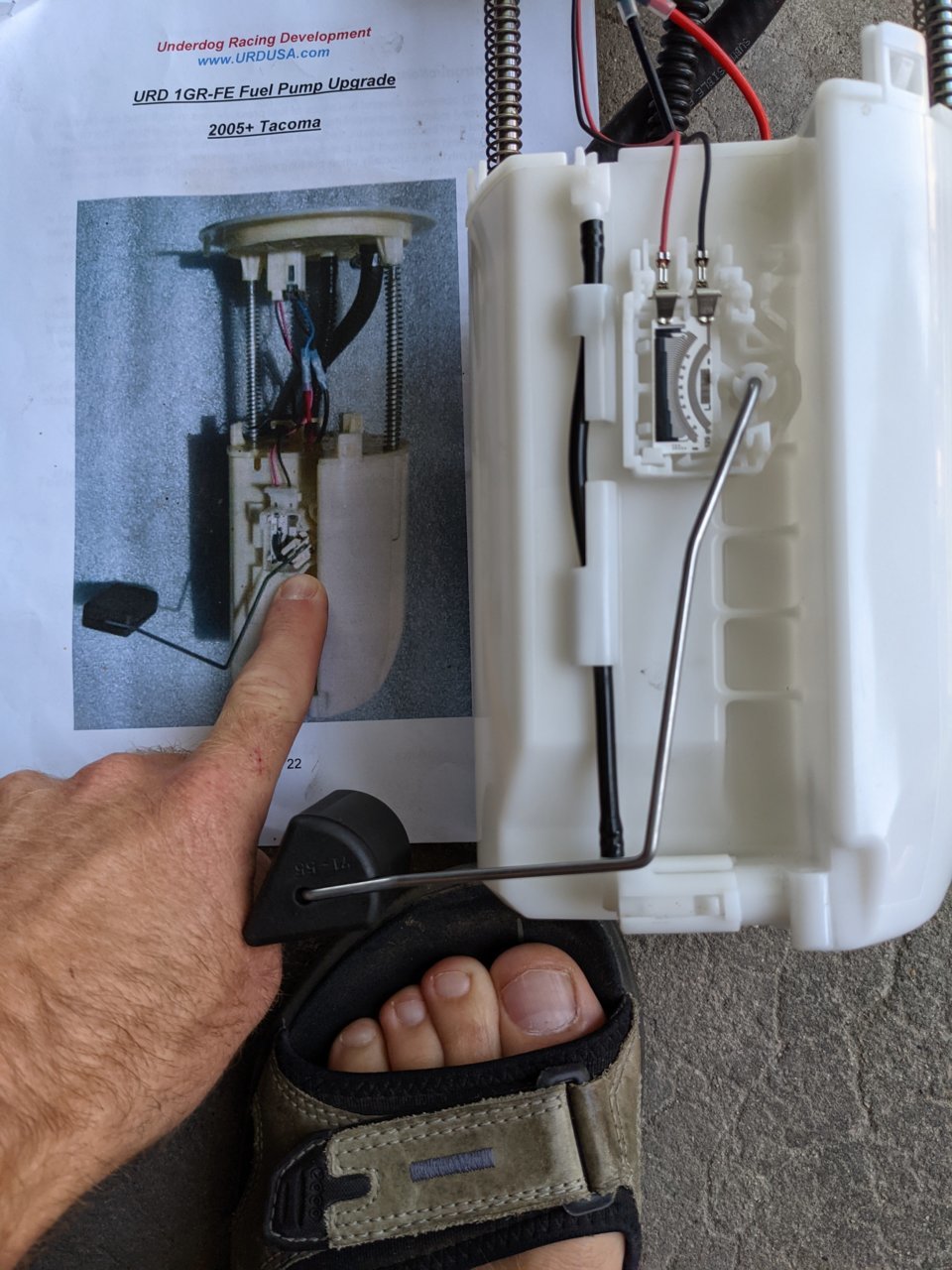

    Did I lose a fuel float arm clip? Does that clip help with the readings or just hold the arm in place? Is there a part number for it? I'll keep looking around but I don't remember removing it, and it's not in the gas tank

    I don't see anything on the bucket to obtain readings with. So it's likely you lost the clip which takes the reading of the tank based on the position of the arm.

    It is contact that completes the circuit, for the fuel level sender. Missing.

    Hell ya! Found the clip/sensor under the trash can lid near where I did the res dremel work
