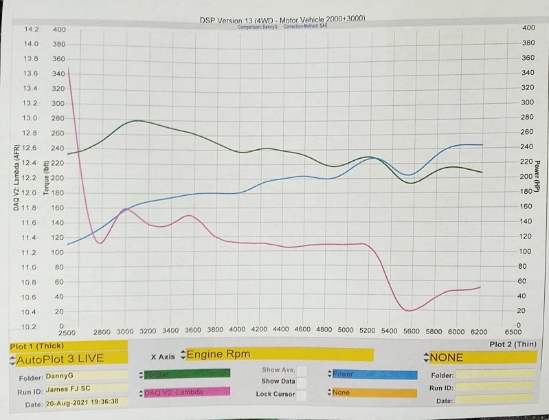

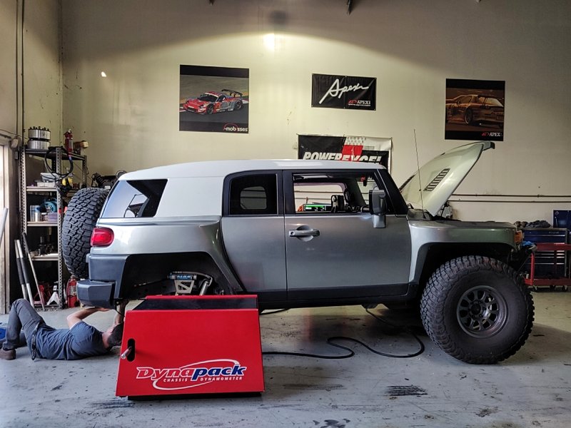

    292 hp / 316 tq on a Dynapack.
    Considering the radiator system requires steady airflow, heat soak is a major concern. You can see a 46 hp Delta between the 1st and 2nd run. Didn't think to check with a thermo gun. My AC compressor stopped working after the sc install and wondering if I should wire up the AC switch to ramp up the fan as well. I think I finally need speed holes in the bumper and maybe zzp water pump.

    Look at all that low rpm torque!

    That is huge. Wow. Thanks for showing. Be good to copy that to the F/I dyno thread, with the point explained.

    Yes really happy with the response down low. It was my first time on a Dynapack. The tuner tech said it reads about 10% higher than Dynojet. I was hoping to hit 350 ft-lb but true drivetrain loss with 216lb of wheel and tire on the rollers would show I'm much lower. Oh well. Car is fun af to drive

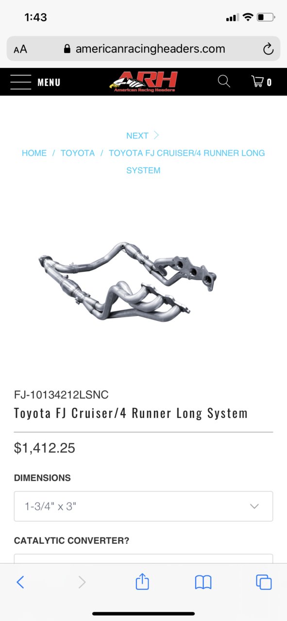

    What y’all think of these? Anyone running them

    ARH makes some very high quality headers. Those look to be for the dual VVTi 1GR.

    The run was back to back and the fan air was hitting my bumper bash plate and directing the air elsewhere. For a couple years I said it wasn't an issue but clearly it is

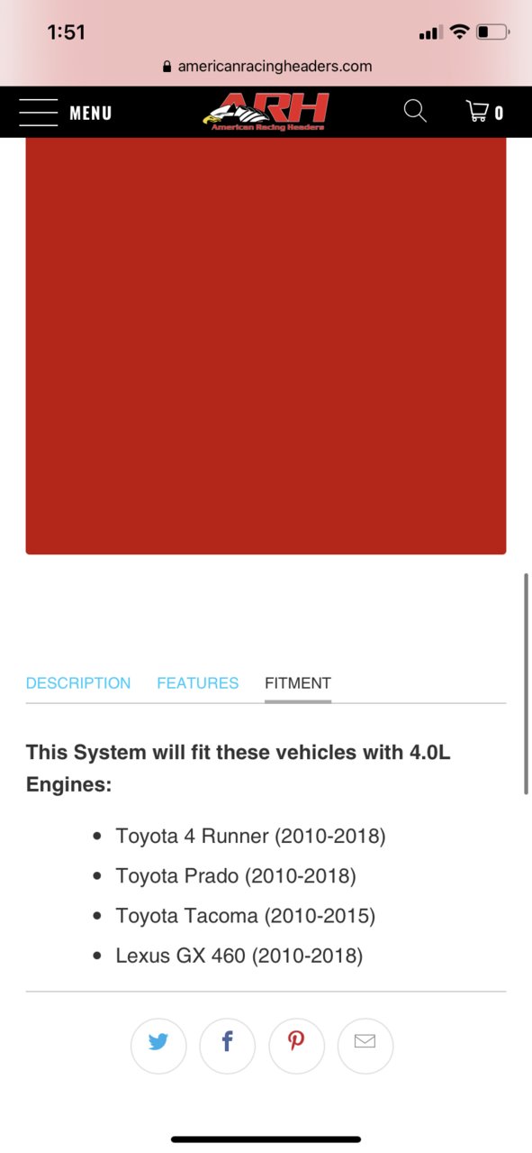

    Says it fits 2010-2015 tacoma. ? Ya I’m
    Confused.

    Maybe they meant Fj. Didn’t early FJ lack dual vvti? Also is there a GX 460 without the 4.6 V8?

    Only the Prado which is the gx in other countries. That whole ad is wrong tho. The 4.0L for everything but the Tacoma got the dual vvti in 2010

    Ton of shops have the Tacoma listed incorrectly. Recently told the guys at JBA that. They shipped me 4Runner headers as it was listed as fitting a Tacoma. I doubt they would fit and are listed wrong
