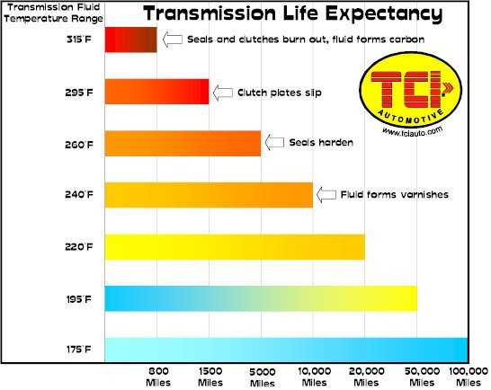

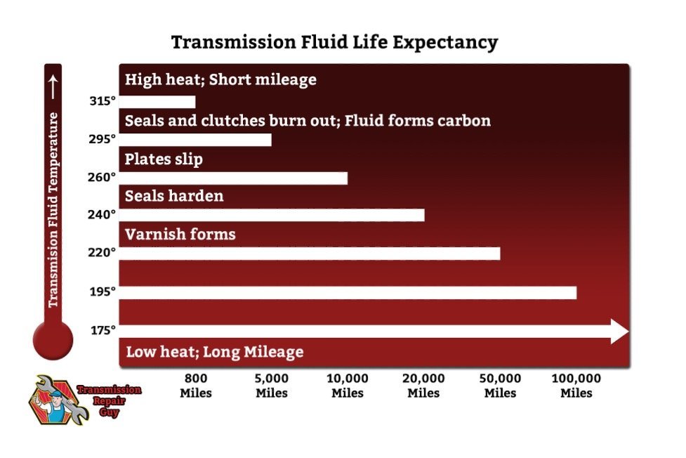

    200 is the temp that trans fluid starts to break down but it breaks down very slow at that temp. I saw multiple charts that said that at 200F, it should be good for 100k. My 09 is the offroad and simply has the stock/factory trans cooler on it. Nothing after market for cooling other that the 170 degree thermostat.
    I would recommend the kit even if you're watching the temps. The valvebody is set up for factory power levels and we're above that so upgrading the valve body to match is good piece of mind and will help prevent premature wear/tear.

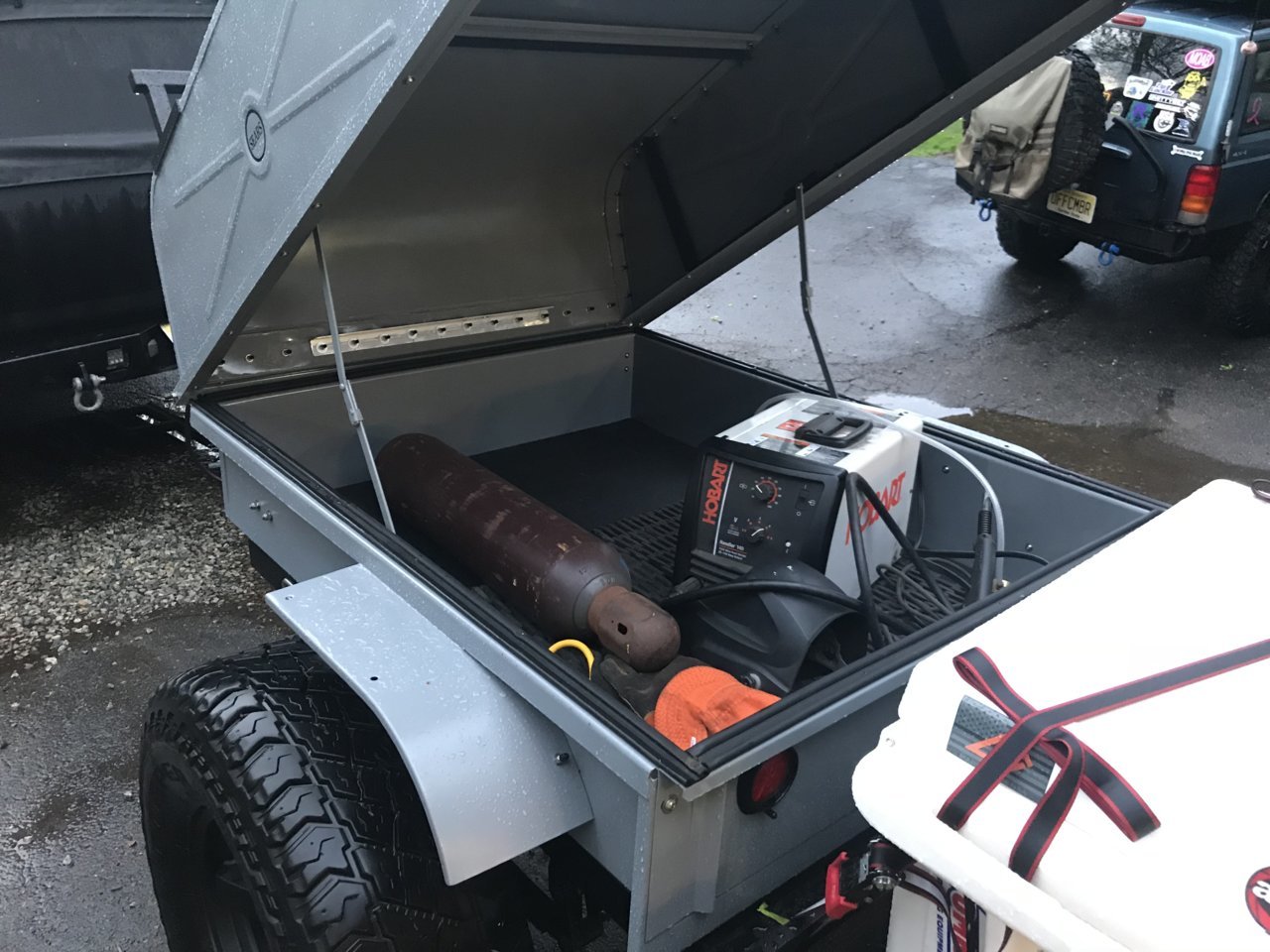

    Take some shit out of the bed ffs

    Packing up for NH. Much more to go in.

    I am aware that there seems to be some sort of debate between not being able to use both kits in conjunction, but in order to understand what is going on here you will need to study the parts included with the TransGo kit and study the RatioTek kit. The TransGo kit uses many different items which are not included in the RatioTek kit. What tips me off over you being able to use it is that the TransGo kit never has you enlarging offices and installing spring upgrades like the RatioTek does.
    You would be able to install the RatioTek kit in on top of the TransGo kit. The RatioTek kit makes modifications at the boost valves, plungers, and valve body check valve orfices by enlarging them and using a combination of manually increasing line pressure as well as increase spring tension to said valves and plungers by installing dual and even triple springs into the setup already in place.
    The modifications they make are different to the TransGo kit, but benefit the valve body in a much different way than the TransGo kit does. It is therefore my observation that you will be fine in doing further modifications using the RatioTek kit.

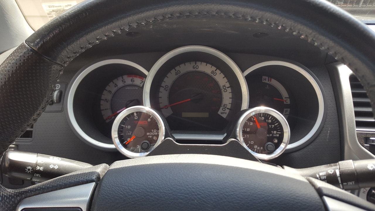

    Speedhut gauges FTW

    They look sexy, no doubt!
