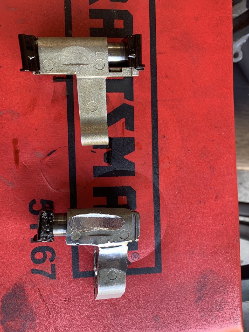

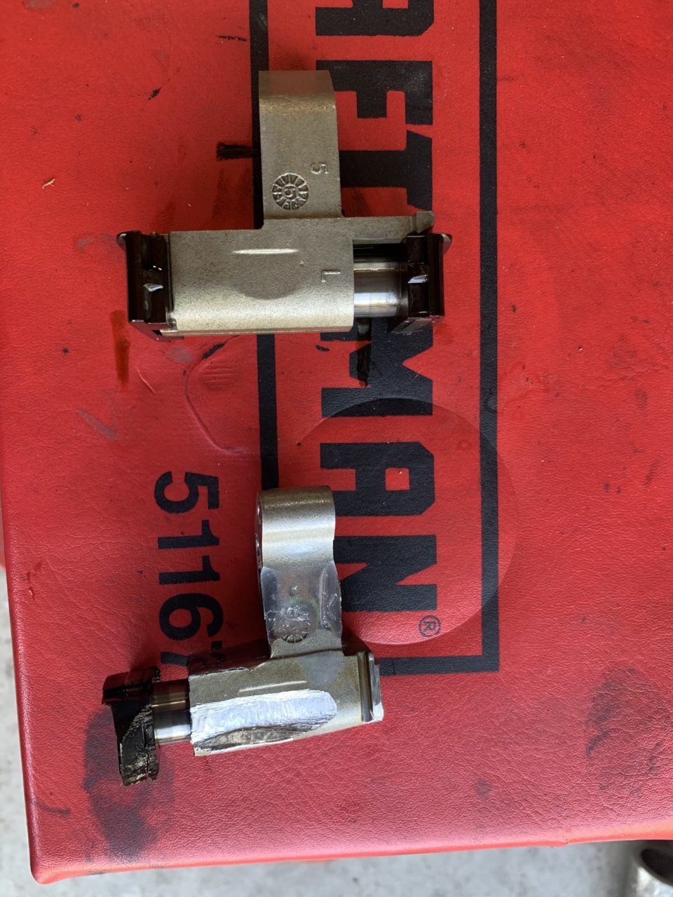

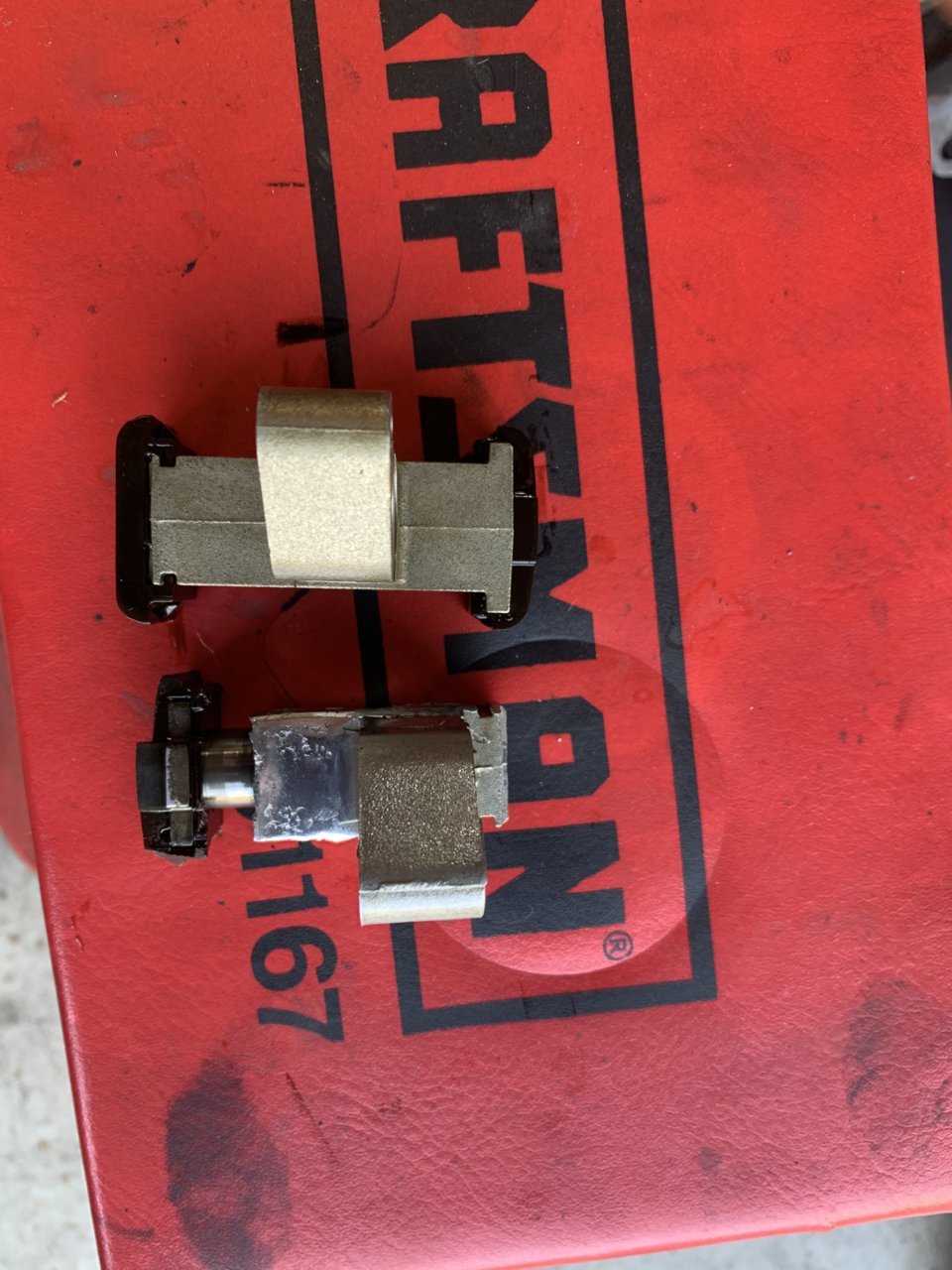

    So I pulled the exhaust cam gears off and pulled the tensioners out for that chain. Figured out where all the broken pieces and metal flakes came from. Probably could have put a new tensioner and dowel pin in and the engine would be good to go. However I don’t know where all the metal flakes went and had a low oil pressure condition so don’t feel comfortable to put this engine back in with out a full rebuild. But I don’t think anything else was damaged.
    The not damaged on is the drivers side and the beat the shit out of one is the pass side and the one that had the bolt come loose
    88367FC1-DA9A-41CF-80C4-C20CC7C94307.jpg 90ED8C71-5598-4D40-AB0C-3A1E48BD614D.jpg DD8B022A-1BA2-40AD-BBF3-4BDE3F31A265.jpg

    and in the second pic, the huge gouge im pretty sure is the exhaust came gear coming in contact with it. thats the side that is next to the gear

    Jeebus. I'm glad I added a few extra inch-pounds when I put the bolts back on during the camshaft job.

    Yeah the tensioner bounced between the two cams and got chewed up. I plan on putting some blue loctite and got torque wrenches this time for everything.
