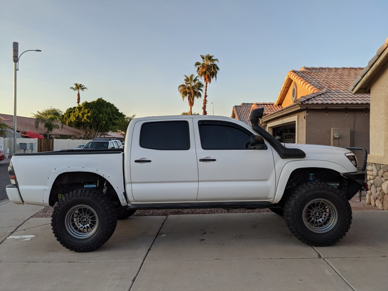

    > BUILD LINKS >
    Alright.. I gotta get this figured out. @JustDSM are you available this weekend by chance? I need to buckle down and finish my HP Tuner Setup on the new Laptop so I can do some data logging and hopefully figure out this surguhg under WOT issue.
    Gutted the truck for some big changes coming.. and have been ripping around enjoying the new lighter weight and less roll, etc. But when getting on it.. it still surges, until I ease off the accelerator.. and ease back into it. The afr gauge reads fine, if anything it's still rich. No codes. Nothing out of the ordinary. Etc. I've tried testing with the Snorkel hooked up vs not. Same thing. I need to just get the data logged and see what it's doing, when it happens. I'm really thinking it's exhaust related. Like it needs to be opened up even more.. but thats just my non-expert opinion.

    I can be available. Lets get a date/time locked in so I can arrange my plans. But lets definately get some logs. Your tune isn't something out of the ordinary, but lets take a look at the logs to figure out what's happening.
    From past experience with folks reporting surging issues on S/C applications, plugs have been the culprit. When was the last time yours were changed, and what were they changed too? I'd ask that you have a fresh set on standby if possible. Even if they're just the standard TRD spec'd ones.

    Changed at 90k.. I'm at 130K now. Per my logs and build thread.. looks like I stayed with the IKH22's. The standard upgraded TRD plugs IIRC, right?.. Maybe its time to upgrade?
    Thanks Justin. Been meaning to get in touch with you.. just slammed between work at home and work at the shop. I'll shoot you a Message. :thumbsup:
