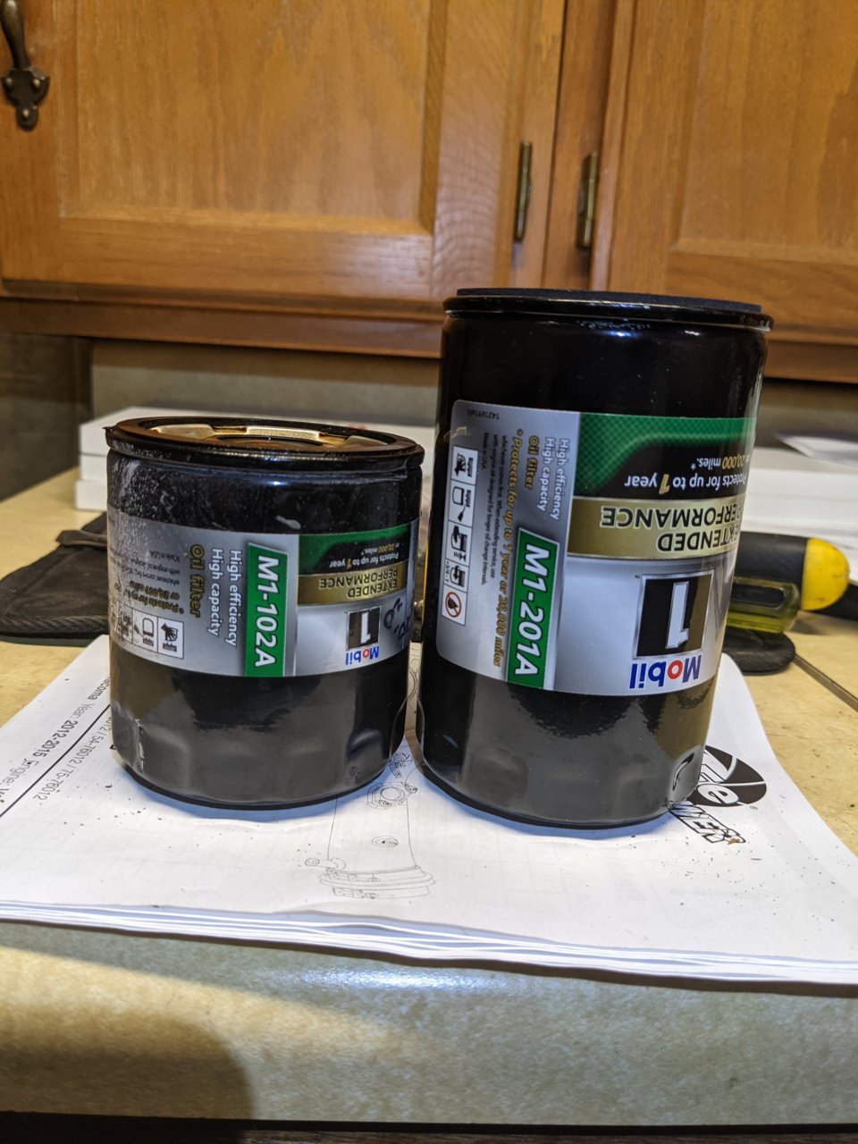

    For you dyslexic folk, m102a is not the same as m201a lol. Hoped it would fit after I noticed but it does not :-(

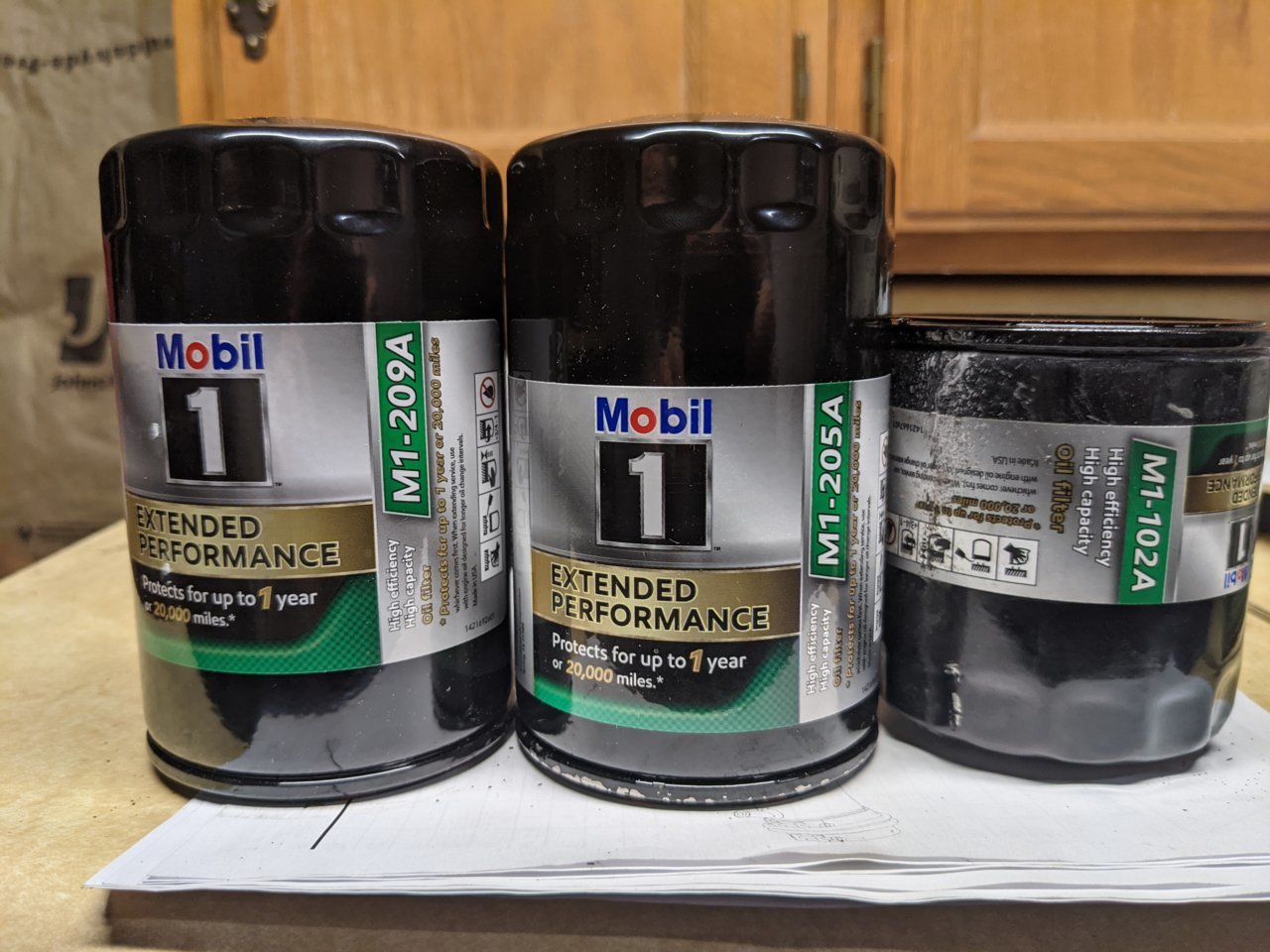

    Went back and they were actually out of m102a. So I bought m205a and 209a. They both fit! But what's the difference between the two? Same height and diameter. Just noticed the 205a has a dented top so going with the 209 I guess...

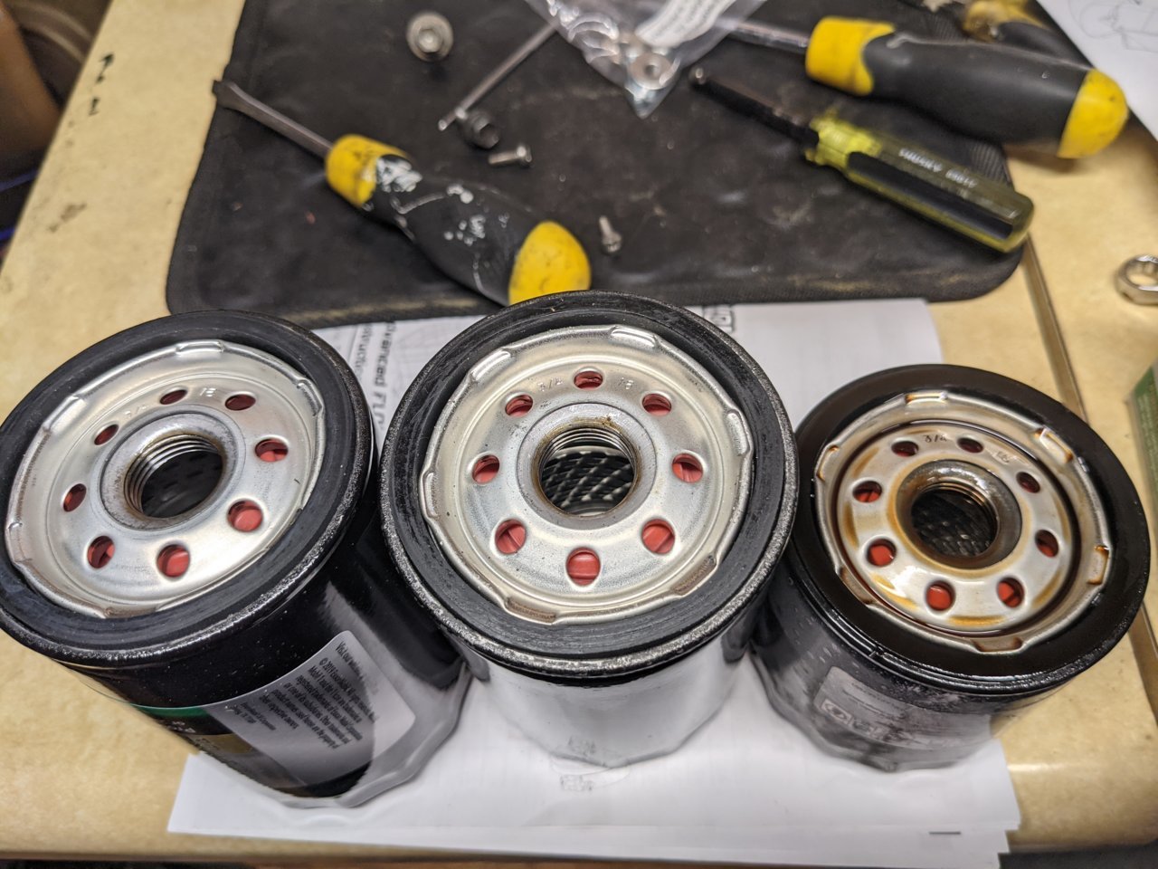

    All printed with 3/4 I6 on the top. The 201a was 1/2 MM

    Oil Filters
    Fits: M1-102A Chrysler, Dodge (1995-11), Mazda (2011-15), Ford 4 cyl. (2003-19, Toyota (1987-2019) - Stock Size
    NO Fit: M1-201A GM Products (1980-05), Isuzu (1997-99) (GM 25012760) - Larger Than Stock
    Fits: M1-205A Audi (1970-06), Volkswagen (1974-15) (Volkswagen 06A-115-561B) - Larger Than Stock
    Fits: M1-209A Chrysler Products (2002-09), Ford Products (1971-09), Jaguar X Type (2000-08), Mazda 6 (2009-13), CX9 (2007-15) - Larger Than Stock

    Purolator makes an extended filter that fits perfectly. I'll get you the part# in a few

    Just a tad bit more filter surface and oil capacity. I think the oil canister takes a couple milliseconds to fill as well even with the internal anti drain valve so cranking seemed take a couple revolutions to start-up. I used to run the larger Denso but have switch to the 102a and find that she starts up easier or so I've convinced my self.
