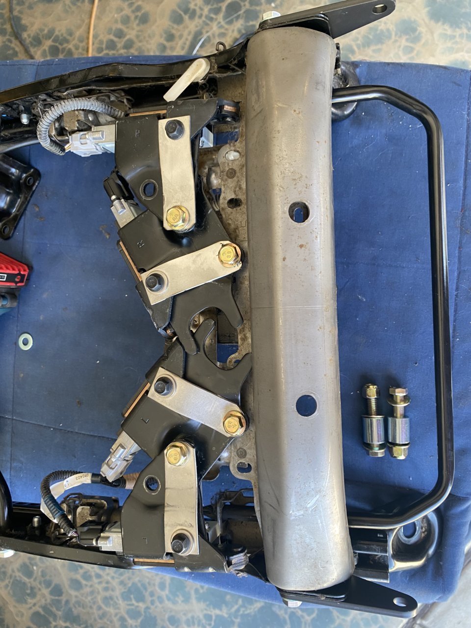

    Its pretty easy to do and effective. Just remember to mark which sensor goes to which plug, they are all individually calibrated and if you swap lefts and rights for example, they will throw codes. I pinched mine in a vise while I made brackets to hold them, you have to put a little more force into them then you think. Also, for my 2007, I was able to turn the seat belt chime off by "programming" the vehicle kinda like resetting the oil change light, but it involves plugging the seat belt in that you want to deactivate the chime on.

    how did you test it was pressed enough? I thought I had them but still not “ON”

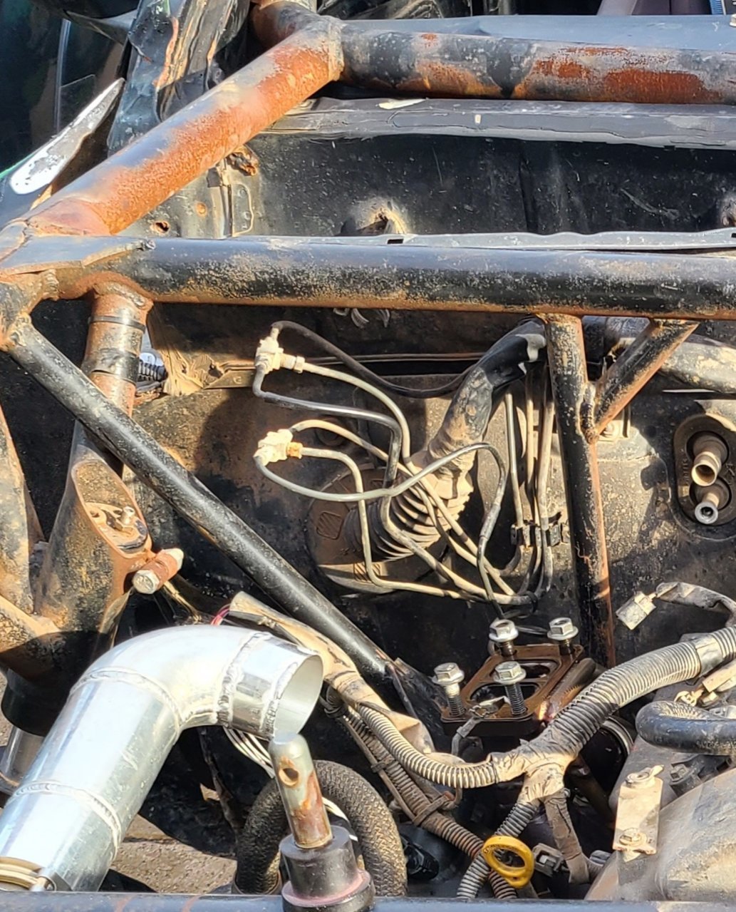

    Gave up on bending and bending. Firewall to front core support is all soft lines now. Woot!
    Should have seen the PreRunner brake lines. Spaghetti.....

    That's how I tested. Put it in once, they didn't show occupancy, cranked on them again and reset the brackets, then whoa-la it worked.

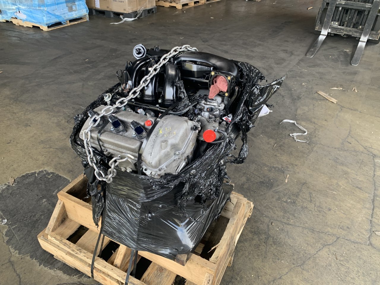

    this engine seems pretty damn clean. the connectors, injectors, coil packs, fuel rail, and anything else i can see from the top is clean as fuck. will pull the rest of the wrapping off tomorrow. need to make sure the oil pans are sealed up and are the correct ones and not the xrunner ones. wont be able to get it installed till the weekend of the 9th. going to yakima for training this friday :rolleyes:

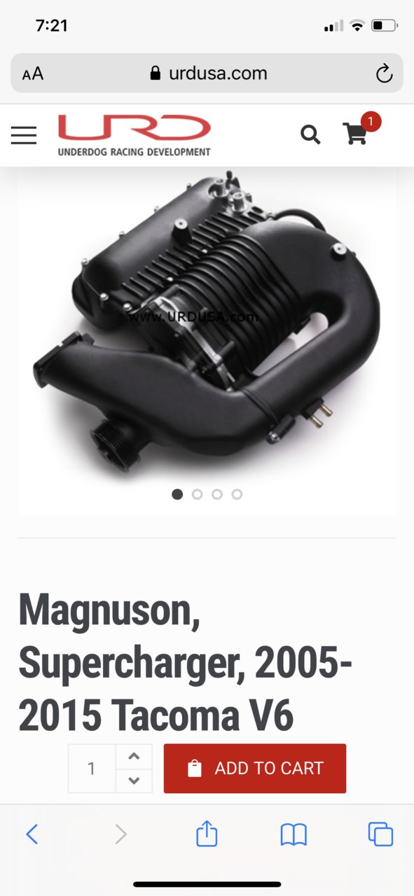

    Any reason not to get the magnuson? Need to be able to pass SMOG, which I believe rules out the procharger.
    This has been in my cart for a couple days but I think it's time to make the purchase.
