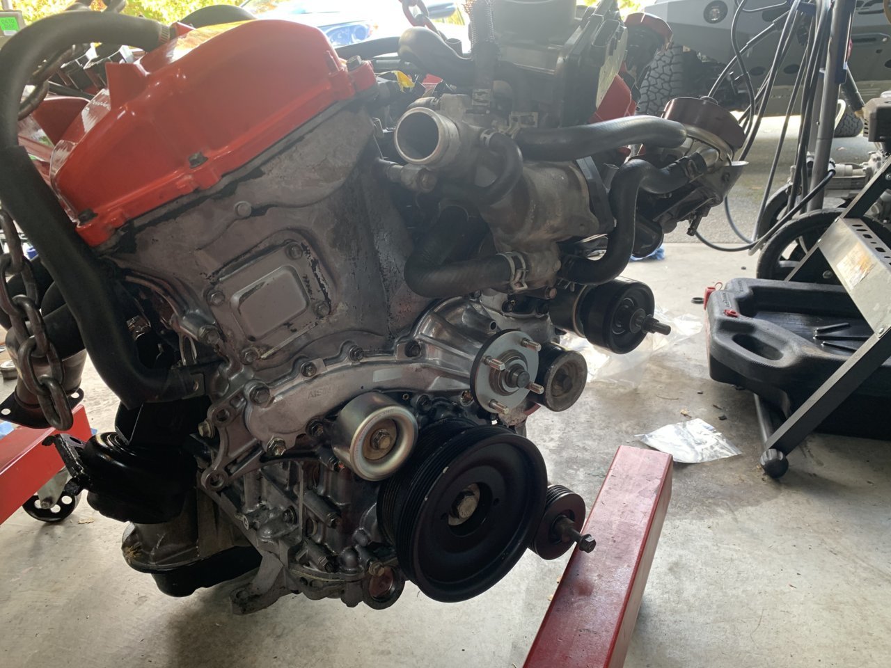

    They are powder coated. I’ve had them this way since 2013.

    Got some more things added and all that’s left to do now is mount it back in the truck and then mount the transmission and tcase
    not pictured is the dipstick tube. But I painted it black too.

    And every bolt has been torqued to spec. Putting that heavy ass flywheel on was easier than I thought it would be. Put new oem studs and nuts for the headers. Dropped lower pan and it was extremely clean. Looking up at what I could see everything seemed good.
    Would running seafoam through the oil be a good idea or help in anyway? Plan on changing the oil in 500 miles anyways.
    Hopefully nothing leaks.
    Also found a crack on the old engines upper oil pan from a bolt. Probably from sealant busting through. Would explain the oil lean on that side.
