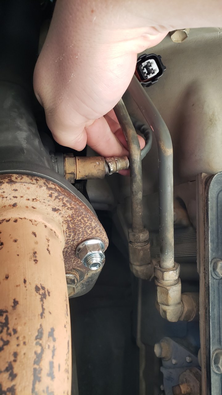

    So ive got an issue, my upstream o2 sensors are being blocked by the transmission coolant lines on the passenger side. I've attached a picture of the old one that I had to cut in half to remove. My buddy who was under the truck for the install I assume just forced them up and the wires got stuck between the lines and the sensor melting them so they needed replaced anyway. If anyone has any advice for how I can fit the new O2 sensor I would be forever thankful lol

    I just bent that trans line out of the way.
