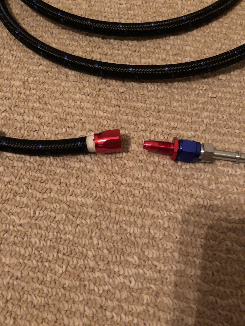

    Take the tape off. Then lube the inside of the hose, as well as the fitting.

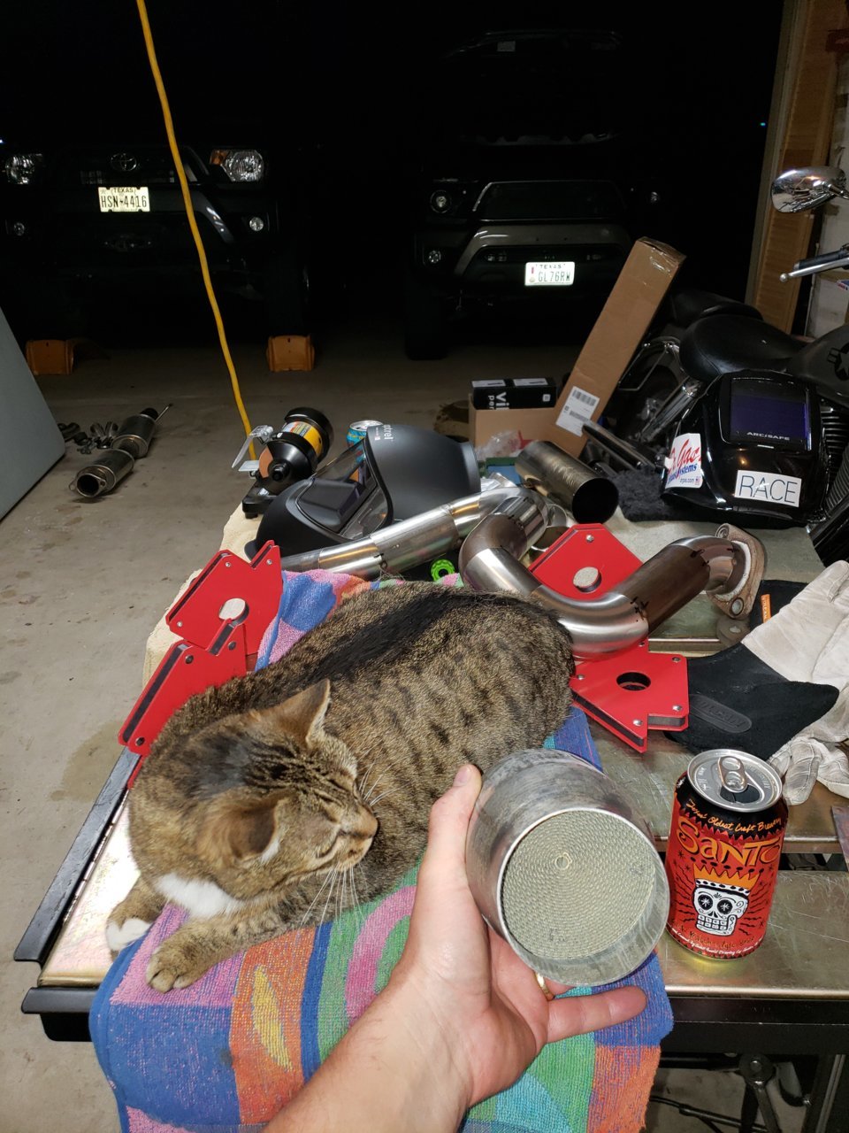

    The buzzing I think is from non equal length y-pipe. It is the only reason we are modifying @loginfailed's exhaust. Yes we are adding the high flow cat as well. I already have one on mine.

    Back to welding @loginfailed's exhaust.

    @ThomasMore66, you'd know if you were here! He didnt have any cats prior to today. After today he will have one Magnaflow metal spun high flow cat. The stock o2 sensors have a URD extension harness so they can be installed in the collectors of the headers. You will have a cel unless you have an o2 sim, UCON, or some other method to trick the ecu into thinking the cats are still there. Maybe OVTune can turn the code of as well but I'm not sure.
