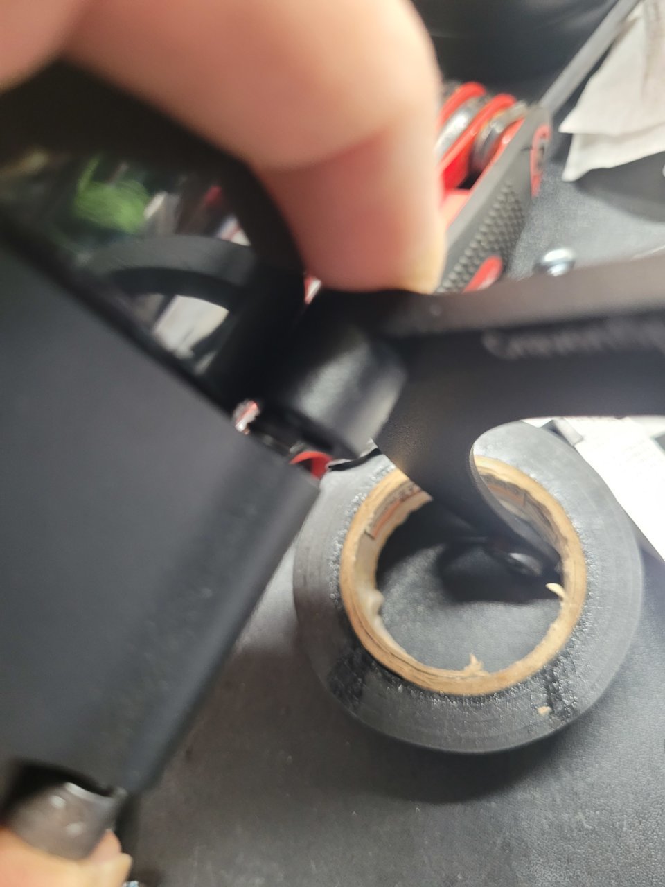

    So I can figure out how to get the gauges on the pods but the gauge hits the bracket that ties to the column. Did you have to do anything fancy there?

  9. Oct 29, 2021 at 11:13 AM
    zerotimeouts
    zerotimeouts Well-Known Member
    Sep 26, 2016
    #198300
    1,448
    Nor Cal
    2011 DCSB 4.0 S/C
    you might be able to use some
    Electrical tape and use that to friction fit. Adjust wraps as needed. I had to do similar on another gauge setup.
  10. Oct 29, 2021 at 11:15 AM
    zerotimeouts
    Sep 26, 2016
    #198300
    1,448
    Nor Cal
    2011 DCSB 4.0 S/C
    Try a longer bolt and washers in between pod and bracket to move the pods forward, maybe?

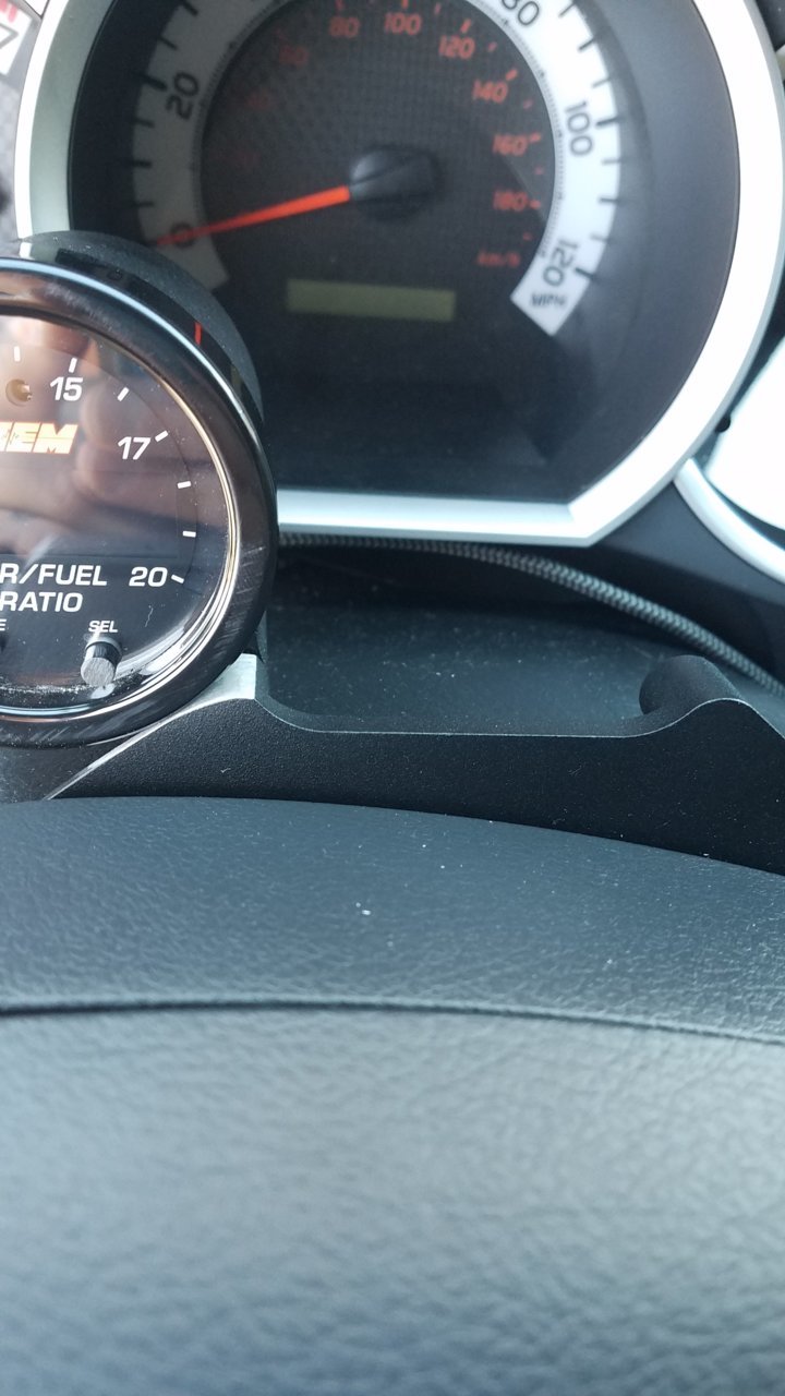

    Did you have to grind down the bracket? I can't get this bolt on to bolt the pod to the bracket. It's about 1/16 off

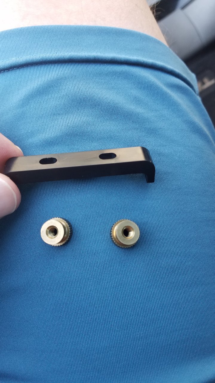

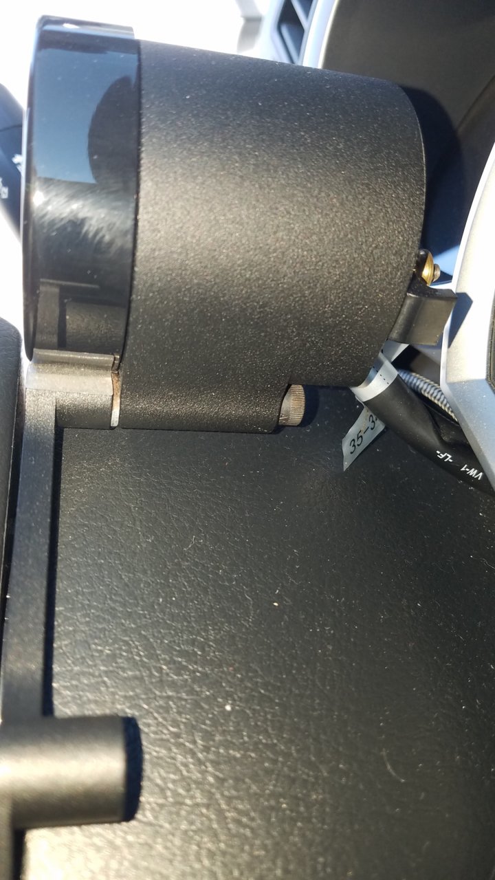

    @happyabortion just took it apart and here's what I got:
    First I had to grind down the bracket in order for the gauge face to fit. You can see it under the gauge, the silver bit.
    Then I had to extend the threaded rods to reach behind the pod
    Then I added a washer to push the pod farther away from the steering wheel, as well as sand down the buttons. 20211029_112629.jpg 20211029_112711.jpg
    This is the bracket and nuts I used on the back side

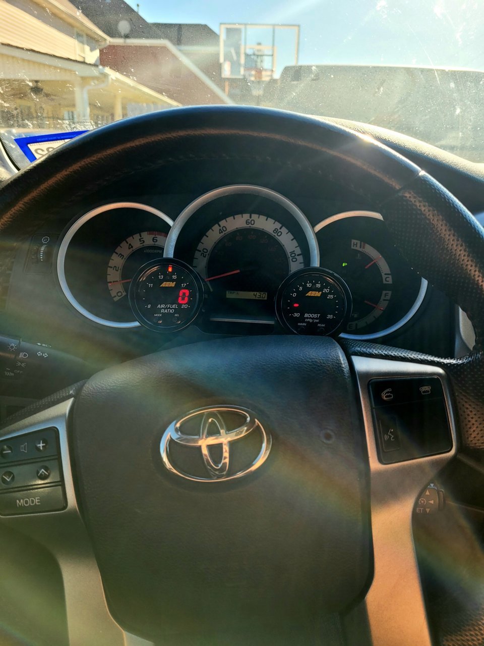

    Grinded that bracket and I also had the buttons rubbing the wheel. I got a couple of washers and had to grind one side flat to get it to fit with the gauge to push the pod back and it was enough to clear the buttons.
    Thanks again for all the help man I appreciate it!

    Looks good.
    Welcome to the Boost Crew.
