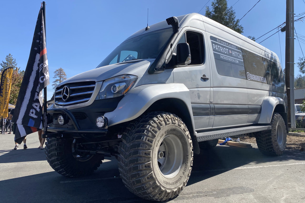

    I would so drive that! I'm certain I'd hit the roof at Sonic, but it's just redneck enough in a European sort of way...
