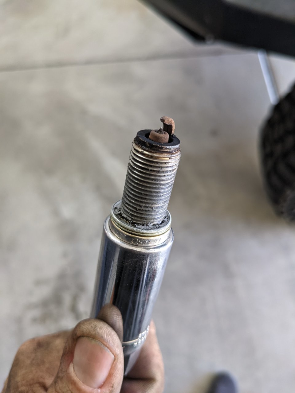

    It’s night and day difference with new spark plugs especially for boosted engines.

    When I swapped mine out on the truck they were roasted. Mine was in the mid 60's (pretty sure they were not changed around 30k)

    All 6 plugs looked like this when I pulled em. They had 40k on em.
    12TRDTacoma[OP] likes this.
