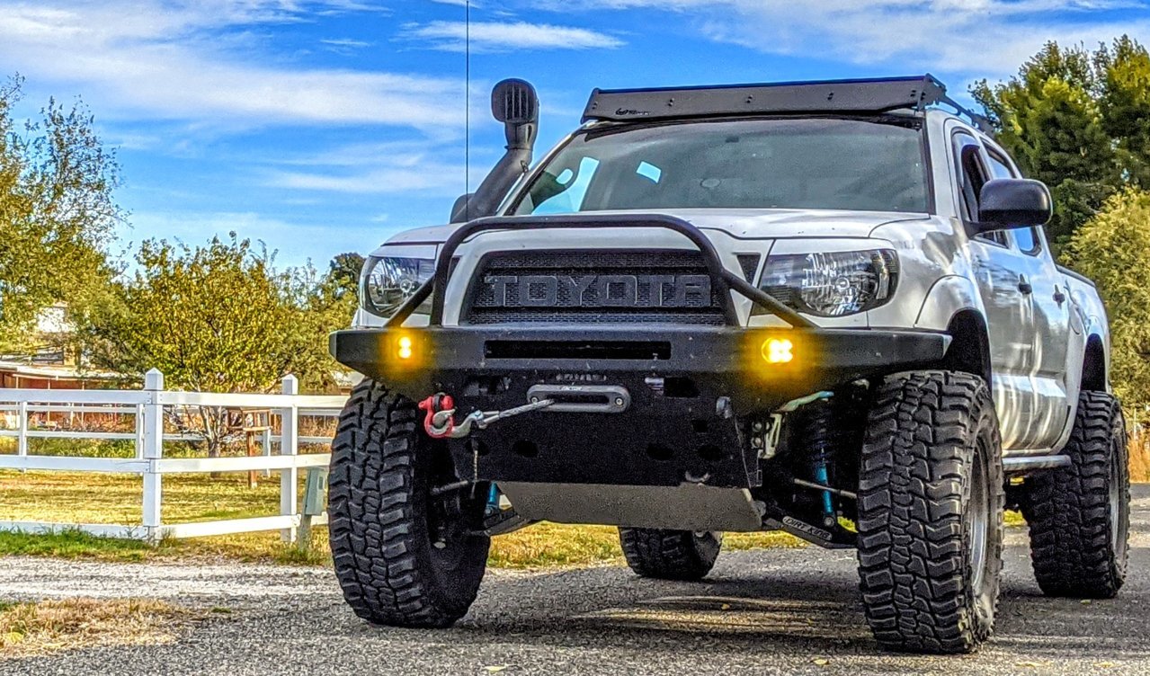

    Excuse the shit video quality. Just left work and my phone is always oily from my damn hands. Captured the issue I've been having pretty good.. but didn't get as long of a video of it after the ABS Killswitch was toggled (everything off). I tested throughout the drive home toggling the switch and got it to repeat both off and on.
    This is how the truck sits now.. pretty heavy and rolls (no sway bar). Does it on turns, Straights, Digs, Rolls, etc.. Doesn't matter. Did it before and after 35s too. I've recalibrated the VSC a couple times throughout the years.

    You know I wonder if these issues you guys are having has to do with the fact you guys run larger tires and it messes with the Trac/abs sensitivity inputs just enough to cause that hesitation. I run a setup similar to you guys (modded suspension all that fun junk) but I've never had that issue. I'm starting to wonder if the tire size plays more of a factor into the traction control program to the point where that is the issue for a good handful of you having the hesitation issues.
    This is actually a really good data point for the thread.

    I never would have thought to correlate the two... But that's why I'm not good at this stuff. lol
    It did do it prior to 35's.. but, that (tire weight) paired with just the extra added weight/rolling mass in general.. maybe?
