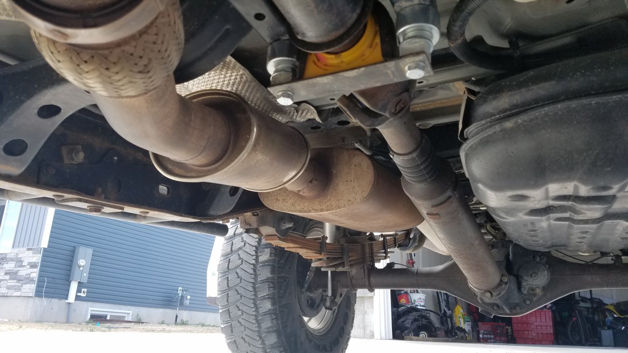

    Exhaust system with glass pack at the end. Looking for options of where I should put a high flow cat in it.

    High flow cats should fit on either side of the trans or transfer case, in the straight sections.

    I wish! But I love the mountains. And I love my job most days. Lol is this something you think the Ucon could fix?

    And if I can get my AFR right I should cook/blow them out right away. Do you suggest the magnaflow or something from Vibrant? Thank you for all your help!

    Yes, the UCON could fix it. As it basically always is in Closed Loop. Thus it will always strive to maintain the proper AFR for the conditions.
    AFR's being correct, a high flow cat will last a lot longer. Look for the differences between the ones sold by Vibrant and Magnaflow. They go by liter size and OBD compatibility. Get the ones which best fit your needs. Keeping in mind of the increased flow due to the s/c.

    So the Ucon doesn't tune for open loop at all? Well shoot, because in closed loop it does good. It is just when I mash the gas and go like hell. Lol and when I am towing it is in open loop alot. Another question about the Ucon, can it be programmed to lock up the torque converter full time in 2nd, 3rd, 4th, and 5th gear?

    The UCON always runs in closed loop even at WOT so there is no need to tune for open loop.
