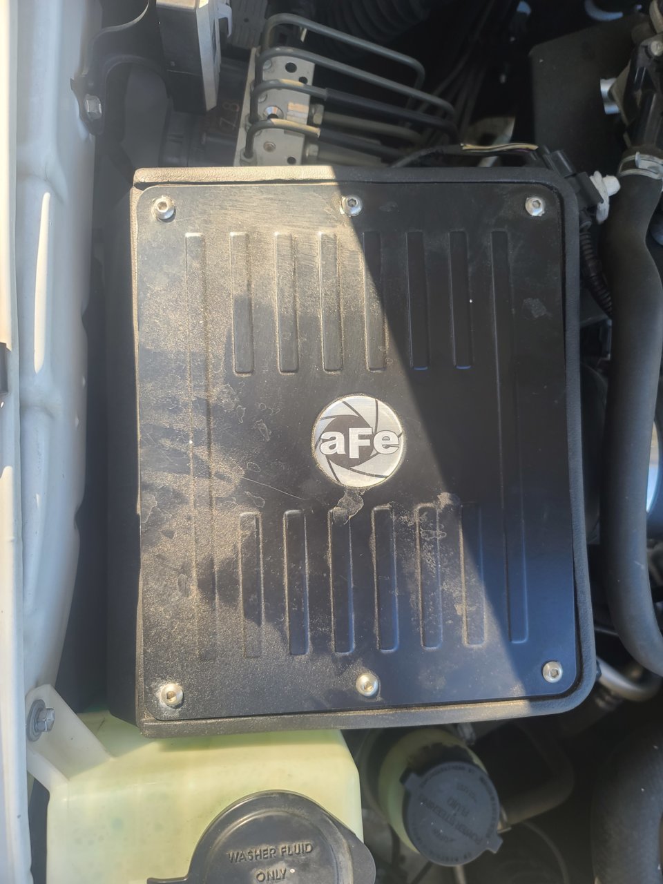

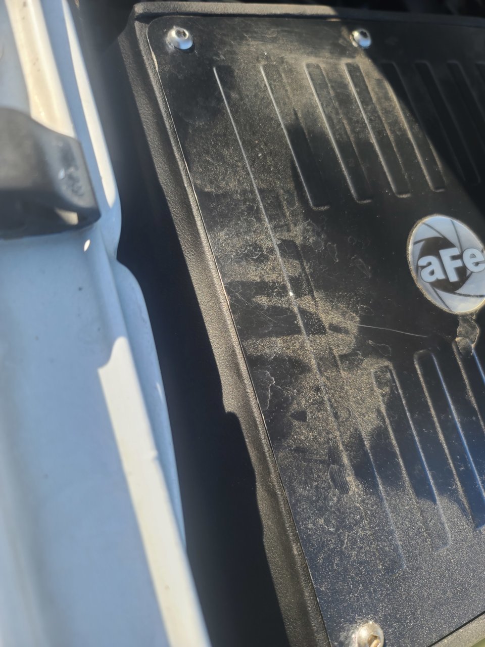

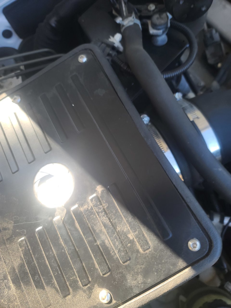

    So I got a afe intake and the fit with the s/c is really tight and deforms the box a little bit but I feel like it makes the box not airtight. Any tips on how to fix that? 20211114_102544.jpg 20211114_102542.jpg 20211114_102539.jpg

    Trim the intake tube at the throttle body end a touch to shorten the tube and relieve that pressure on the airbox.
