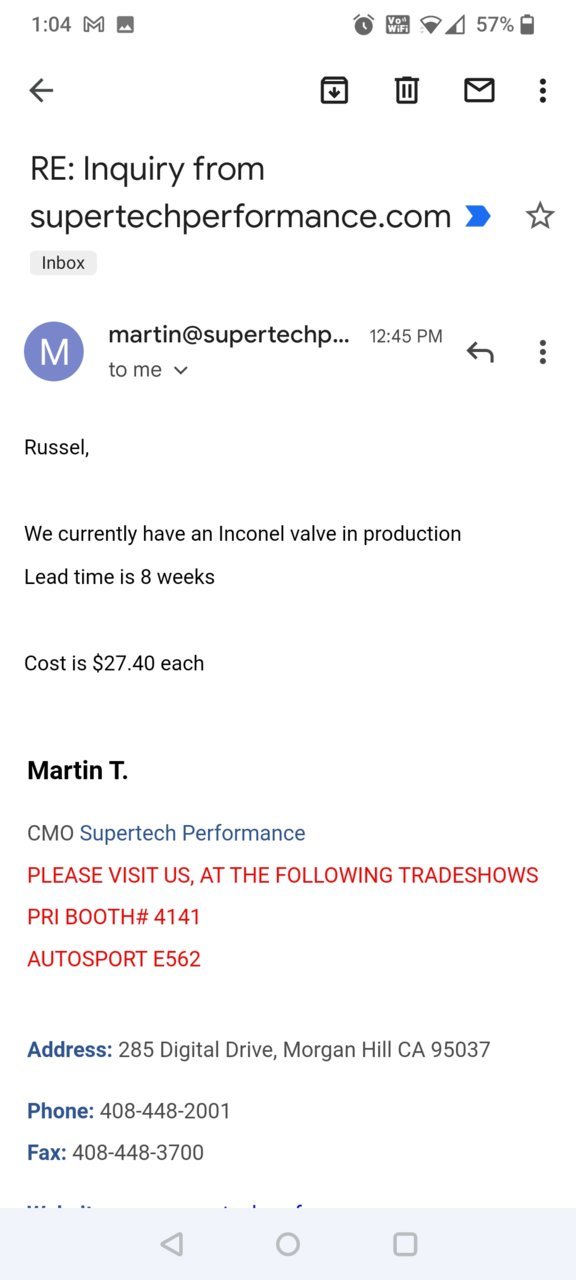

    Supertech make inconel valves. I say we ask for some exhaust valves in this style. ;)

    Yes please. With pictures.

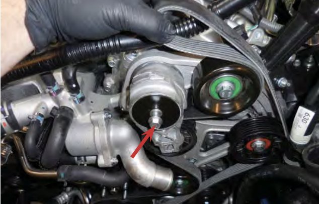

    Yes, mine was hanging over the pulley about 1/8”. I went with a longer bolt (I think the one that came with the roush) and a washer to space it properly. Now mines right on the edge, but it’s been solid for me with the stock tensioner pulley

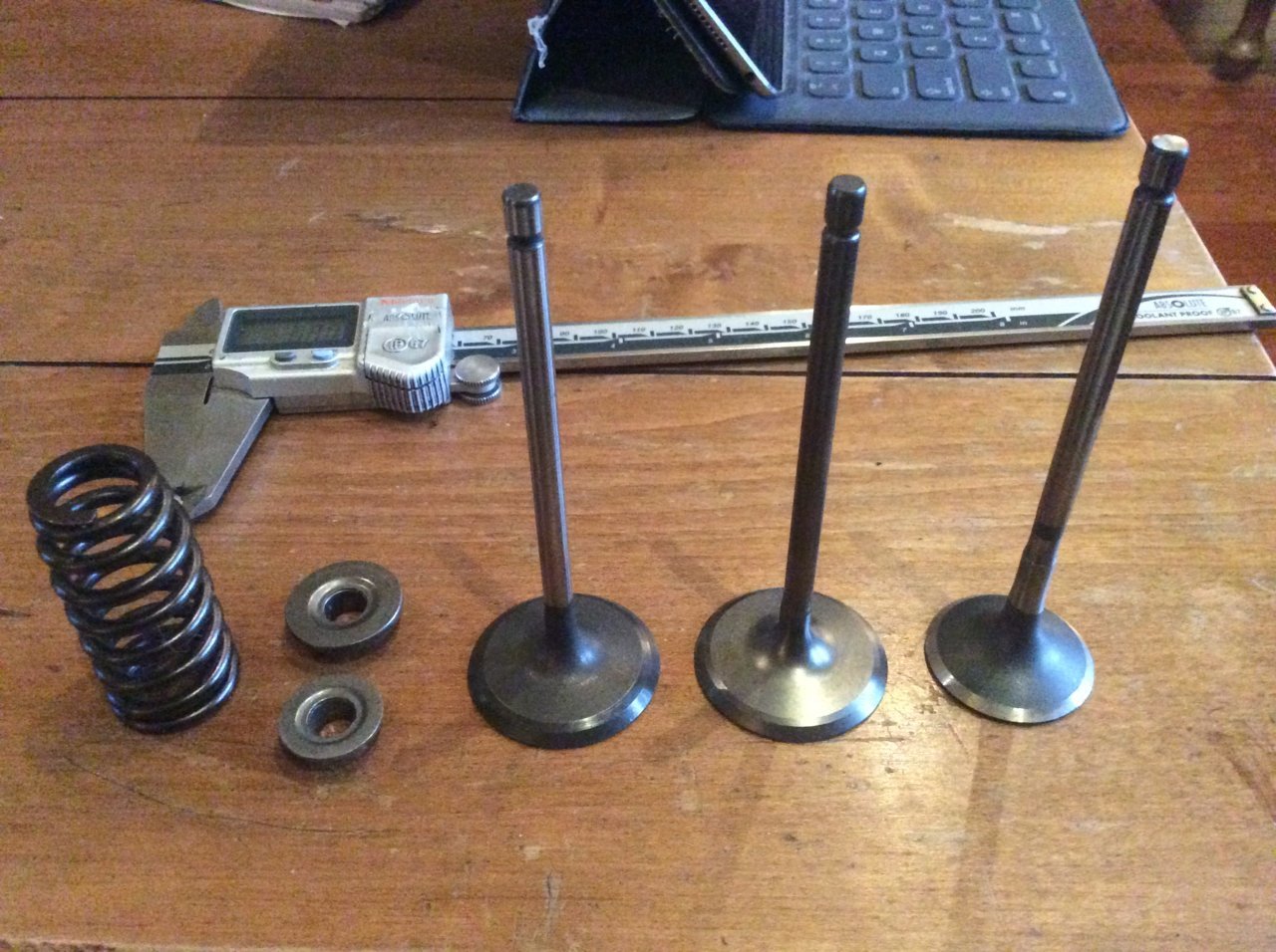

    Intake 105.85 overall 98.4 to the bottom of the keeper groove
    Exhaust 110.4 overall 102.68 to groove
    Ti in the middle, exhaust on right.

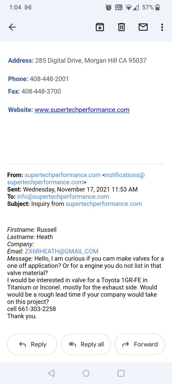

    Well, I got this email.

    need some tool advice- ive never owned a 1/2" drive that fit correctly to release tension on the s/c tensioner. every one either had a bulky head that gave me fits on the fan blades or had interference issues with space for other parts. ive borrowed them in past uses but tired of that. good length is important as ill be doing this myself. im not afraid to spend money on a quality tool. but i will have a custom one made if the answer is a 400$ matco.

    i generally just use a breaker bar. and the only one i have is a 3/8 that i put an adapter on

    my g
    my fan center ring always gets caught on the head. tried a breaker but could never get correct clock timing. maybe a 1/2" ractchet with a bent lever bar?
    my tq wrecnh can do it but its a bastard to get on and off.

    Dude the GearWrench one is amazing. It used to be only $50, not sure what it’s worth today.

    I've got one that looks like this. Cheap and works great and have it stashed in cubby under rear seat at all times.
