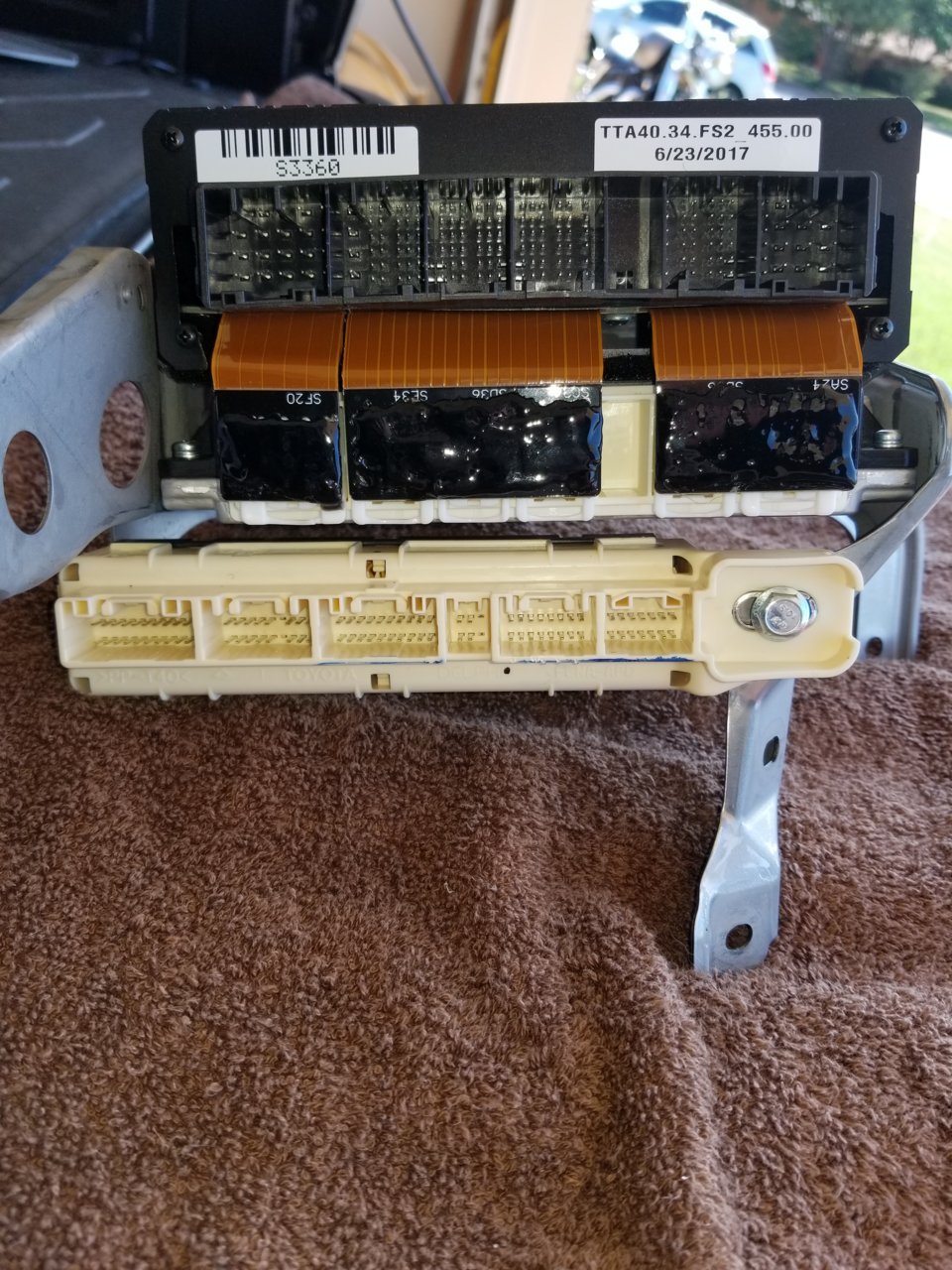

    If the UCON makes the truck run in closed loop all the time, why would my UG ever show "open loop" in the top corner?
    (honest question, not any sort of call out to be proven right/wrong). Do you think thats part of the UCON trickery on the OEM ECU at play a little?

    im guessing that the ECU is actually in open loop but the ucon never is. the ucon feeds the ECU what it needs to be happy. the UG is reading from the ODBII port which is tied to the ECU and sees the ECU in Open Loop. atleast thats my understanding of it

    UCON works by feeding false info to the stock ECU. This way the ECU still thinks its running the show.

    Do you remember plugging in all those connectors from the UCON to the ECU? Not being mean here, giving you to details.
    The UCON plugs into the factory ecu, then the factory harness plugs into the UCON. So factory signals HAVE to pass through the UCON before being sent to the factory ecu. The UCON simultaneously controls ALL engine parameters, and sends false "happy" signals to the factory ecu so it doesnt know it's being f%^&*ed with.
    Your Ultragauge is connected to the obd2 port and that is fed by the factory ecu. Since the factory ecu is being fed false "happy" signals from the UCON, you are seeing the false happy signals, not the true signals the UCON is commanding.
    Make sense?
    P.S. The UCON is always in closed loop, therefore it is always CONTROLLING afr from idle to redline.

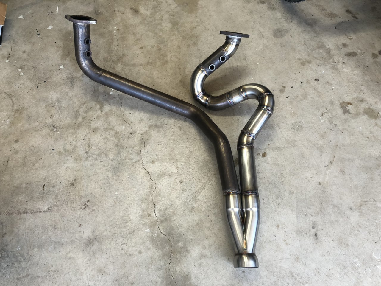

    Yes, as of an hour ago. Time consuming project but I knew that ahead of time.
    Got to meet and hang out with the legend that is @loginfailed for the weekend. Had no time to relax and chill but I think he is pretty damn happy with the results!
    For @loginfailed the purpose of this project was to change the annoying buzzy sound inherent to an unequal length exhaust system but the performance benefits are huge when you complement the equal length headers with a properly tuned length y-pipe. This effectively makes the header a 6 into 2 into 1 system (he already had the URD equal length headers, URD Y-pipe and mark III exhaust, plus two Vibrant ultraquiet 1142 resonators).
    We made the y-pipe equal length, eliminated one resonator and added 1 high flow 3" cat. Preliminary report is very positive. I'll let him review when he gets more mileage on it.

    Great to get to finally meet and hang with the great @Roostfactor over the weekend. The man smokes a mean brisket! We basically spent a full two days working on the y-pipe starting early in the morning and working late into the night. Can’t thank you enough, John!
    Special thanks to Mrs. Roosfactor for letting me stay over on Saturday night since the truck wasn’t drivable and allowing me to pretty much hold John hostage in the garage for 48 hours. Super sweet lady.
    I did about two hours of sleepy highway driving last night and it is SO MUCH QUIETER than before. Looking forward to driving it a bit more in different conditions to see how it sounds and performs.
