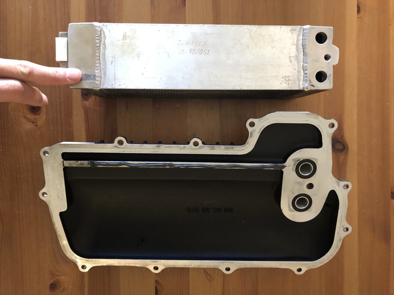

    Anyone have photos of the intercooler lid underneath so I can visually see where the seals/foam strip/o-rings go as I plan to tear into the engine bay in the next few months and queue up my parts orders?
  12. Nov 28, 2021 at 9:35 AM
    Sterling_vH111
    Sterling_vH111 Go do something real instead.
    Oct 4, 2015
    #165793
    2,987
    Sterling
    socal
    2012 DCLB Prerunner V6
    Secretly Long Travel & Supercharged
    The o-rings are in a groove on the lid itself. There is also a bead of some rubbery sealant that is in between the intercooler and lid, it's stuck to the lid in this picture.
    In the picture below, the intercooler and lid area separated like a clamshell, so the sealing rubber bead would go on the side my finger is pointed at, closer to the blower and further away from the intake ports.
    The orange foam strip goes around the sides and bottom of the intercooler, on the same side as the rubber bead / closer to the blower and further away from the intake ports.

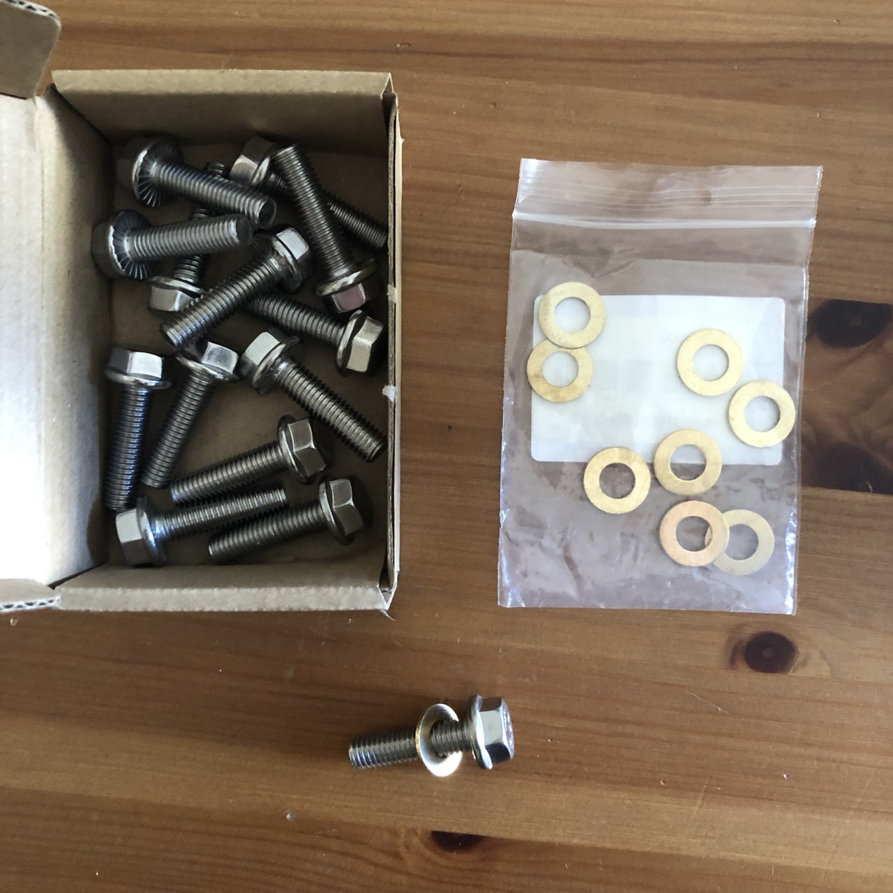

    I also have 13 extra m8 x 1.25 x 30mm stainless bolts and 9 extra matching copper washers if anyone is interested.
    The bolt head is 1/2" (IDK what came with the SC because mine was missing)
    I can throw a pair in an envelope and send them to ya.
