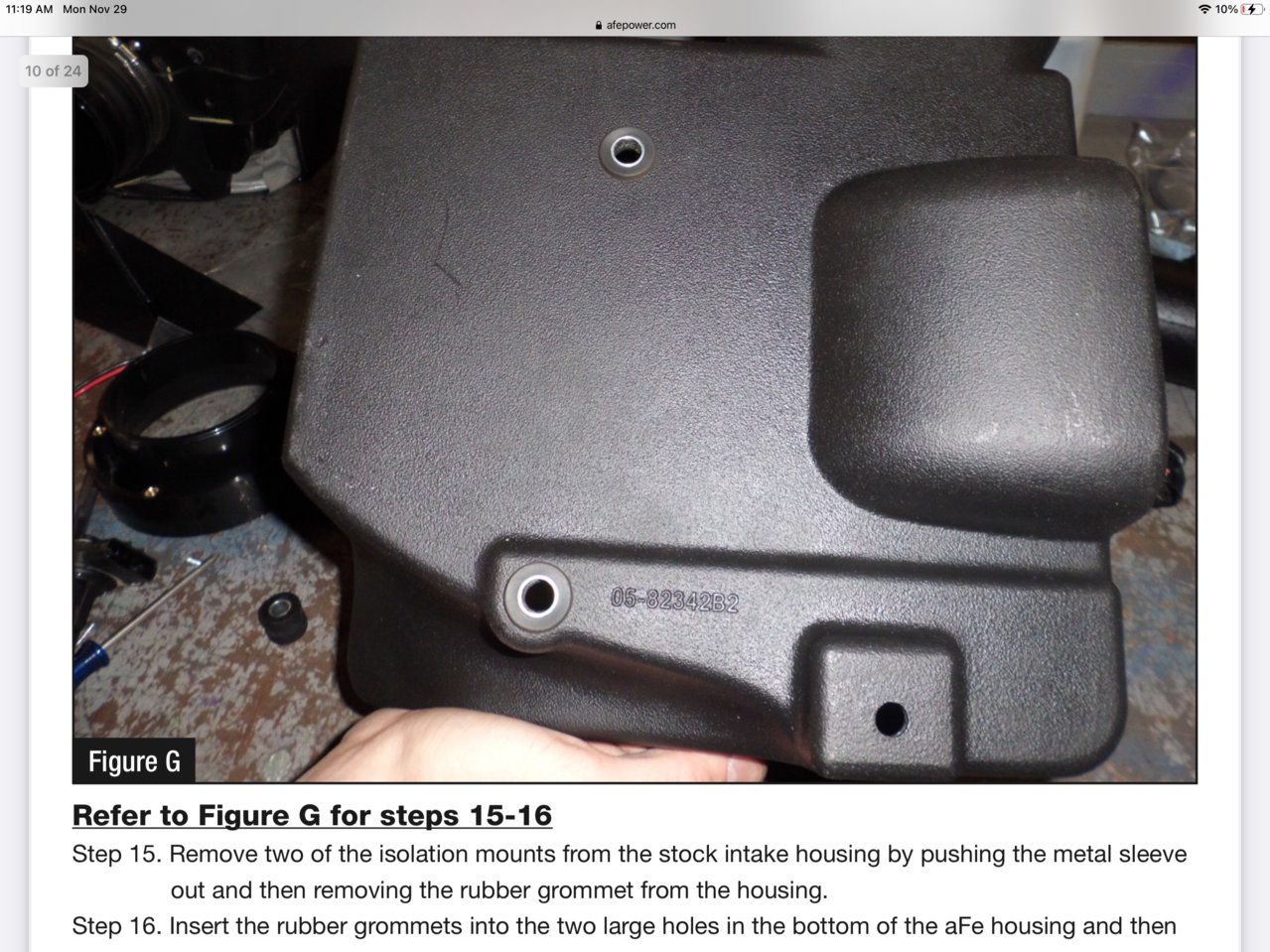

    i forgot to do that. it isnt critical imho. my airbox is fitting snug w/o those. not mission critical.

    Thanks for checking. I should be good. It looks the one I’m buying has them after all.

    My AFE Momentum GT did not come with the needed isolation mounts, and I had to steal from my OEM that I luckily still had in storage. I did need to get the MAF calibrated by @JustDSM afterwards. It didn't read lean until I removed the SAIS and then it was up to 30% off in places.

    I’m buying a used one off a member, that’s why they are there. Interesting to hear removing that stuff messed with the afr’s. I’ll be doing it in the near future too so I’m sure I’ll have to get retuned as well then.

    i have the momentum too. you would think at that price point they could supply another 95 cents of mounting hardware.
