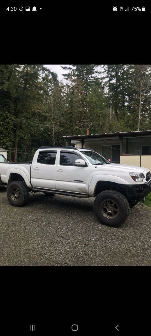

    ive got a very light bed area. no spare, at most 300lbs of tools, and very extensive aftermarket suspension. being that mine doesnt get wheeled i thought this may work well for me. and with adding more lift last week i have clearance!Screenshot_20211122-163056_Messages.jpg

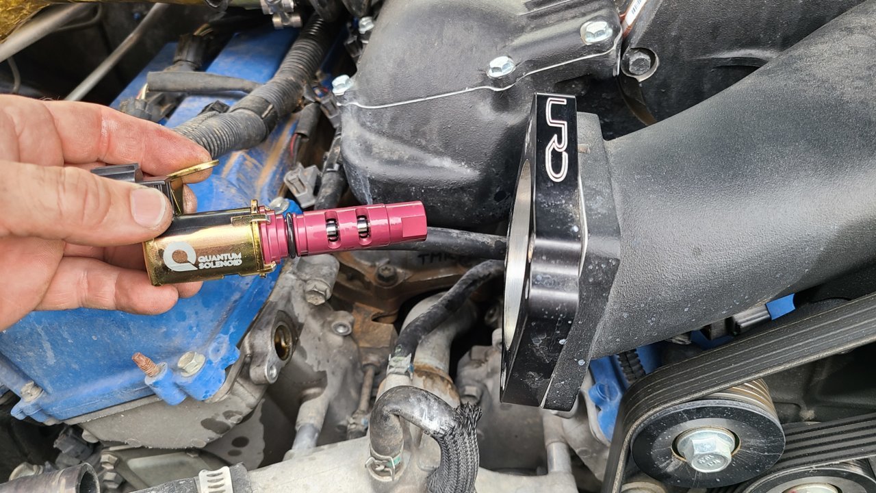

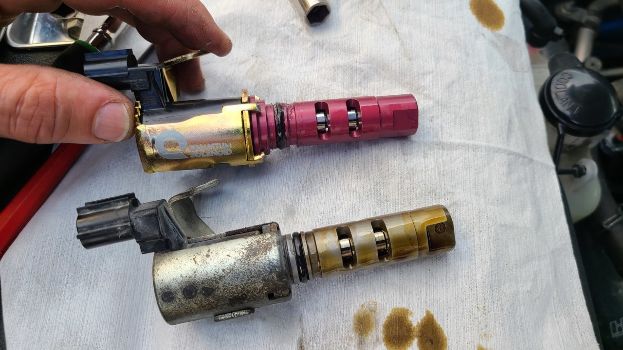

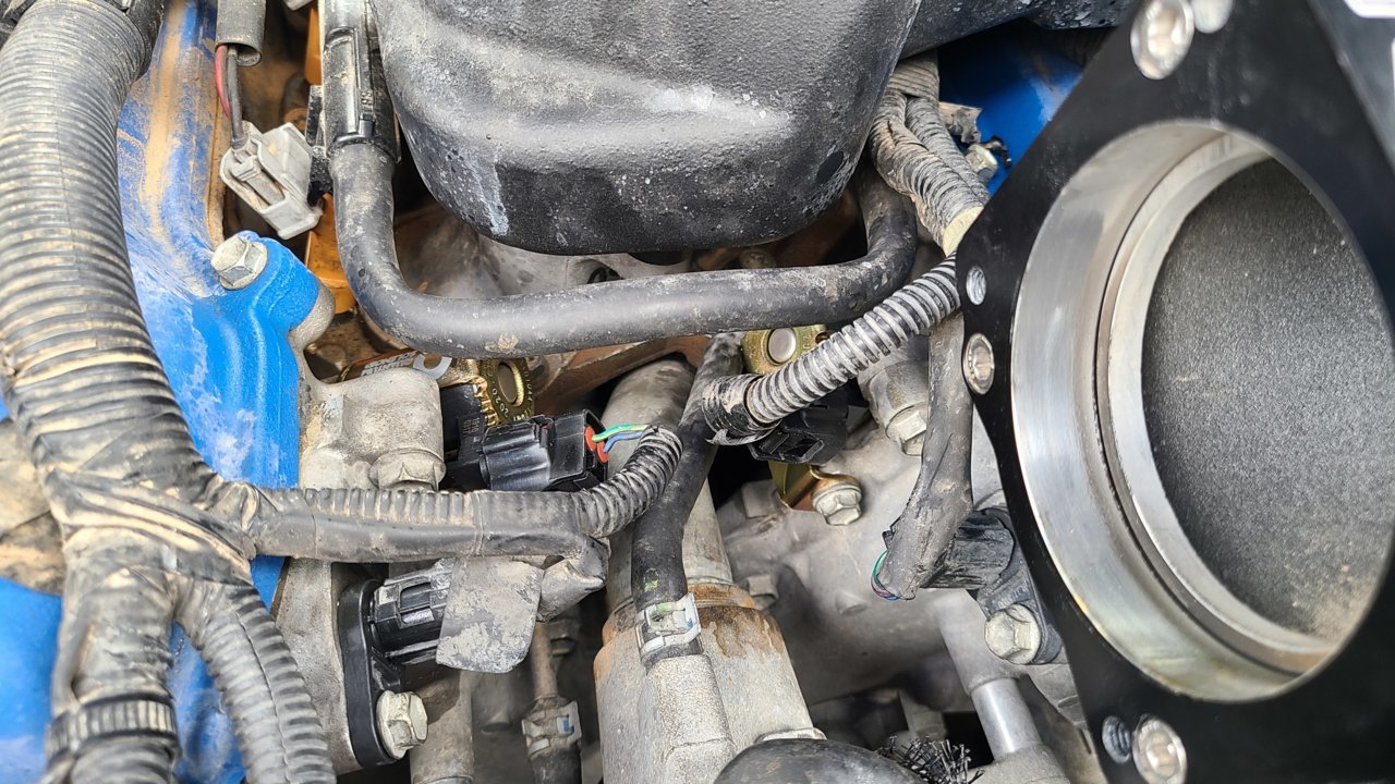

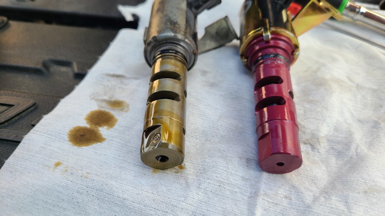

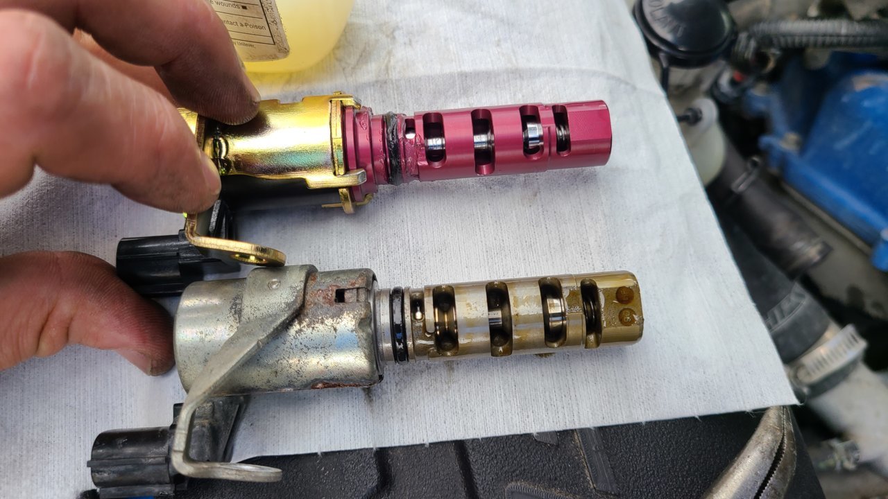

    New 1GR Quantum Solenoids installed, on @Lucario Runner 's truck. Soon to datalog, after diff install.
    20211204_113252.jpg 20211204_113317.jpg 20211204_113326.jpg 20211204_114535.jpg
