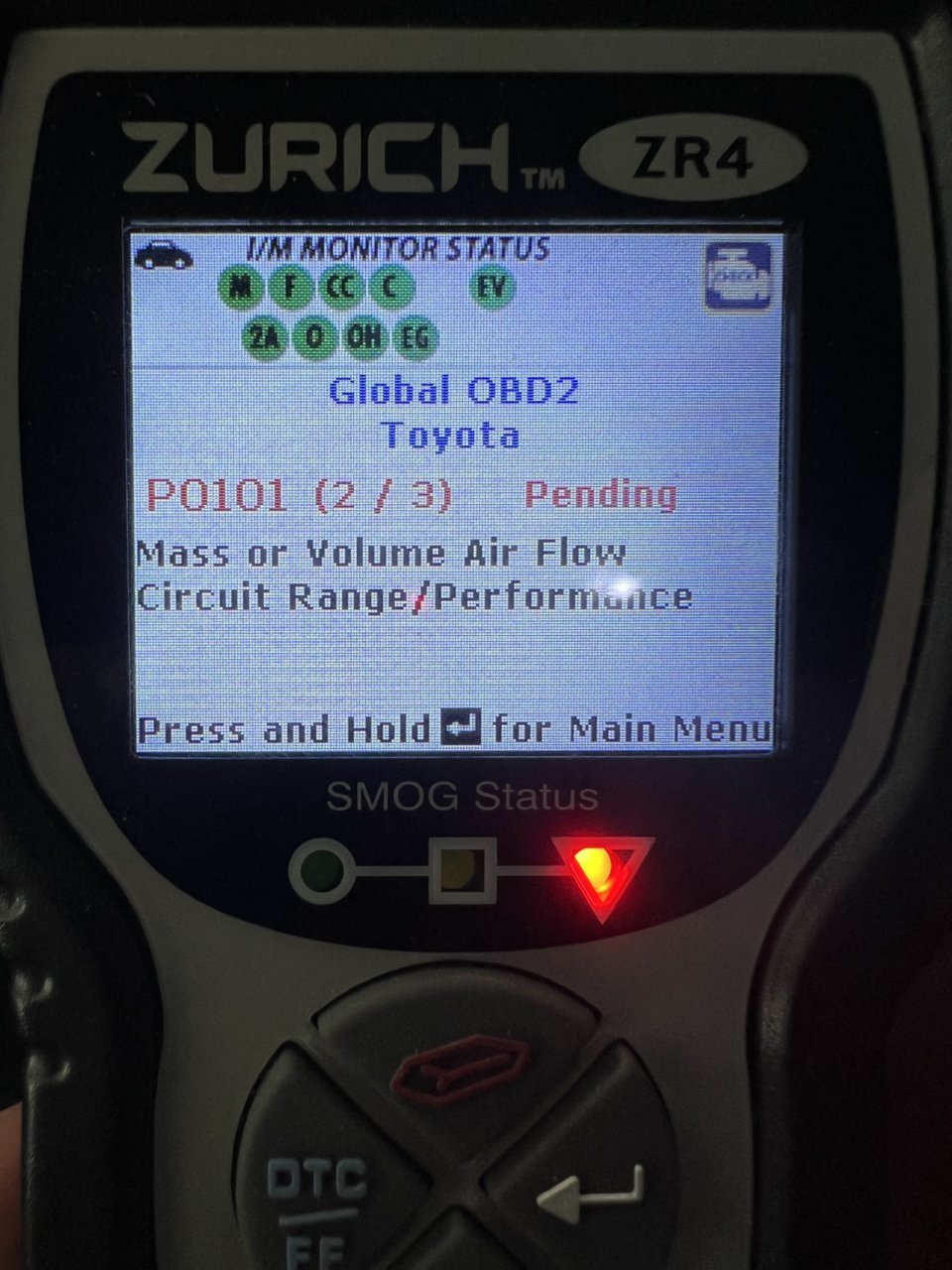

    I had TONS of issues with the URD Cai as well. There are just simply too many bends in it and the MAF sensor placement is in a fucky spot for it to perform properly. A honeycomb insert prior to the MAF would help with airflow a lot.
    You may need to perform a hard reset by pulling your battery terminals for a bit. It usually helps a lot when you are having those issues.
    Are you throwing any codes? What are your AFR's? I'd imagine you have a P0171 and P0174. with 18-22% fuel trims on both banks.

    Couldn’t say what the trims were as I was being remotely tuned. My code was the P0109. But they went away when I swapped the pulley

    You swapped back from a 2.7 to a 2.8?
    Remind me what the P0109 code is again.

    Yup swapped to 2.8 and issue went away. I’m sure my AFR is still a little off but definitely not as bad as it was. Edit….I was wrong….it’s the P0101

    Pull up the freeze frame on it and look at the MAF G/S when it coded.
