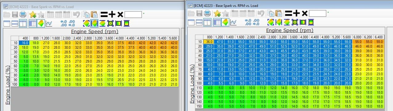

    Not that I'd really recommend this, but from the tuning perspective I think you could *in an emergency* run with the TRD S/C Tune and the belt removed. This assumes you're going to drive it civilly and not play around. The point would be to get the truck someplace where the belt or fuel situation could be remedied.
    Looking at the two timing maps of a N/A truck and SC truck, the SC truck runs a bit more advance in the lower load areas to help idle/stalling and other things. Essentially to have the engine produce more torque to overcome the additional rotational mass of the rotor pack and associated pulleys. That can be a bit much for lower octane fuel to digest, but there's a pretty robust knock control system in place that would be able to combat that. However, I would not rely on this for any long term operation. Again, for emergency situations only.
    The fueling is sufficient for N/A use or even low octane N/A use with the belt removed. So this is really a none issue. The plus here, is that your already calibrated for the injectors. Simply swapping in a N/A ECU would not be ideal as your injectors are calibrated for approximately 320cc/min flow versus the 455cc/min flow of the TRD injectors. This will have you pumping LOADS of additional fuel into the engine. I do not believe the Fuel trims would be able to compensate for this difference even under the best of conditions!

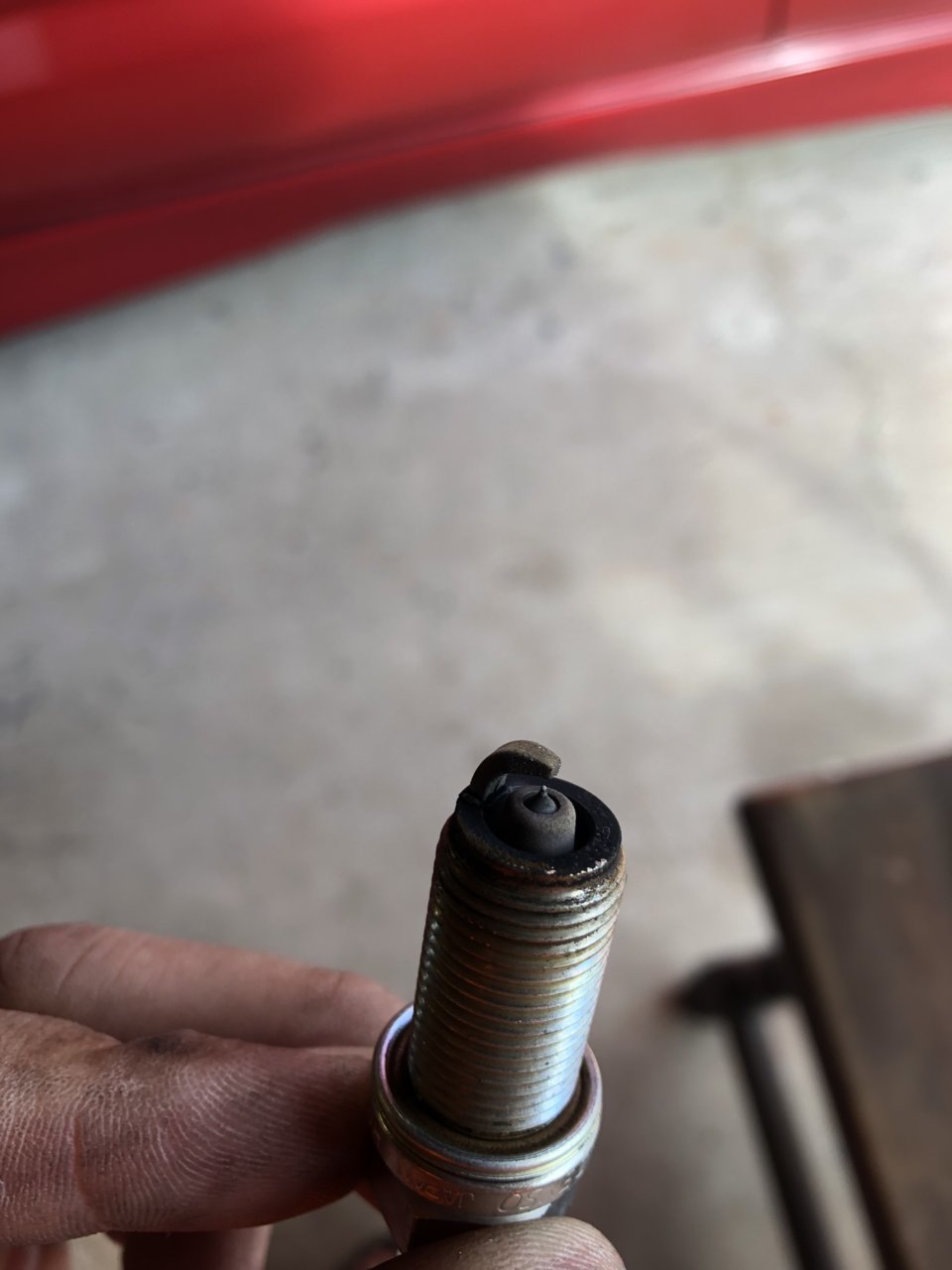

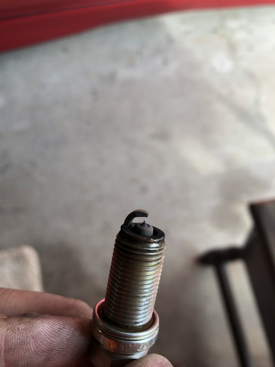

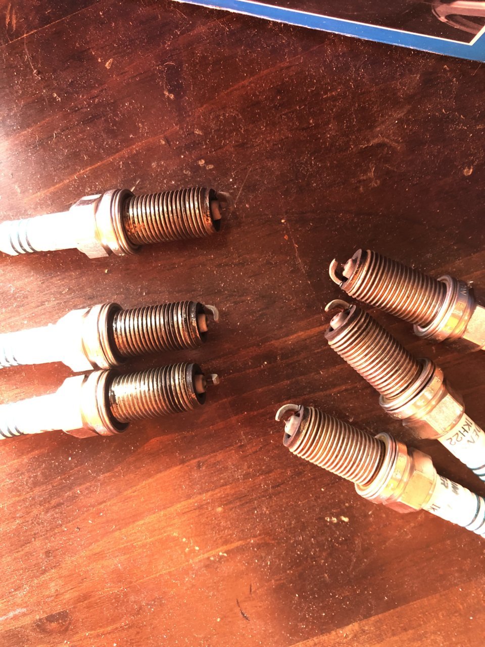

    Engine: -Doug thorely long tube headers -URD dual O2 simulator -Dual 2.5” QTP cut outs -RADS true dual piping -TRD supercharger MP90 -Custom air duct -K&N cold air intake -AFE tb adapter -AFE 76mm throttle body -URD 2.7 supercharger pulley -URD fuel pump/Aeromotive 340 upgrade -URD extension harness -URD maf calibrator w/map sensor -URD 170 thermostat -URD speed unlimiter -Cusco oil catch can -URD fuel rail tap -FPR mod -COUPE oil pan spacer w/baffle -NX wet nitrous kit 50 shot -NX 10 lb bottle -NX purge kit -ZEX rapid fire module -Greddy oil filter relocation adapter -Mishimoto oil cooler -HKS big 3 wire upgrade -Pulley wrap mod Electrical -130amp alternator -Voltage Booster Pro SPARK -Optima yellow top group 27 -1/0 wire upgrade Drivetrain: -B&M short shifter -Detroit tru trac LSD -Competition Clutch stage 4/6 puck clutch kit -Competition Clutch lighten flywheel -URD throw out bearing/sleeve kit -Sprint booster V3 -Remove clutch accumulator Suspension: -Djm front A arms -Djm welded in frame notch -DJM offset bushings -XII Performance front coilovers -XII Performance sway bars Fronts 1 3/8” Rear 1 1/16” -4" Custom Taco drop blocks -QA1 rear shocks -Air Lift air bags -Air compressor -Alignment Cam Gussets -UMI billet front sway bar mounts 1 3/8 Wheels/tires: -HRE wheels 540 step lip Front 20x10 255/35/20 Rear 20x11 305/30/20 Brakes: -Performance Brake Unlimited BBK -4 piston Tundra calipers -360mm ISF drilled brembo rotors -Stop tech stainless steel brake hoses -Brembo brake pads Exterior: -35% ceramic front window tint -Hood spacers 1" -Cut front grill -Cut hood scoop -Strictly Street RACE spec spoiler -Race front and rear tow hooks -Diode Dynamic SS3 yellow pro fogs -Race Louvers Front RSF fender trim Rear FL fender trim Interior: -Lotek dual gauge pillar pods -Ultra gauge Mx 1.3 -TRD shift knob -JunctionProduce pillow cushions (4) -Bellezza leather neck pads (2) -Innovation gauge dual wide band -Innovation boost gauge w/shift light -Air lift dual air pressure gauge -TRD racing pedals -LED lighting Sounds: -Sony XAV-AX8000 -JLaudio (2)13w6v2 subwoofer in isobaric ported box 33hz -JLaudio 1000/1 mono amp -JLaudio Evo C3 6.5 (4)co-axles -JLaudio 300/4 4 ch. amp
    3C70337B-CF79-4F6E-A26C-2267BECA163E.jpg C9942C25-F833-4CB2-B89C-6009EBAB9911.jpg 10B47F20-6C32-412A-A915-0D97AFA27A3C.jpg Finally changed out my plugs after 65k miles on them. I was putting it off since I thought it hard to do with the supercharger. Love these forums for the help.
    Truck ran and still pulled hard even with 3 bad plugs lol.
