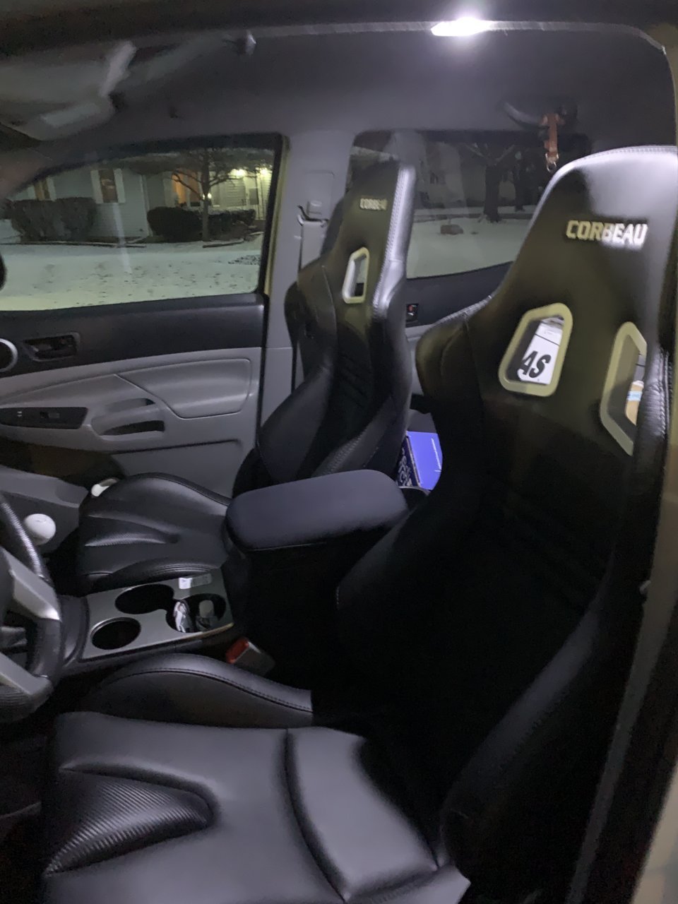

    Here ya go. I had to cut out my set sensors and clamp them together. I also followed this.
    https://www.tacomaworld.com/posts/24031859upload_2021-12-15_11-57-9.jpg

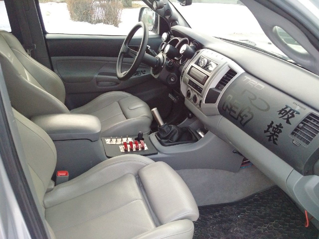

    It's awesome and a little surprising that so many people have done seat swaps. I did some 2009 G37 coupe seats. They were a surprisingly easy fit and wiring was a breeze, and proved comfortable for long drives too.

    I mainly did it for the reason of the seat height. I’m 6’1” and without the ability to lower the height, this was basically my only option. Glad I did it though too of course as these are way more comfy.

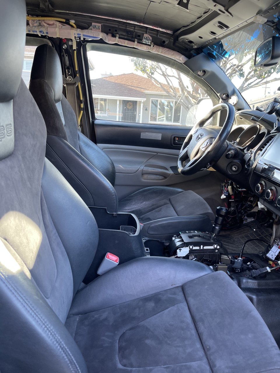

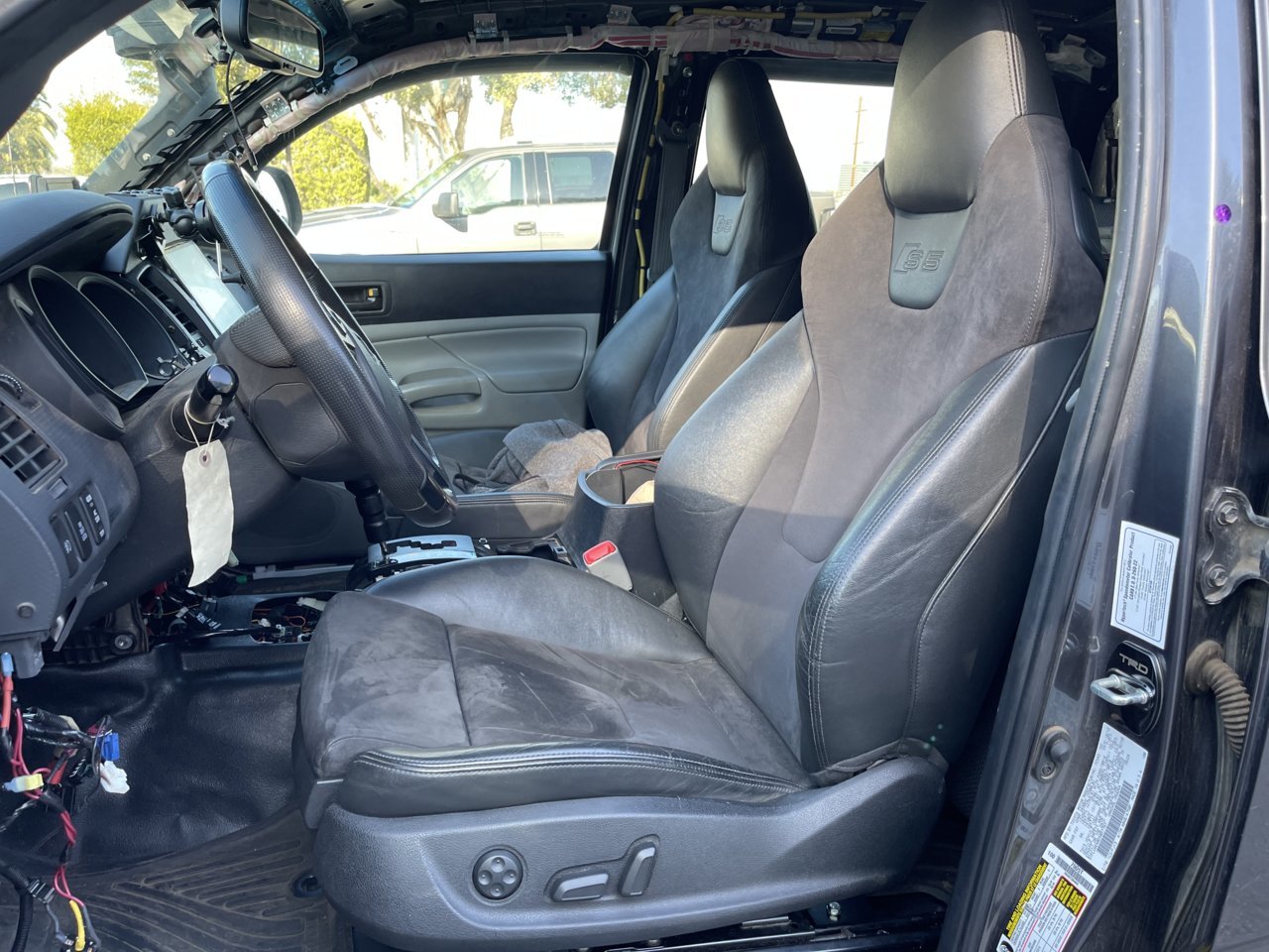

    They are mostly plug-and-play. they bolt right in and I believe the airbag is plug and play. The seat sensors are I think the only thing to adjust. but similar to what I did you need to clamp them to trick them. My retrofitted seats were around $600. (audi S5 seats). If your looking you can find some deals.

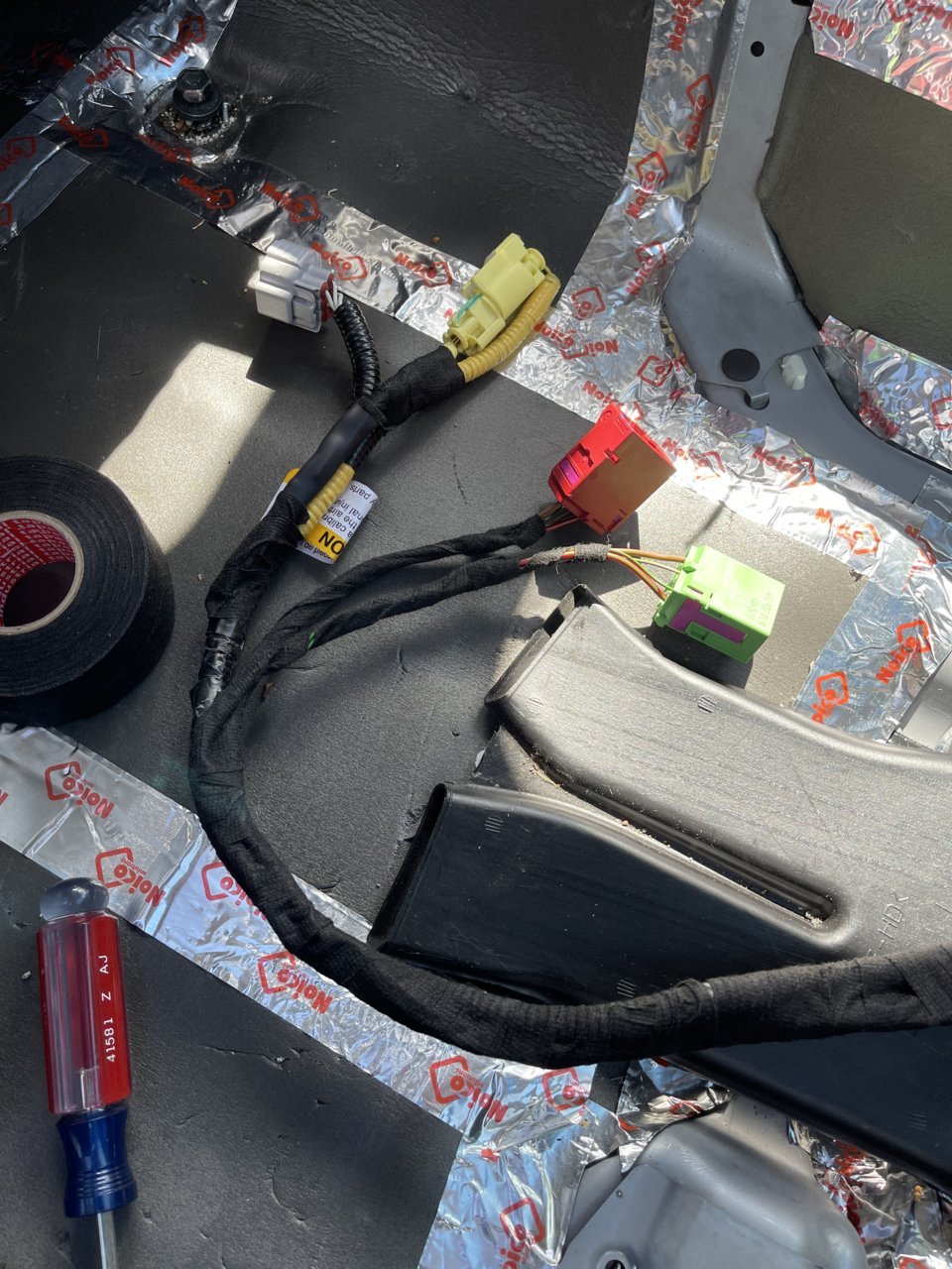

    are they power or manual? If they are manual you just need to get some brackets or make brackets. If they are power you need to identify the power source. Usually its only 2 wires then you get all the power functions.
    these are the seats I added to toss it in the mix. Made a harness so they were plug in play for the male/female sides from the donor vehicle and use aftermarket seat heater controller (retained factory seat heaters in the seats)
    EFA432A9-96C2-469D-AE4E-F8A911D33858.jpg AC08678B-8A88-4923-81AD-D43AEE426FD2.jpg B1773FCE-E0A0-4C15-846A-9F8980F6D544.jpg

    Those turned out nice!
