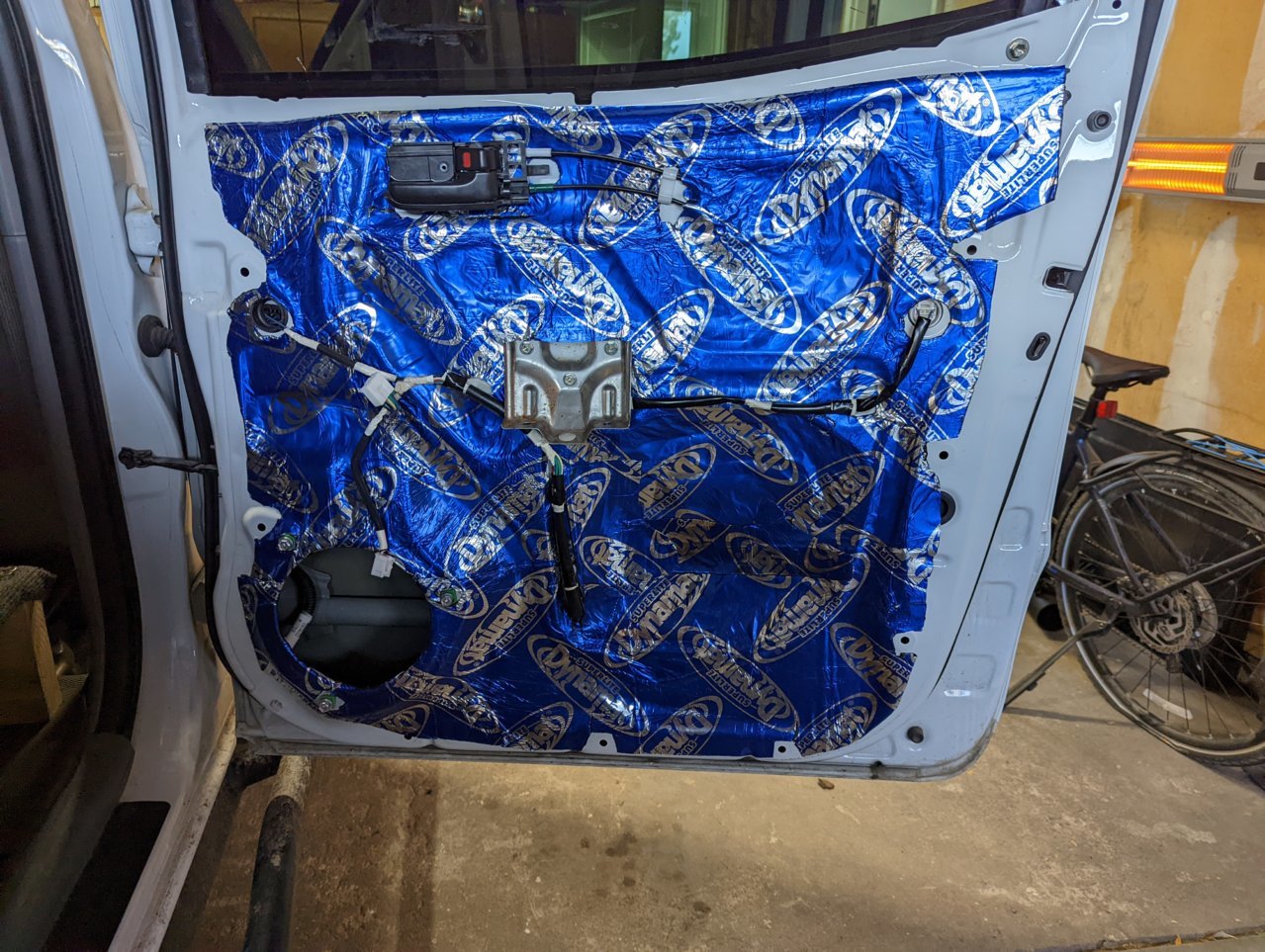

    Last minute upgrades before trip, sound deadening. Joying 9" hu just arrived, and speakers coming next two days

    i went all out on that. i may actually remove some. 5sqft per door is pretty heavy. but quiet. makes a loud exhaust hardly noticeable. looks good brother!

    Thanks. This is the ultra lite version since I had leftovers after using it on the M3. Plan on adding closed cell foam over it at some point in the future

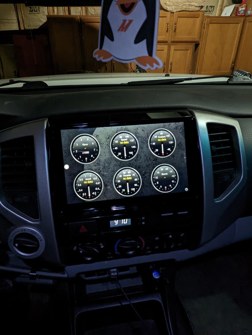

    Got the joying hu installed tho!

    @scootter82, does the Joying give you AFR and transmission temps too?

    That's just the torque app so still limited. But I've seen people do custom pid's in torque to get trans temps. Not sure on afr but I'll mess around and find out

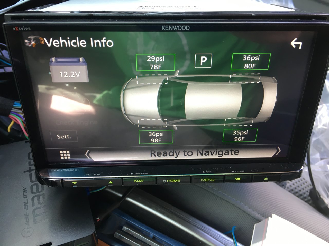

    There's gotta be a way to get that since it's all OBD info.
    With the maestro I was able to get AFR and transmission temps along with tire pressure at each wheel but my stereo install isn't nearly as clean as yours turned out.

    Did you get tire pressure at each wheel using the factory tpms or an aftermarket? I was always told and plus I could not get it to work on the stock ones. I have some aftermarket caps that are okay but sucks taking them on and off. took them of one time off road and never put them back on.

    @nudavinci64, factory tpms sensors with a Kenwood DNX996XR and idatalink maestro rr

    nice super cool I was always under the impression our trucks did not pick up the individual like that or at least have the PSI. I should prob get my TPMS to work again and see. ha Cant be something just with Maestro unless the just figured out how to crack it.

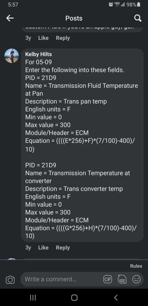

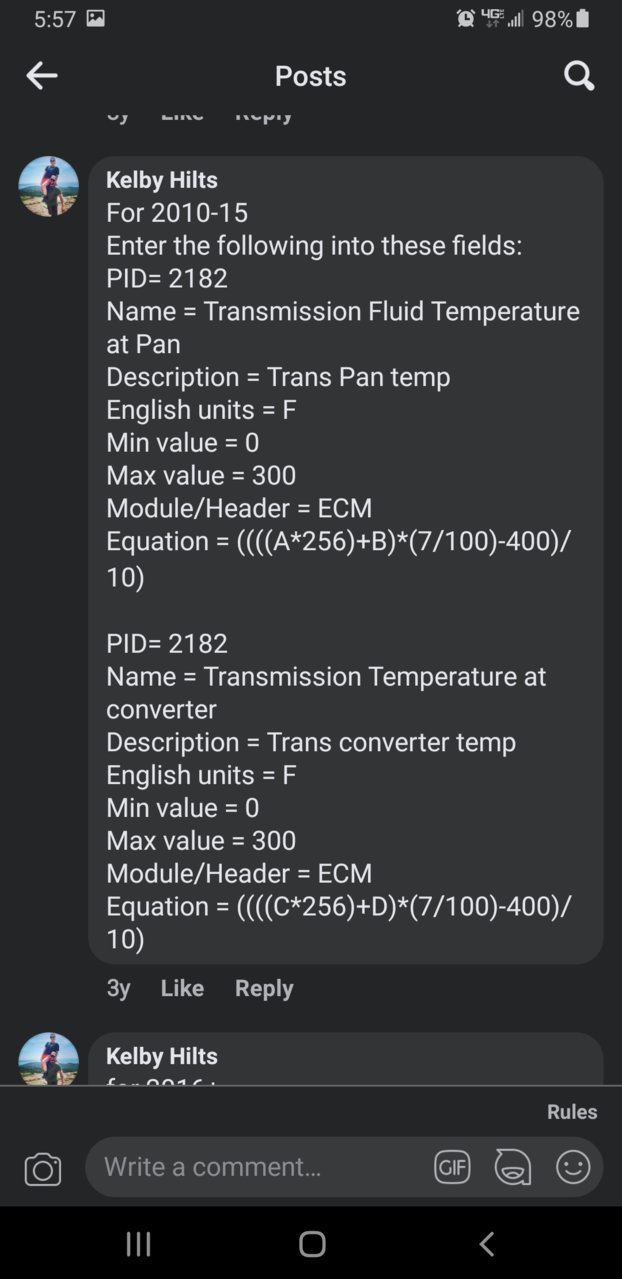

    @scootter82 this should help ya with the torque app and trans temps.
    Screenshot_20211221-055705_Facebook.jpg Screenshot_20211221-055712_Facebook.jpg

    It picks individual up for tpms. You can see it in techstream if you have that.

    Oh hell ya, thanks! Will try and get it working before I leave on trip.
