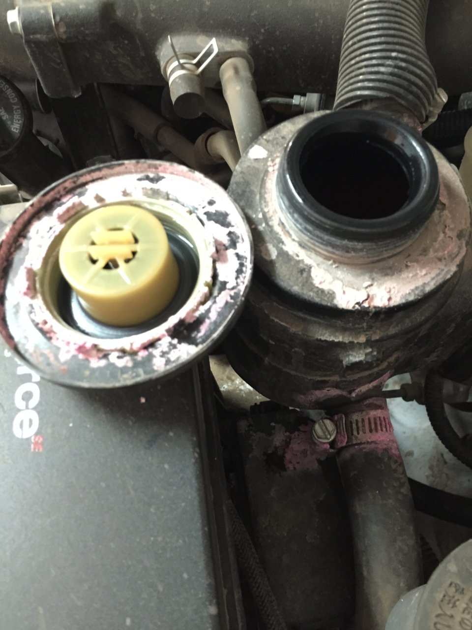

    Oh look! Mines dry and has a level!

    Where is this mysterious stealth level you speak of?

    Looks like you have your just chilling out about the same place I have mine. Because everyone loved the real estate on the fender and other mods used it up first. Mine doesn't look that nasty, but would still love one that didn't leak and wasn't a ton of cash.

    Poor quality. Look at those substandard welds. Better keep an eye on it in case it starts leaking.

    It was about 1.5” below the opening. That’s were I left it some time ago. Actually added a little to it just now. It has its own overflow if that’s too much. Are you guys running 50/50 or straight antifreeze?

    When you said level I thought you were talking about a sight gauge.
    50/50 premixed Asian pink Pentofrost antifreeze. You dont want to run straight, it wont cool as well.

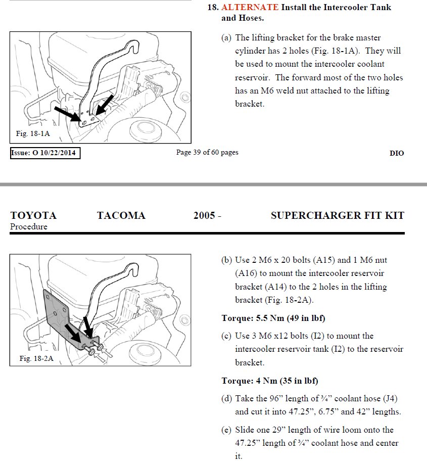

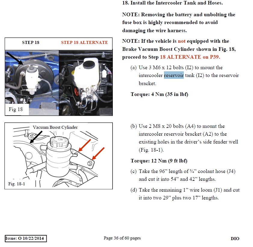

    Going to have to look throught my stuff for that bracket. I have mine on the bracket for the fender and just twisted so it is standing on it as a leg. But I do remember it coming with a couple mounting options. Hmmmm

    Two different options depending on which brake system you have.
