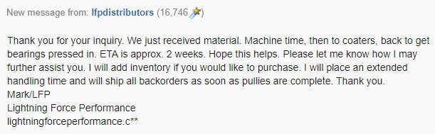

    Good call. They emailed me back right away with an update they're making more pullies. They even threw me a discount for the wait. Can't beat that kinda customer service.

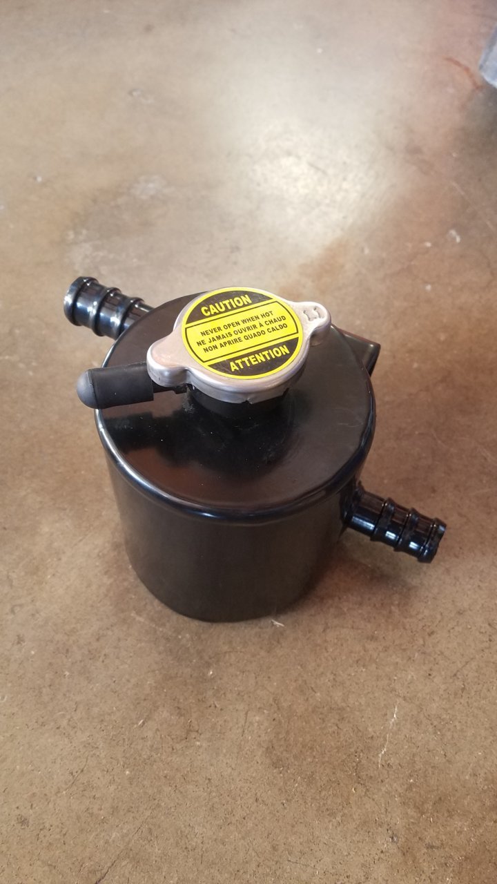

    I'll offer it up here first:
    I've got an OG mightytacoman SC coolant tank. I bought a second one just to have the screw on cap vs the radiator cap. Nothing wrong with it at all. I did have it powder coated black. Asking what I paid $275.

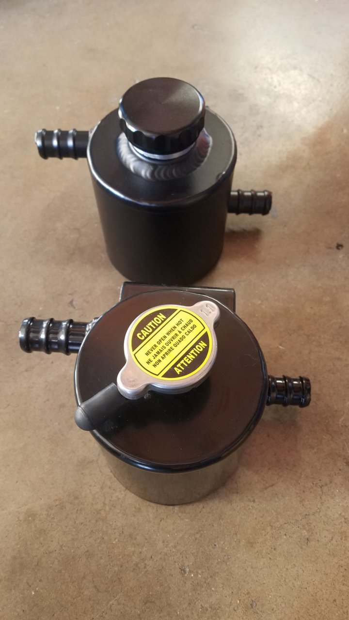

    This is just to compare original vs screw on cap.

    Worth every penny
