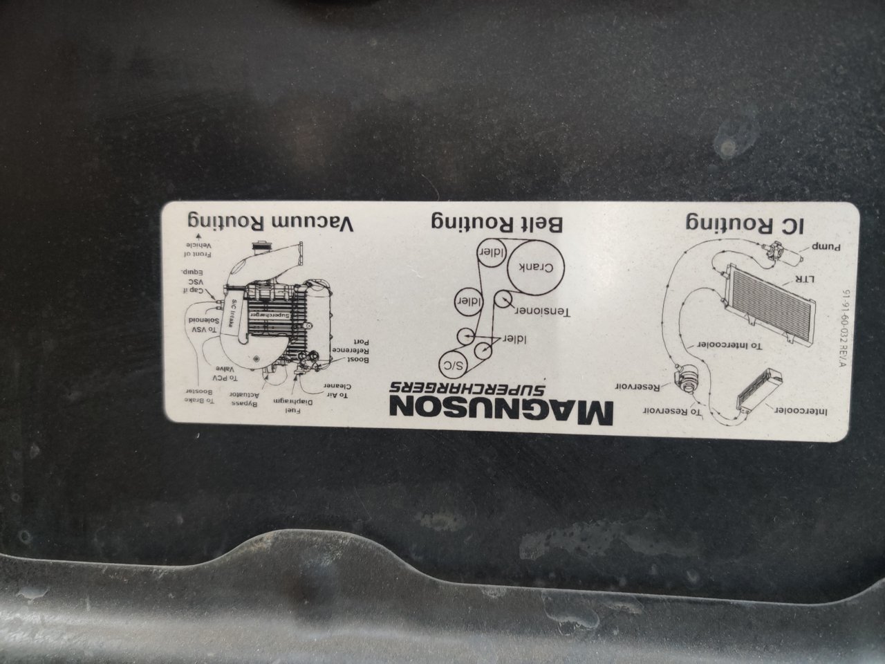

    getting what i think is the mild chirp/ squeal from the idler pulleys. just popped the belt and spun them and they all seem great. should i change them anyway?? checked my output shaft and pinion angles. within .5 degrees. ugh

    do you have to take the tensioner off the bracket to get the bracket free for the lower idler? cant seem to remember the process.

    I just did all my idlers. You need to remove the whole tensioner assembly from the truck (2 nuts) and you can just swap the bearing from there. That’s with the stock tensioner so not sure if the upgraded ones complicate that more or not.

    thanks. its the bracket connected to the alternator and the idler nut that holds the bottom of the bracket right? cant get it to budge.

    im probably doing this wrong. the top bracket nut i believe shares a bolt with the sepentine system. it seems to be backing out and i cant get a slot screwdriver on it and turn it.:annoyed:

    You are going to have to get a stubby screwdriver so you can access it. That's a weird one to have a problem with because by now both of them are mostly corroded in place by now.

    double nut and got it back. bracket off, tensioner off, just lost an impotant bolt in there. fuckin nightmare.

    can someone post a belt route image please. im almost there.

    thanks fellas. im getting old. these basic-ish services wear me out. or its working two jobs.
